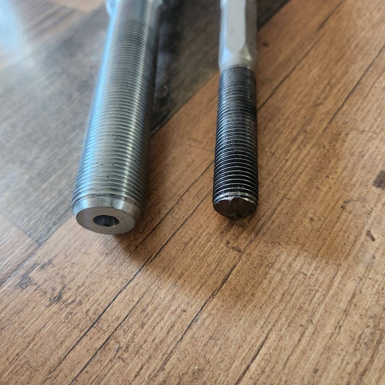

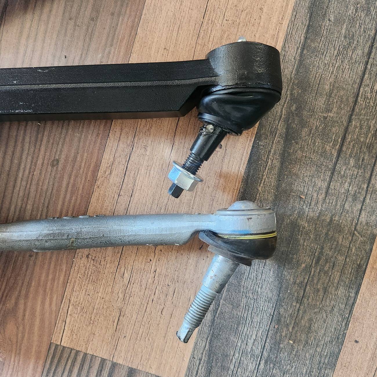

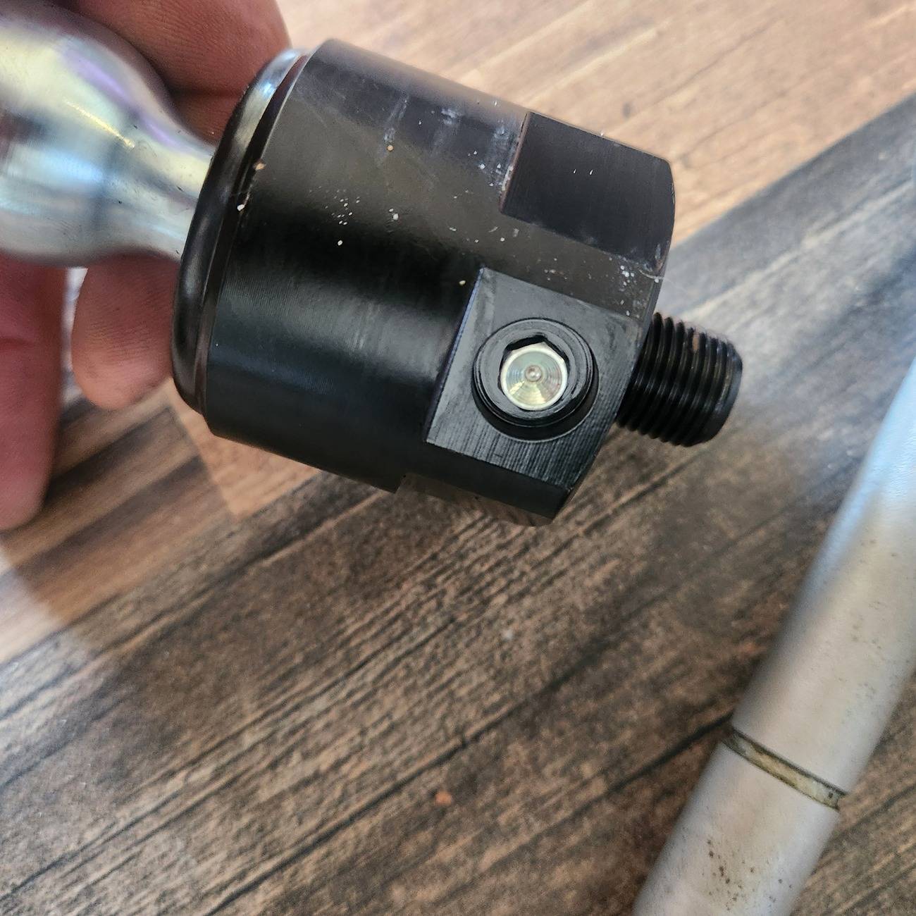

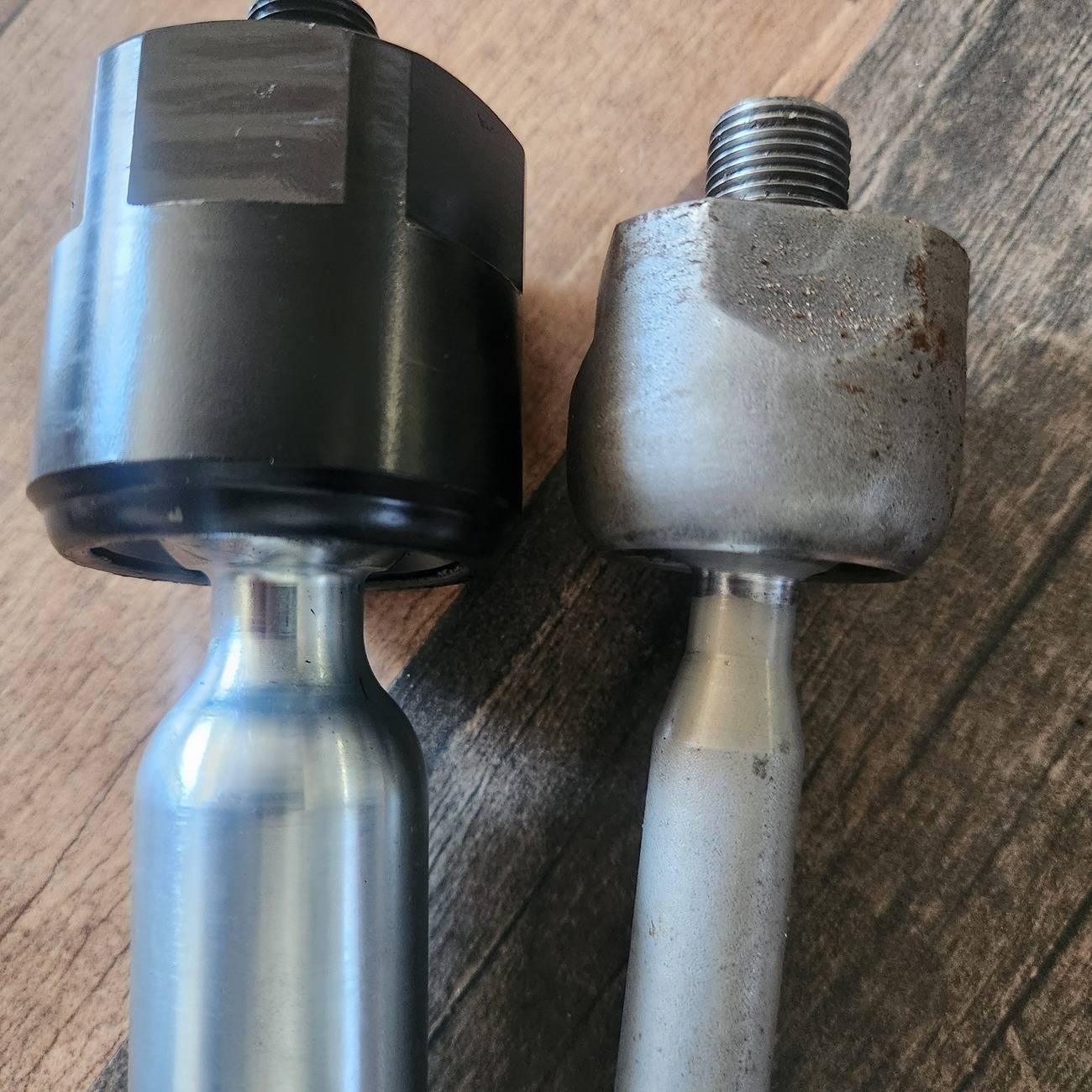

besides the tie rods being weak, the racks were designed for cars, NOT trucks. here are pictures of the "bushings" inside fords rack that get destroyed after only a few thousand miles....Fords engineering department is a joke when it comes to steering.
Ford Ranger Heavy Duty Tie Rods upgrade (Rough Country) vs. OEM Ranger Raptor 20240704_104627

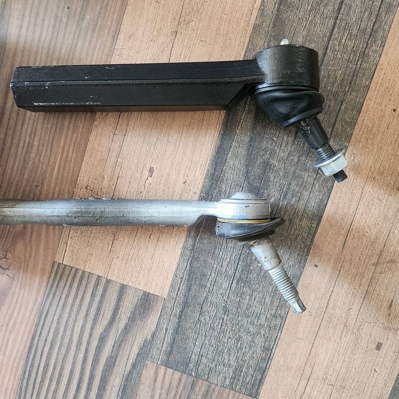

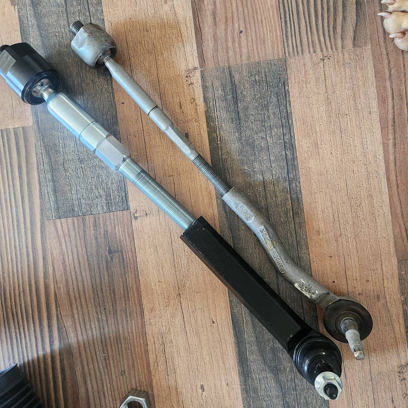

here's the solution to the Bronco and ranger weak rack

I already mentioned that these had an inch and a half more thread than the stock Bronco ones do which is exactly what the ranger raptor is wider than the stock Bronco 1.5 in on each side. I've been running these on my Bronco for a year now with 41 in tires and have had zero issues. EDIT...HAVING PROBLEMS WITH ROUGH COUNTRY PLASTIC CUPS WEARING OUT ON BOTH RANGER RAPTOR ON 35S AND BRONCO ON 41S

Bronco rack is 74weld, so no issues except for the mild "clunk" from excessive pinion tolerance. The RC tie rods are Strong HOWEVER THE PLASTIC CUPS SEEM TO WEAR TOO FAST. The Ranger Raptor has some play that wont go away with more grease. And RC is refusing to warentee another set. Fuck their junk.

Great Find!!! These are definitely superior to RC with the internals being metal instead of plastic!!! I'll be ordering two sets next week, one for RRaptor and one for V8 Bronco on 41s.
