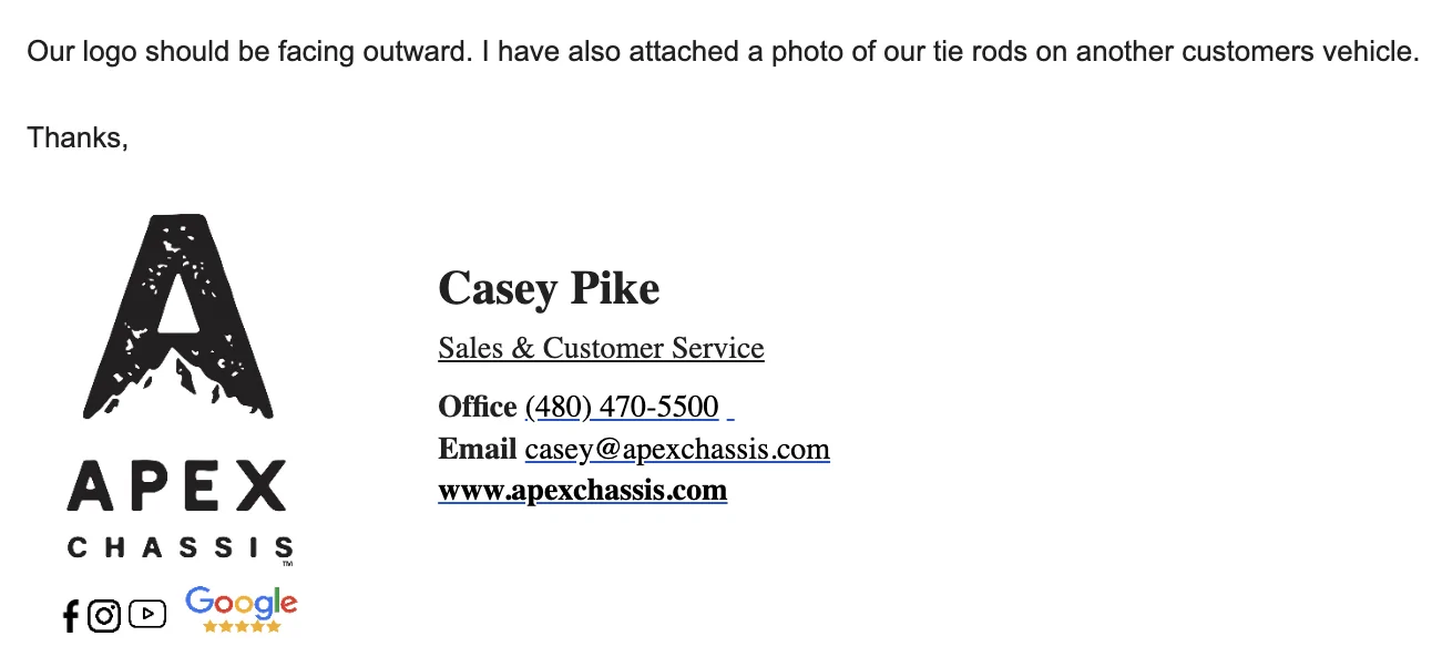

I confirmed with APEX a while back on whether it should be reversed or if the logo should indeed be facing outwards:
Ford Ranger Bent tie rod.. ISO Stock Right Tie Rod Inner + Outer RR 1778260037326-wg
Did you have clip on or stick on weights? Are the apex tie rods just that much more beefy they hit the rim? i also have the rtr +30's and this is giving me pause to upgrade to apex tie rods. kind of disappointing. I'm going to check maybe tomorrow with wheels at full lock how much clearance there is to the stock rods...
Also I live in a snowy, salty climate and want nothing to do with heim joint rods/suspension parts, so the apex seemed great....
**EDIT**
was taking a look at their site again, Did you perhaps install the rods reversed?? they are side specific with a curved section, im assuming for clearance (curved away from the rim?) if you had them on the wrong side, they'd curve forward into the rim? Does that make sense? logo on the rod should be facing forward right side up. Im trying to visualize it without being under my truck. i dunno maybe im wrong. The image they supply below says "top view" but its really a view looking up/ bottom view.
