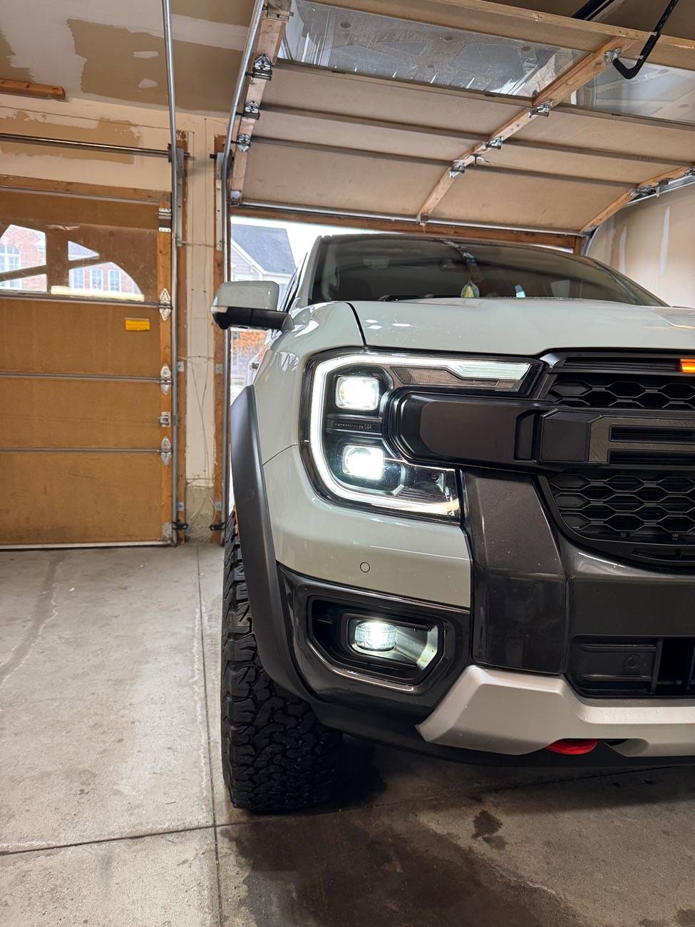

Hello everyone, is it possible to remove stocked air dam (sport 4x4)and install oem metal skid plate MB3Z-5D032-K instead or do I have to install those L and R air dams like (FX4) in order to make the bumper stable?
Yes, you can. I installed the FX4 air dams along with the skid plate but they don't add much stability. The front of the bumper above the skid plate is not supported by anything on stock FX4s so it is a little flimsy even with those air dams.

That’s great, thank you Carbon6G for the info. I wonder what’s there to support the actual Fx4 bumper.
Nothing that you are removing when the air dam comes off. If I remember correctly, the air dam is held on by just a bunch of small fasteners directly on the edge of the bumper and two torx head fasteners that are located at the fender wheel well moulding, right under the marker light. The torx fasteners connect a few pieces together and is where part of the FX4 air dams attaches.

Ok that’s something to notice, I can’t wait for the parts to arrive and put them on. Thanks

If anyone is interested in the FX4 air dams, here are the part numbers. You can reuse most screws that come off the removed air dam. You'll need to source a few extra of similar size for the supports.
Air Dams
N1WZ-17626-BB
N1WZ-17626-CA
Support Brackets
N1WZ-17A861-L
N1WZ-17A861-N
