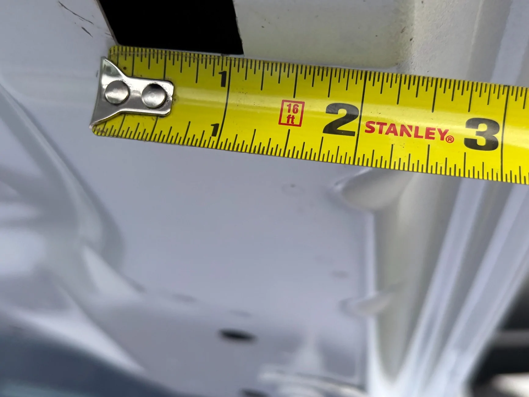

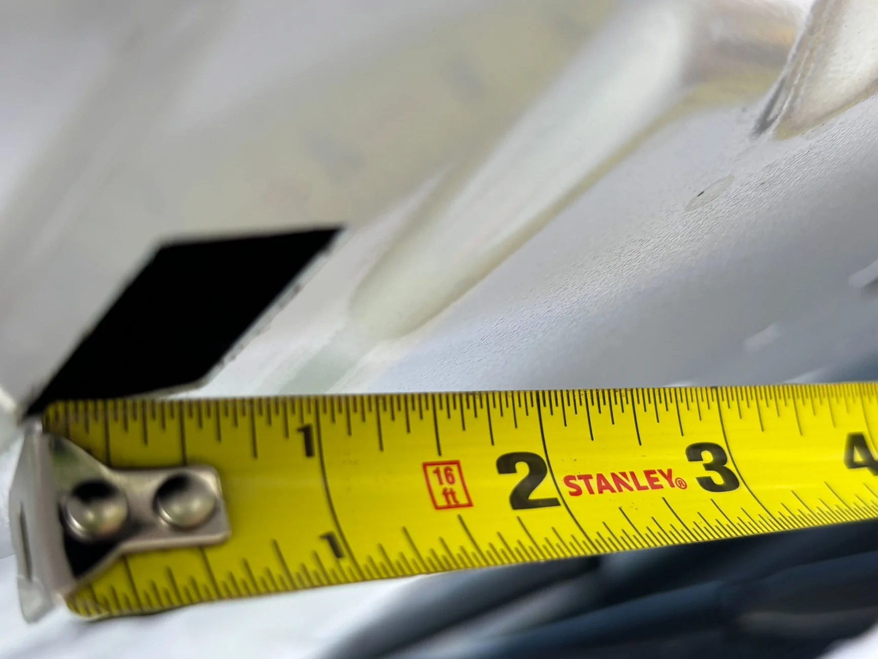

I have a 2026 Ford Ranger XL. I am on the second set of hood struts for this truck. The issue is the nut they come with is slightly less the 3/4 wide. The strut holes in my hood are 1" X 3/4". All the kits say they fit a 2026 Ford Ranger. Did Ford change the size of the strut hole between 2025 and 2026?
Ford Ranger Hole in hood for gas pistons One inch
Ford Ranger Hole in hood for gas pistons Nut is too small
Ford Ranger Hole in hood for gas pistons Three quarters

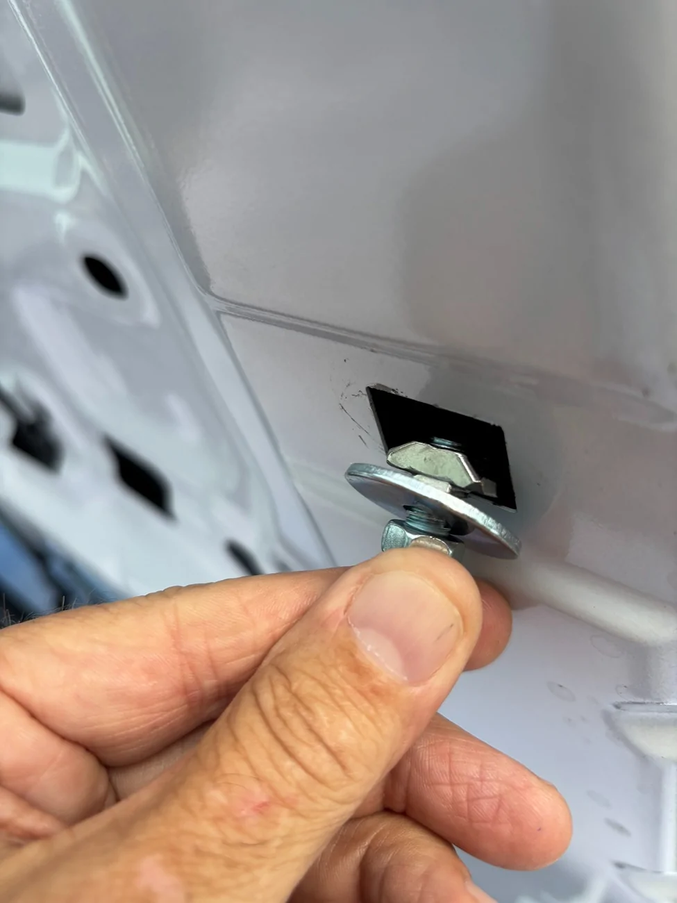

I just installed this kit if it's redline...the two square holes for the nut are opposites, one vertical and one horizontal so to speak. I oriented the nut the same way on both, you're supposed to center it vertically in the horizontal-shaped hole best you can if that makes sense.
EDIT: that doesn't look like the redline kit, different hardware you're holding. Don't think that's the right one.

If I center the nut, it is too small for the rectangle

I have attached a picture of the bottom of my hood (driver's side) and where all the instructions show the piston attachment area is. However the 2 I ordered had nuts that were too small to reach the sides. I was curious if the 2024 & 2025 had smaller holes.
Ford Ranger Hole in hood for gas pistons Gas piston attachment hol

I am communicating with RedLIne but their nuts look like the same size. If you have a 2024 or 2025 Ranger XL, I am curious how large the rectangles in your hood are?
I can't see that they would be different given the kit is for '24+ MY
