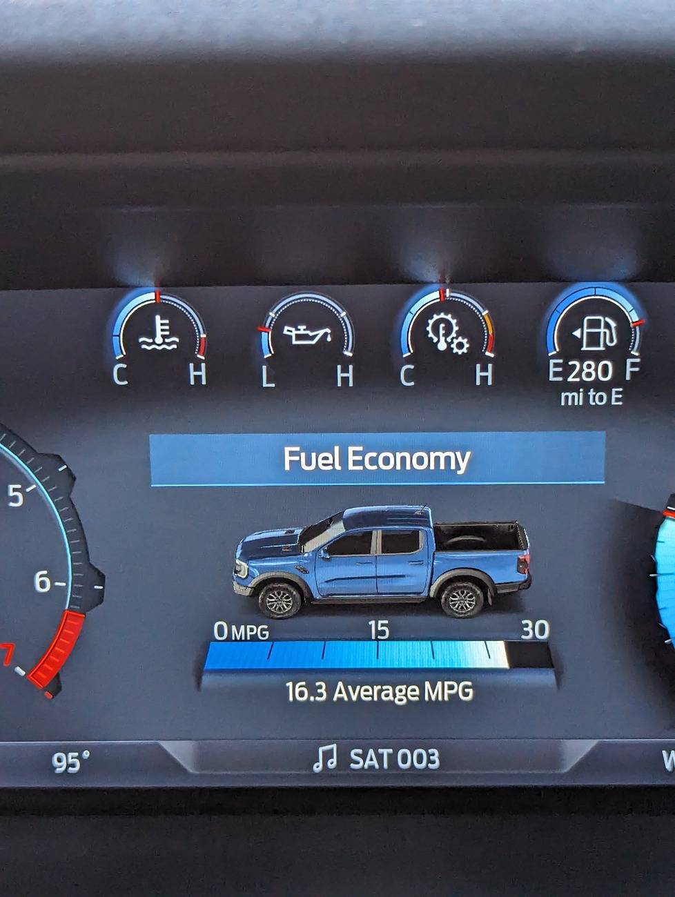

Quick question, what does your oil temp gauge report on your RR? I have the dreaded cam phaser on start up, but just noticed this as well... seems low, lower than the first hash mark, so maybe my issue is not cam phaser but oil pump related? Not enough pressure?
Yeah mine was the same as that. The pressure was super low then raises when you put your foot on the gas.

There is a solenoid that controls oil pressure. It can vary depending on many things.
