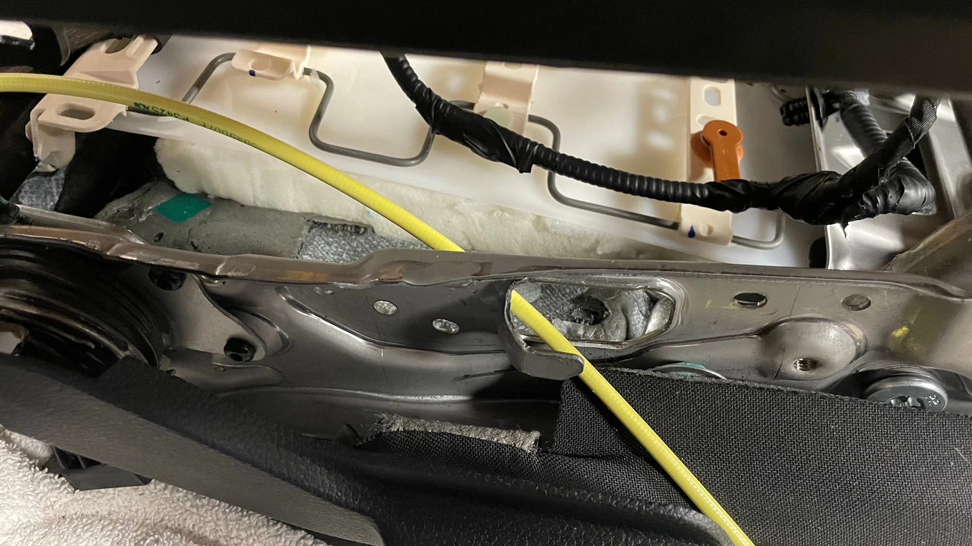

So finished the seat mods, After looking at the components, what i think the cause is is both the Foam is sub -par, and i think the spring bottom is not as robust as it ought to be. So. I added a Nylon 12x12 sheet, and then stack a 1-1/2" of high density foam on top of it. It does cure the hole the lower rear seat becomes, at the expense of some comfort. Later down the road i may try a more recent bottom seat foam from a '26, but with the nylon plate. Also added seat heaters. all in all happy with it.
Ford Ranger How much would aftermarket seats cost? IMG_3990
Ford Ranger How much would aftermarket seats cost? IMG_3992
Ford Ranger How much would aftermarket seats cost? IMG_3991

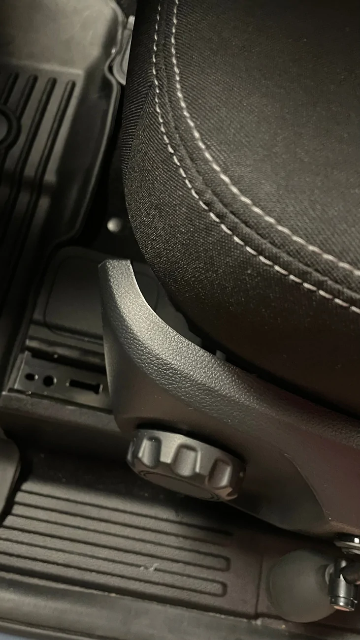

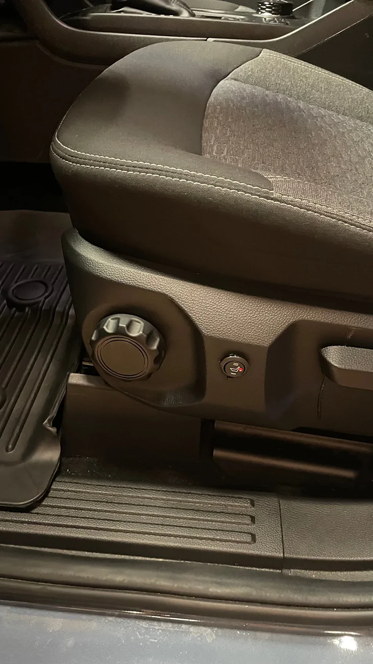

Well, wasn't happy with the extra foam, It was good, but wanted the more bucket feel. Turns out the F-150: 2015-2017 is similar enough to fit, actually is a bit thicker and more robust. The rear of the seat cover internal clip line is off but the sides and front fit. Foam is about 1/2" shorter in front, but oh so supportive. And there are many aftermarket Co's that supply variants of this seat foam. I took a chance on this Dorman Foam because it came in cheap- 57 Bucks. from the amazonian. Free Shipping! Love it.
https://www.amazon.com/dp/B09JJ1SK6T?ref=ppx_yo2ov_dt_b_fed_asin_title
So my recommendation, what I'm using, is 12x12 nylon 1/8" sheet and this foam. Also, if so inclined, a lumbar bag and heaters.
Ford Ranger How much would aftermarket seats cost? IMG_4005
Ford Ranger How much would aftermarket seats cost? IMG_4006

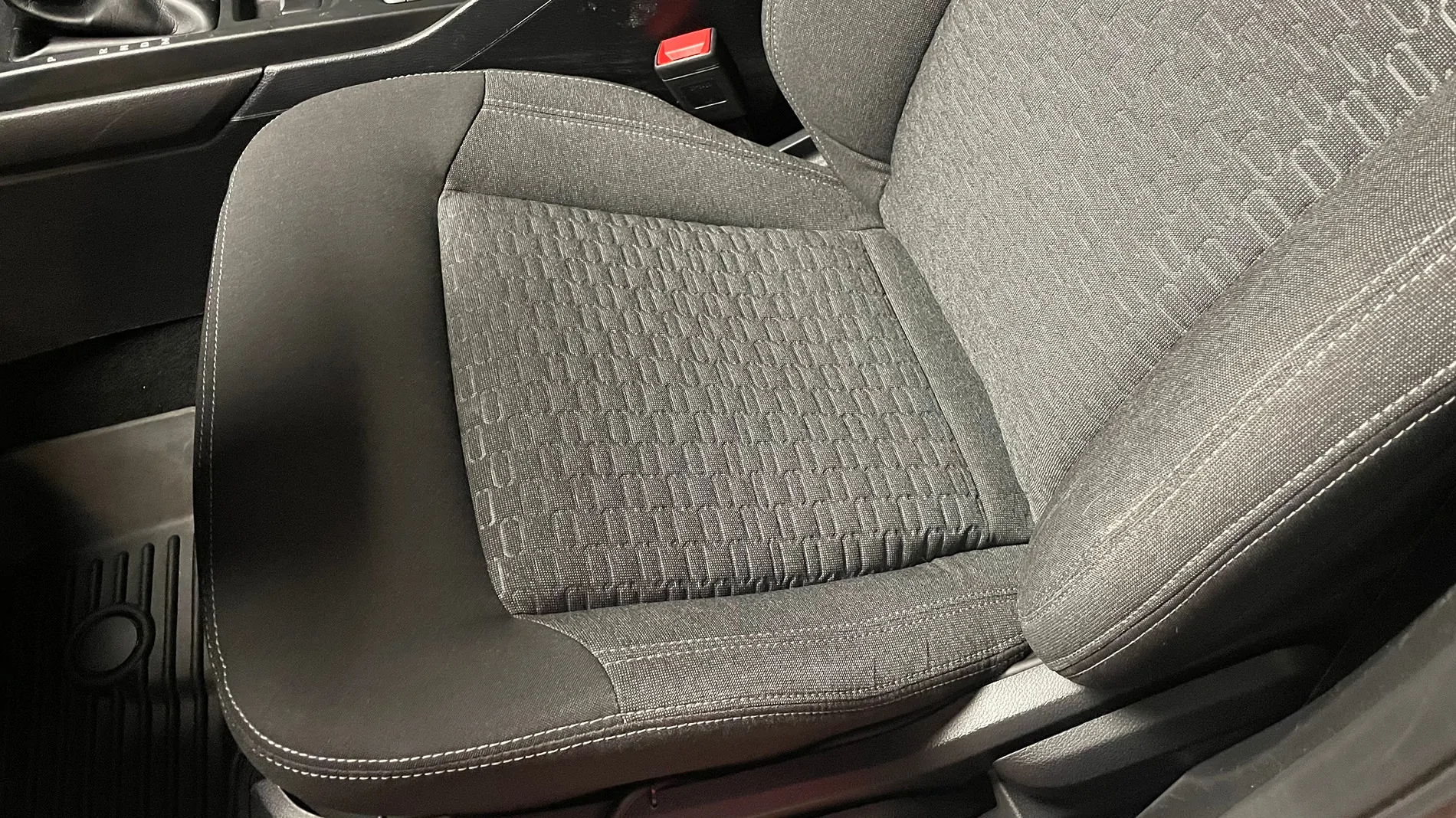

The 1/2" gap
Ford Ranger How much would aftermarket seats cost? IMG_4007
