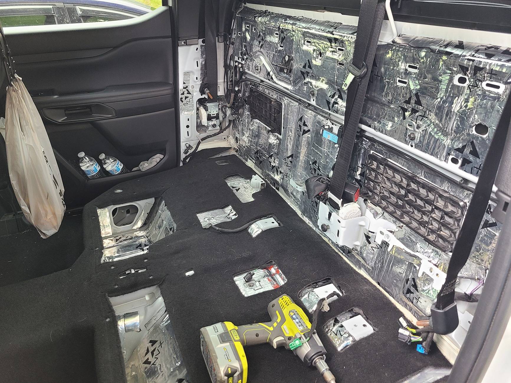

Sound deadening behind rear seats.

What's the noise floor in your Raptor now? I got <49dB at idle, in drive, with the exhaust in quiet mode this afternoon. Ripped to about 80dB at WOT, and around 58dB at 55mph. This was with my phone's mic though, so I need to get a real meter.
KayaPayaPigDog
Kyle
Mar 27, 2024
238
526
US
www.youtube.com
US Navy
Down to 43 at idle but tire noise is killing it up at freeway speeds

Isn't it kind of pointless to do this? The cabin vents are what let all the sound in regardless....
GLW
May 26, 2024
480
538
Missouri
I added sound deadening behind the back seat BUT, I didn’t remove the seat, seat belts or carpet. I just pulled the felt bulkhead cover back and added two layers where I could which was most of the area. So my project was not as comprehensive as what a lot of other folks have done (under the seat etc.) but I was in and out in a couple hours. I did notice an improvement (I think) but nowhere near what deadening the four doors provided. I’m glad I didn’t buy sound material for the back bulkhead but rather used left over material from the doors project. So I was only out my time.
What I wish I had the guts to do is the roof. I just can’t bring myself to try that project. At some point I may take my truck into a sound shop and get a quote for the roof work but I have other things on my list before that project.
in short, if you want a very noticeable improvement, do the doors. Not that hard and worth the time and money.

I did this to my 2021 Ranger. It didn't make any difference. Until I mostly covered up the vents... I know they're for air bad deployment. It made a HUGE difference in sound deadening.
