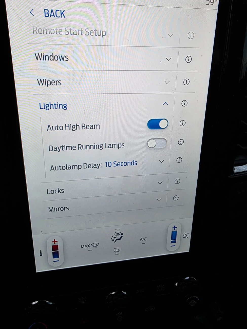

I hate how every time I turn the wheel with the high beams on the inside fog light comes on.
I don't see adaptive lighting under lights on my center screen.
How do I turn it off?

Should be in: Settings - lighting - Adaptive Headlamps on/off
can I just ask why you hate the cornering lights - I find they come in very handy

This is what I have.

You may need to use Forscan to disable if the setting isn't in the menus.

Hmmm - yeah this looks different to what I have... Even the climate controls are different?? Not sure what version of Sync software you're on?
I can turn mine on/off easily under the lighting menu, so not sure what the difference is? For example, I don't have the Daytime Running lamps option, but I do have Adaptive Headlamps ??

You need forscan to turn it off. and its called cornering lights. wont show in the menu. adaptive lighting is for the led projectors, and you need to enable it with forscan in north American rangers to have it show in the lighting menu
