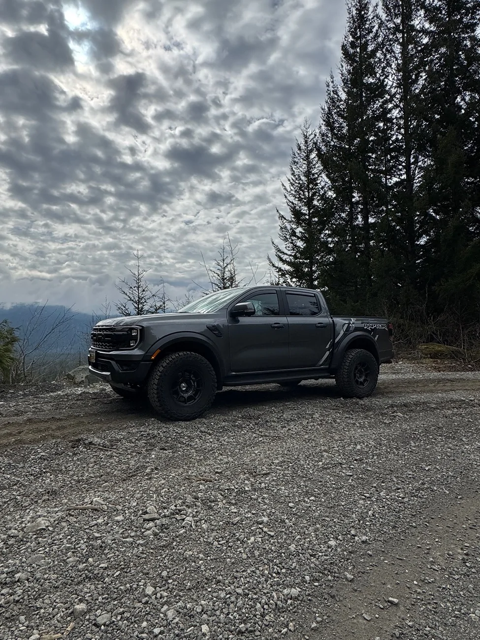

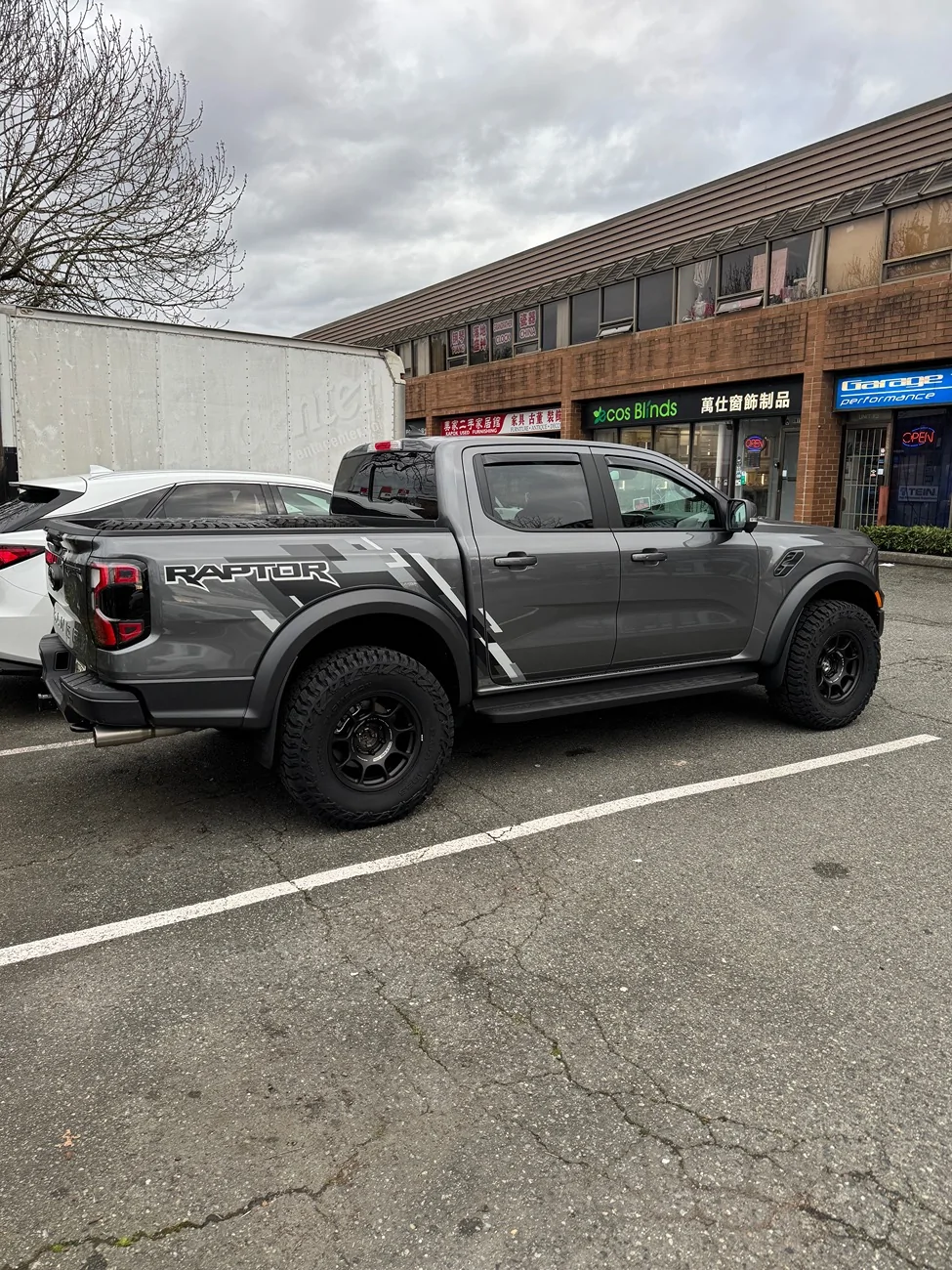

Truck looks awesome. How’s the ride with the set-up?
ToraRaptor
Mar 2, 2026
36
72
Vancouver,BC
2018 Audi S6, soon to be 25 Ranger Raptor
Logistics
Thx Bro. It’s good. Definitely notice the tires weight but I like the feel. Tires aren’t stiff, better in the wet (minimal testing but doesn’t spin on hard acceleration from a stop like the BFG.

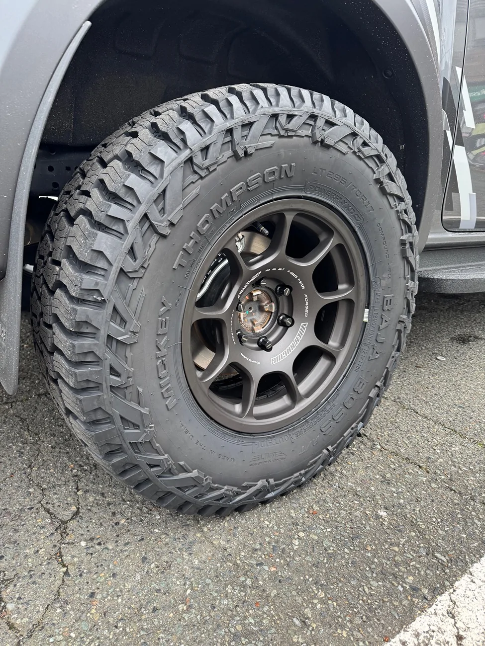

Finally got some highway and off road driving done this weekend. Love the tires, great on the highway with very little hum (up to 130kph). Did some forest service road and one short stretch of some rougher trails (and a bit of mushy snow). Handled all easily. This truck is so much more comfortable off road (and on) than my old Tacoma TRD OffRoad.
