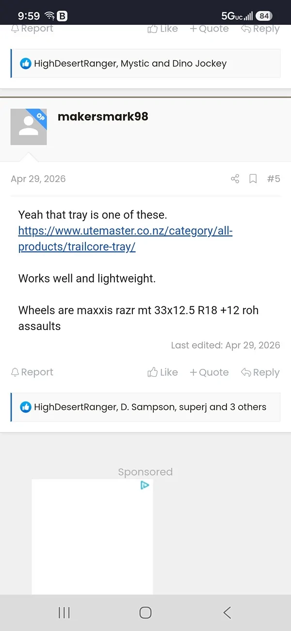

Yah the width gives you the "big tire" look more so than diameter. So a 33x12.5 looks bigger than a 285/75R17 even though its larger diameter than the 33x12.5. Check out the forum from the aussie guy with a custom fabed bumper. He ahd 33x12.5s on his raptor showing the custom bumper and parked it next to a stock RR and the 33x12.5s looked huge compared to the stock KO3s despite being a measly 0.2 in bigger diameter. Its the width.
https://www.ranger6g.com/forum/threads/custom-aluminium-bumper.29107/
Look at the pics, would you believe those are both 33" tires?

Is that linked post's tire the Pirelli's XTM AT on stock size 285/70/17? Holy cow.
No. Those are Maxxis Razr MTs. They are 33x12.5, and thats next to a stock RR with 285/70R17s. There's literally only 0.2" difference in diameter.
The "big tire look" on that truck is coming entirely from the additional tire width and the added wheel offset. The high clearance bumper and front level probably adds to it, but most of the big tire look is from the tread width and wheel offset.
