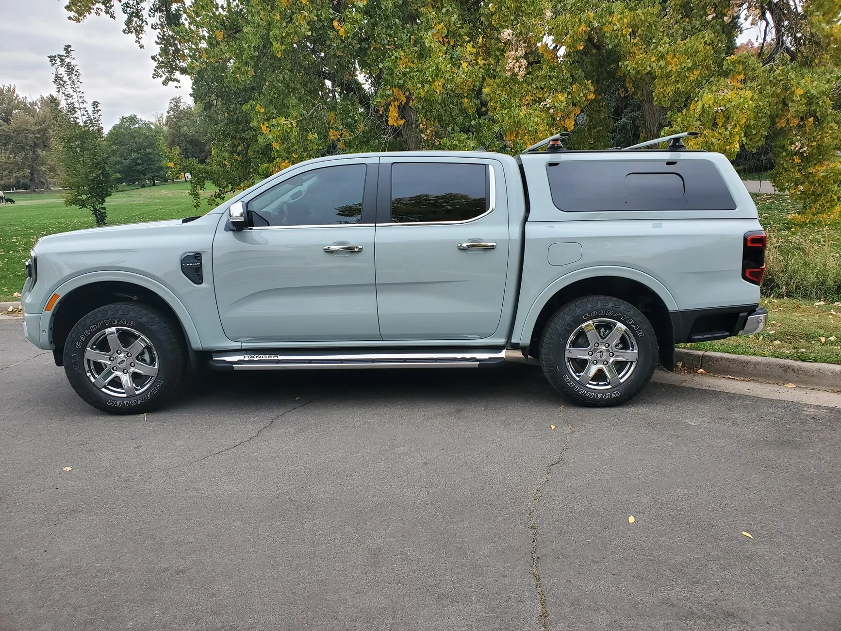

I have the ARE Revo and it has been a good experience for me.
I'm with Arsenall11 that no cap is 100% as the truck bed is not completely sealed.
Must install a tailgate seal (not perfect due to large gap) and a seal for the topper.
Did have a factory problem. One of the windows broke free and let in water. Had to go back to ARE for warranty service, unit came back and the dealer found that water was coming in from both windows. Came to be that the computerized sealant was not 100% covering where the window was installed/manufactured, leaving a 2" sealant gap. I guess I got to help in the quality control department for ARE.
While a PIA to have to send back again. the dealer (suburban topper/Denver), ARE and Real Truck did me solid for repairs. Nice of the dealer to give me a loaner from the start.
Again, very happy with the topper. I carry samples for work, and all is dry and safe.
