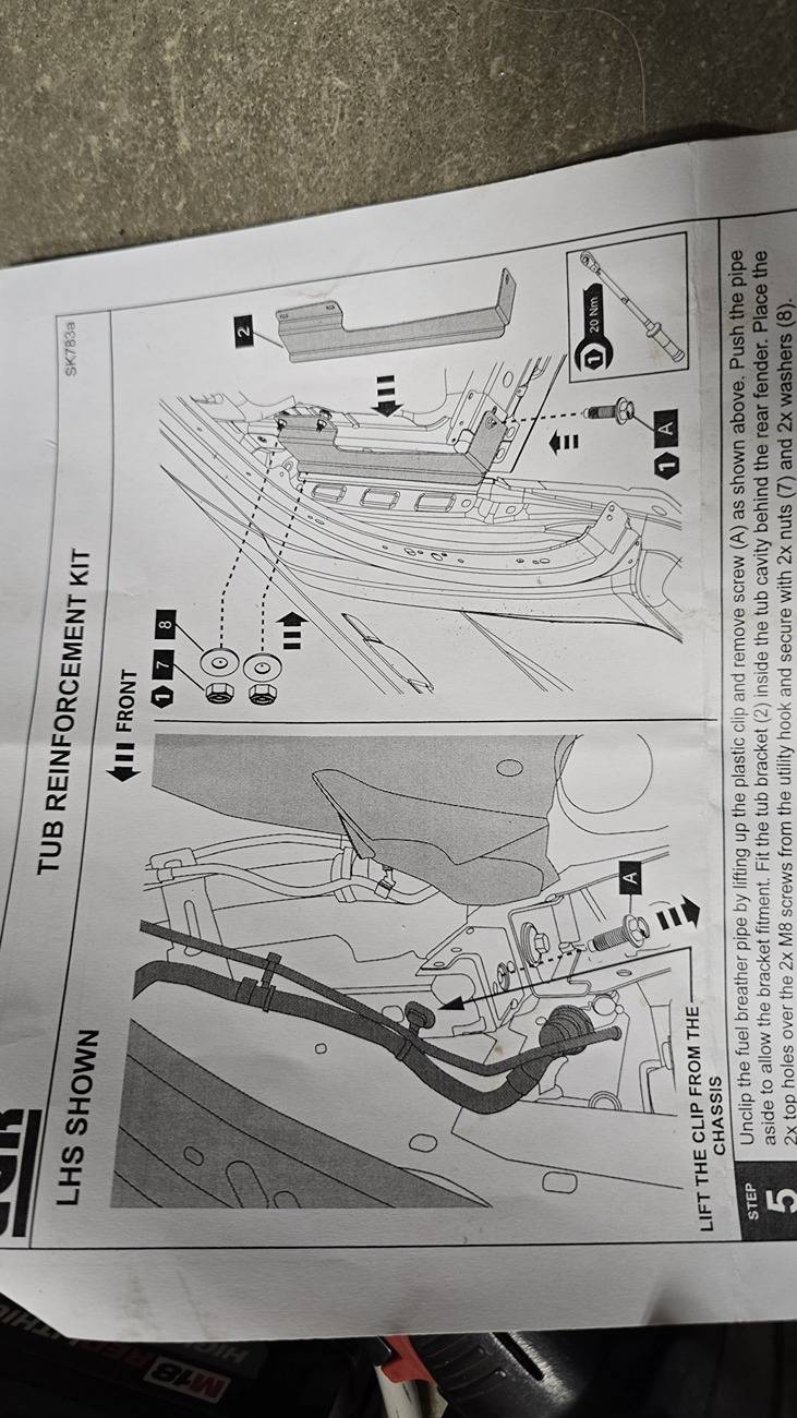

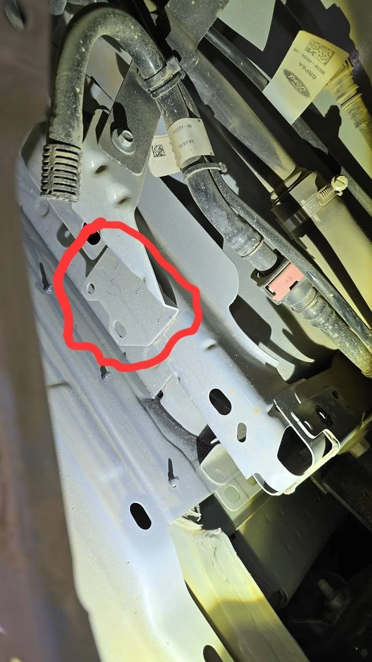

ok got some egr braces from my local supplier. The instructions differ slightly from what I'm seeing on the driver side bracket for the fuel hose. See attached. The red circled bracket won't let the brace sit flush against the bed structure. I don't think it matters? It still sits against where the bolts are fine.
Tried calling egr, no answer.
