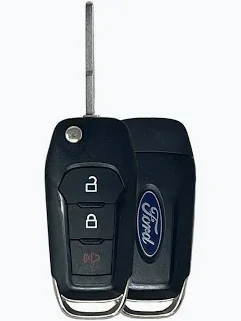

Hey guys. Saw a few discussions on here with similar issues, but none were updated with any fix or resolution.
Bought my 2026 Ranger XLT about 6 weeks ago. It has the switchblade key/remote. On Sep 6, I went to unlock the truck and nothing happened. Walked closer, still nothing. Tried to lock and get it to honk, nothing. Opened the Ford app and unlocked with that, and it unlocked fine. Immediately after, my key fob worked again like normal. Would lock, unlock, remote start.
Yesterday, just 16 days later, it did it again! This time I manually unlocked the truck with the key. Before even stepping in, I tried the remote and again, it worked perfectly normal.
The first time I thought it was a fluke, but now it happening twice in just a few weeks span has me thinking something is up. I don't think it's the remote battery as it works fine once I seem to "wake up" the truck. I'm also thinking it isn't my truck's battery as it starts up, cranks, and runs perfectly fine and normally otherwise.
Anyone dealt with this? Rather not have to deal with the dealer until I have to. Thanks all

So my key is old school - it's the switchblade with an actual key, so there isn't any sensing, or push to start or any of that tech. I also checked the coin battery and it's good to go. Definitely not a battery issue in the key as it always works perfectly after doing something to the truck not the key.

That's my understanding! I don't have any of that, so this should act just like any remote key from the last 20 years or so
