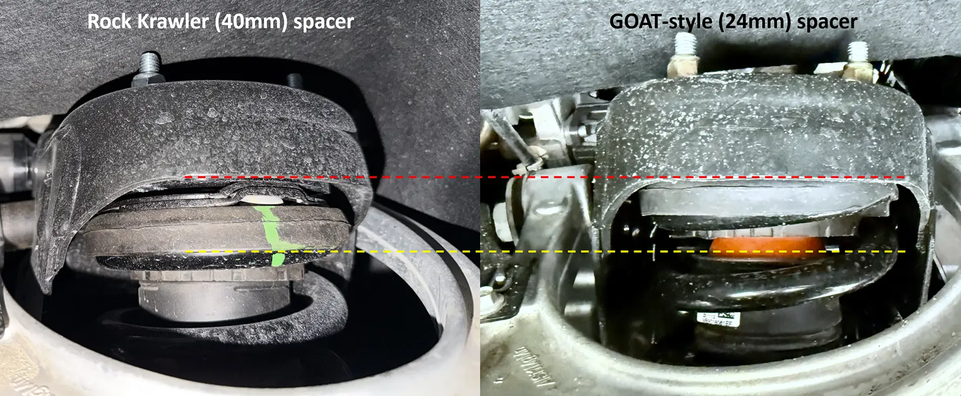

I'm still perplexed at how you "only" got 1.5" of lift out of those RK spacers. Do you have additional weight in the front from skids or anything like that? My hub-to-fender was about 23" stock on the passenger side (with a little over 1/2 a tank).
When I compare your strut topper photo to mine (attempting to scale about the same) it is clear that your spacers are significantly taller

I dont have anything heavy up front or anything like that, but I dont have an answer either. 23" stock sounds high though, the post I linked to he said 23â…› after lift. I didnt measure mine before.
