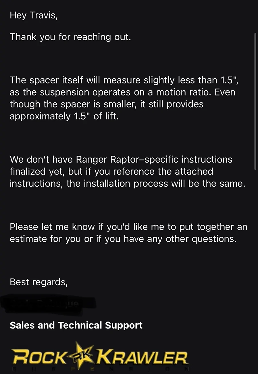

Looks excellent, thanks for sharing! I just reached out to Rock Krawler about whether the 1.5” refers to the spacer thickness or the lift height. I’m guessing it’s supposed to be lift height as my truck has a little over 3” rake from the factory.

Per my email conversation with Rock Krawler: "The spacer itself will measure slightly less than 1.5", as the suspension operates on a motion ratio. Even though the spacer is smaller, it still provides approximately 1.5" of lift."

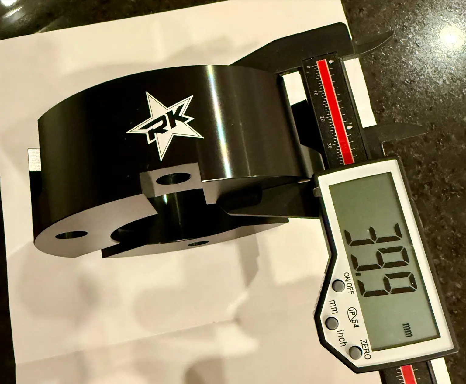

Well I don't know if Rock Krawler sent me the wrong spacers or what, but these things are DEFINITELY going to give more than 1.5" of lift because they are more than 1.5" thick!
(39.9mm = 1.57")
Ford Ranger KMC IMS Wheels + Rock Krawler 1.5" Front Level on 2025 Ranger Raptor rock_krawler_spacer_measurement
If I go by the G.O.A.T "table" from their thread, this would give me a full 3" of lift. Way more than I want or need.
Guess I'll be calling RK in the morning
(39.9mm = 1.57")
They’ve been very slow to respond since I started asking more complicated questions about the suspensions geometry, rotating the spring and top hat, and UCA/coil spring interference at droop.

The response I got from Rock Krawler did not inspire confidence. They are insistent that these spacers will only provide 1.5" of lift, which contradicts everything that G.O.A.T. and Cameron Quinn state in their blog and videos.

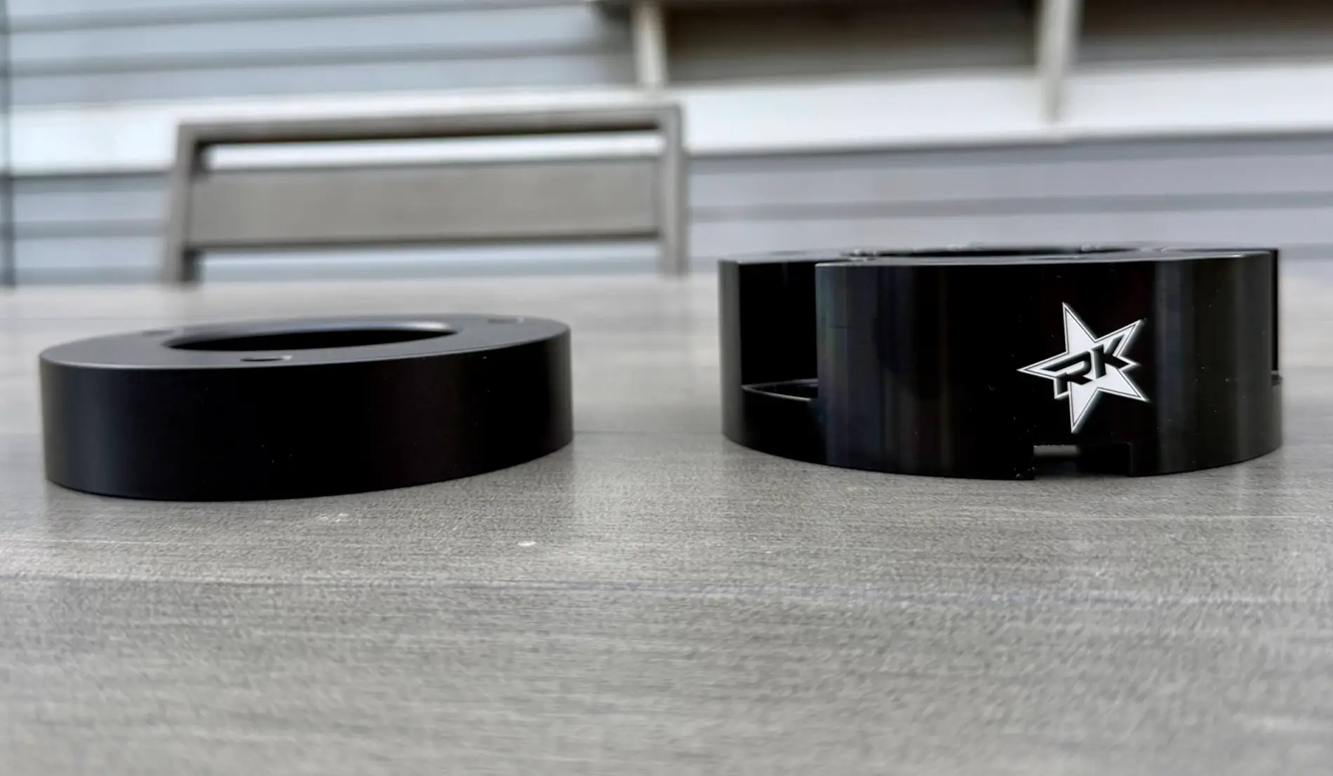

OK, last hijack of this thread... promise!
I ended up ordering those Amazon ones that @yoopercharged posted above. They actually seem pretty decent, with nice machining and finish. The hardware is at least marked 10.9
These are 25mm thick and advertise 1.5" of lift, which jives with everything I've read/watched. Still highly skeptical that the RK spacers are correct.

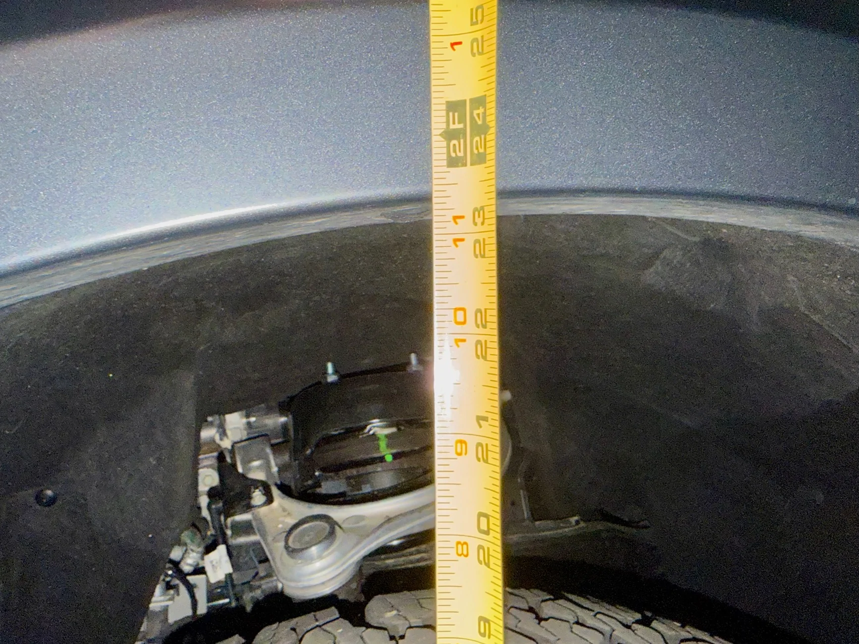

The lift question has been on my mind so FWIW, according to this post with the GOAT 1.5” spacers up front he ended up with ~23⅛”
So currently the truck is sitting at approx 23-1/8" up front and 25-1/8" in the rear. (bottom of fender to center of wheel)
I just measured mine and got almost exactly the same:
