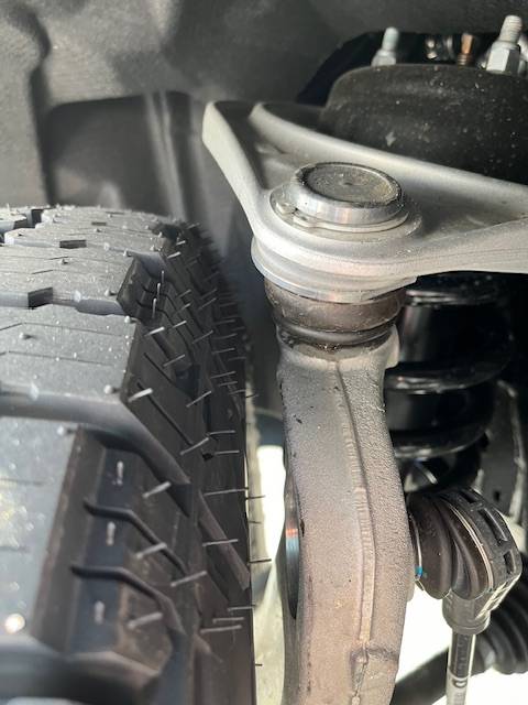

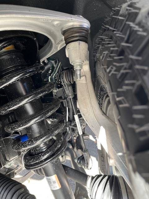

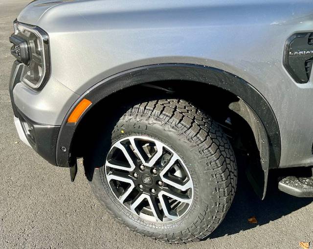

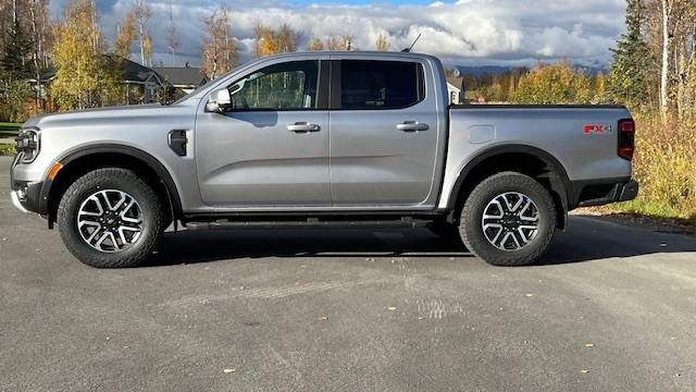

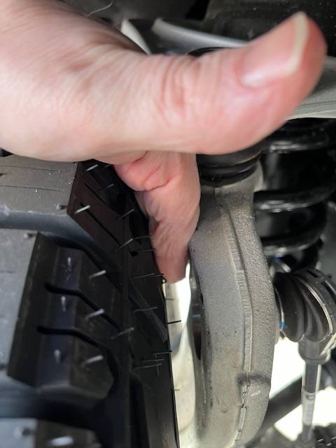

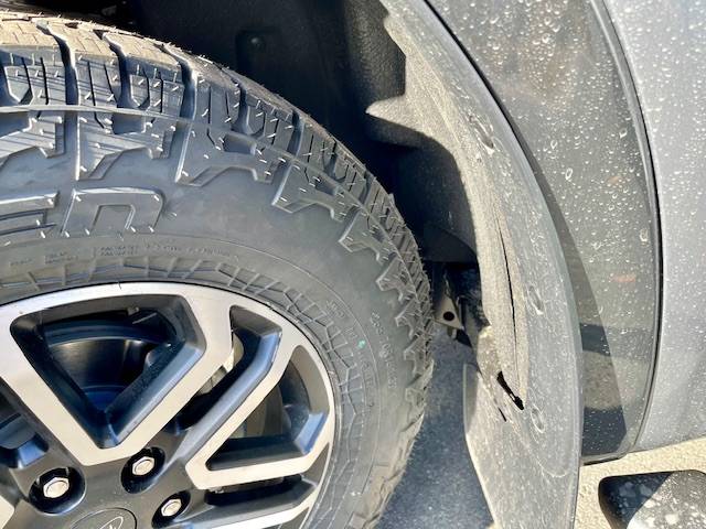

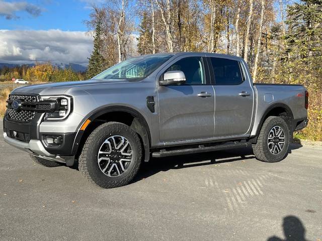

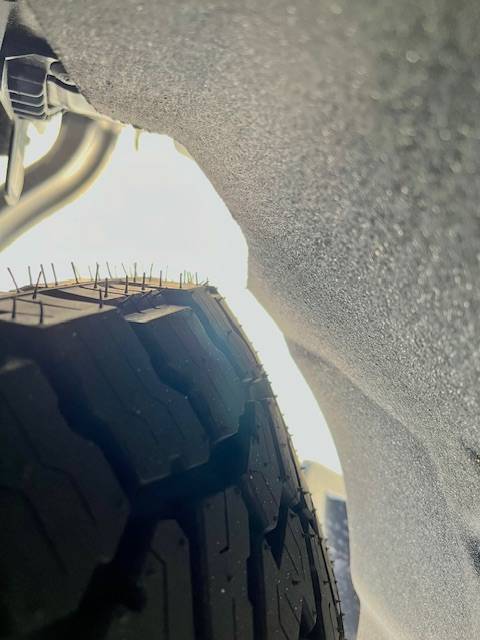

Yes Sir! I picked the truck up last night and had the 255/70r18 Falken Wildpeak A/T4W’s mounted this morning. I think it looks great! It’s a tight fit, but no rubbing. It’s hard to tell, but there is one pic from the top-front-inside looking down.
Can you confirm? ... Those tires ARE on the stock 18" wheels and there's no lift kit of any type? Thanks.
I'm not interested in a front lift because a significant percentage of my use is towing. Accommodation of loads is, to my understanding, why stock pickups typically are higher in the back.
Alaska Steve
Sep 17, 2024
169
166
Alaska
2024 Ranger Lariat FX4
Correct, my truck has the FX4 package and currently no leveling or lift kit of any kind. I have roughly 2,100 miles on these tires and have not had any rubbing. You can see from the pictures that they are on stock rims and there is no top-hat spacer.

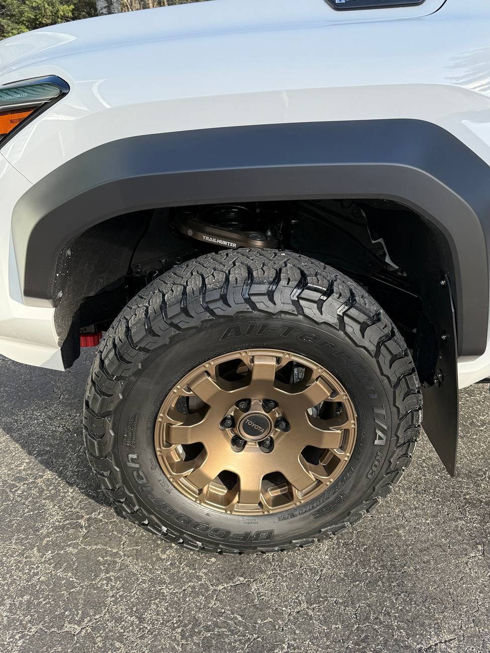

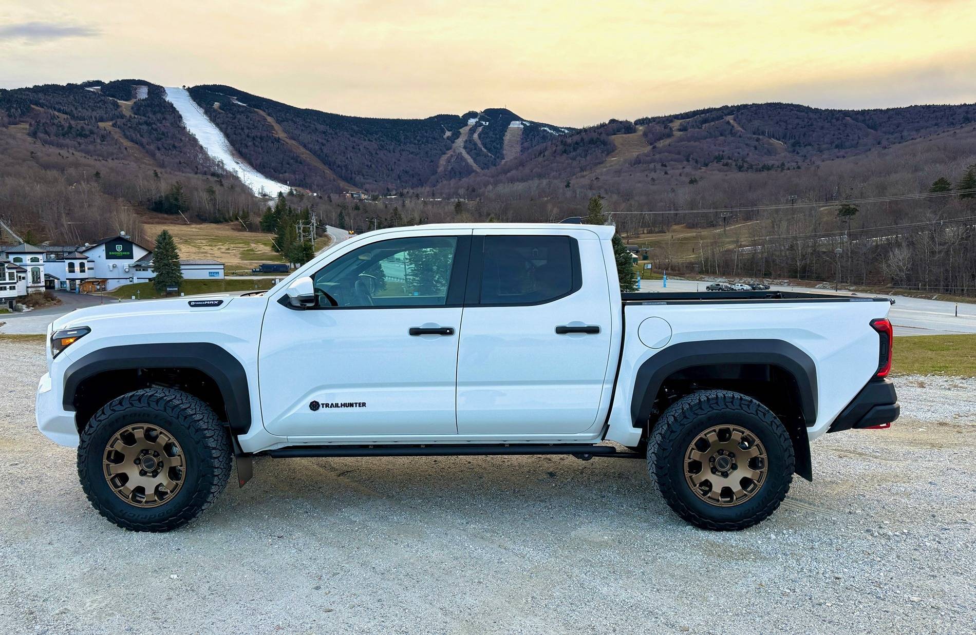

The Tacoma guys are swapping their 265/70r18's for 275/70r18's. To me it looks right in plenty of sidewall and gives you a 33.2" tire. Should fit within the crashbars so long as you don't go with too much poke, probably you want +35, hoping +40 will work. Its also a common affordable size tire.
PS: 265/70R18 = 32.6" and excuse the Tacoma picture
