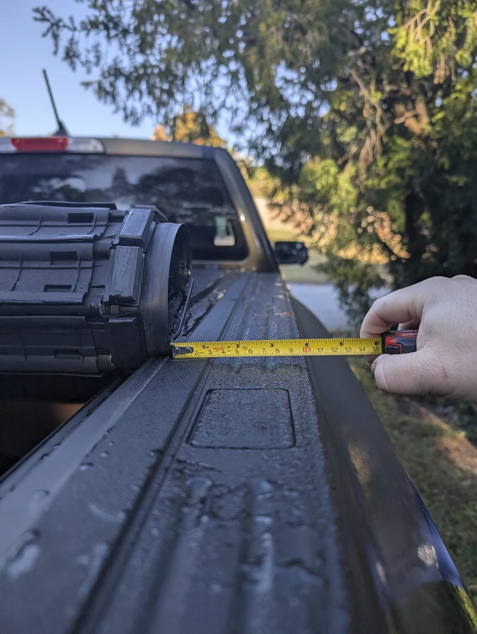

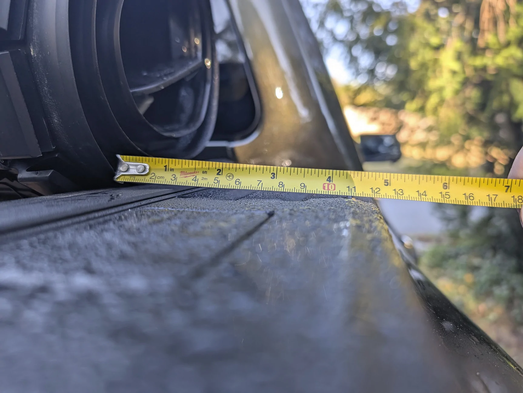

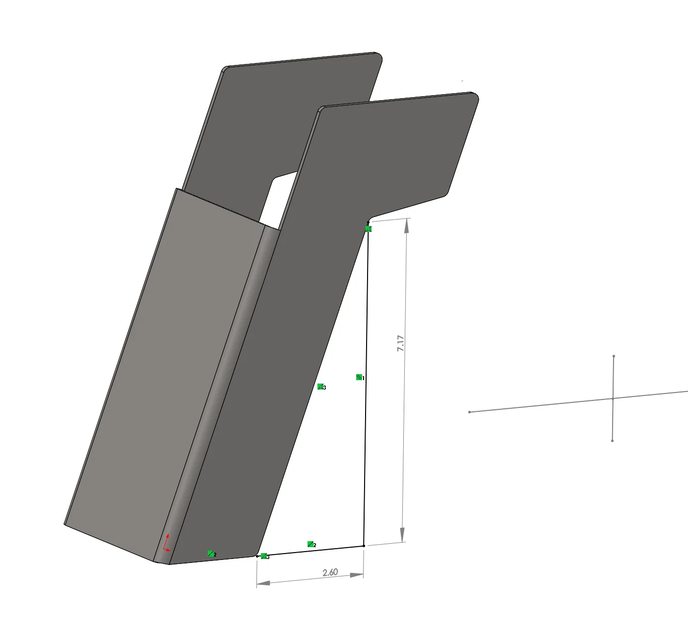

@clarke would you mind checking a measurement for me when you get a minute? I'm concerned about the lean of the "uprights" encroaching on the rolled cover when it's fully rolled up against the back of the cab. I don't want to make the rack any taller than necessary, so it should be a little tight, but it needs to be comfortable when rolling up the cover.
Do these measurements work? Keep in mind that the bottom measurement on my diagram below can be taken from the inside edge of the plastic "stake pocket" cap, as the uprights go right to the edge of that cap.
I can definitely stand the uprights up more, but this angle matches the cab and looks great. From an aesthetics standpoint, I would like this to work.
Please let me know if that makes sense. If not, I can do some more diagrams.
Thanks for your help with this!
I'm at a karaoke bar right now, but when I get home in a few hours I'll roll it up and see how the measurements work. Where on the side rail would I align the part of the drawing designated as angle 3 at the base of the upright?
Definitely sounds like more fun than what I'm doing right now!
I wouldn't worry so much about the angle. If you could just roll the cover all the way up to the window, I think you could get the straight line measurements from that. Basically, what I want to be able to do is make sure the roll doesn't impact those rails. If you measure in and up from the inside edge of the stake pocket caps, that should give you the two measurements I have in the drawing. Hopefully the roll is more "inset" and "shorter" than the measurements I have in the diagram. If not, I can adjust the model to make it fit.

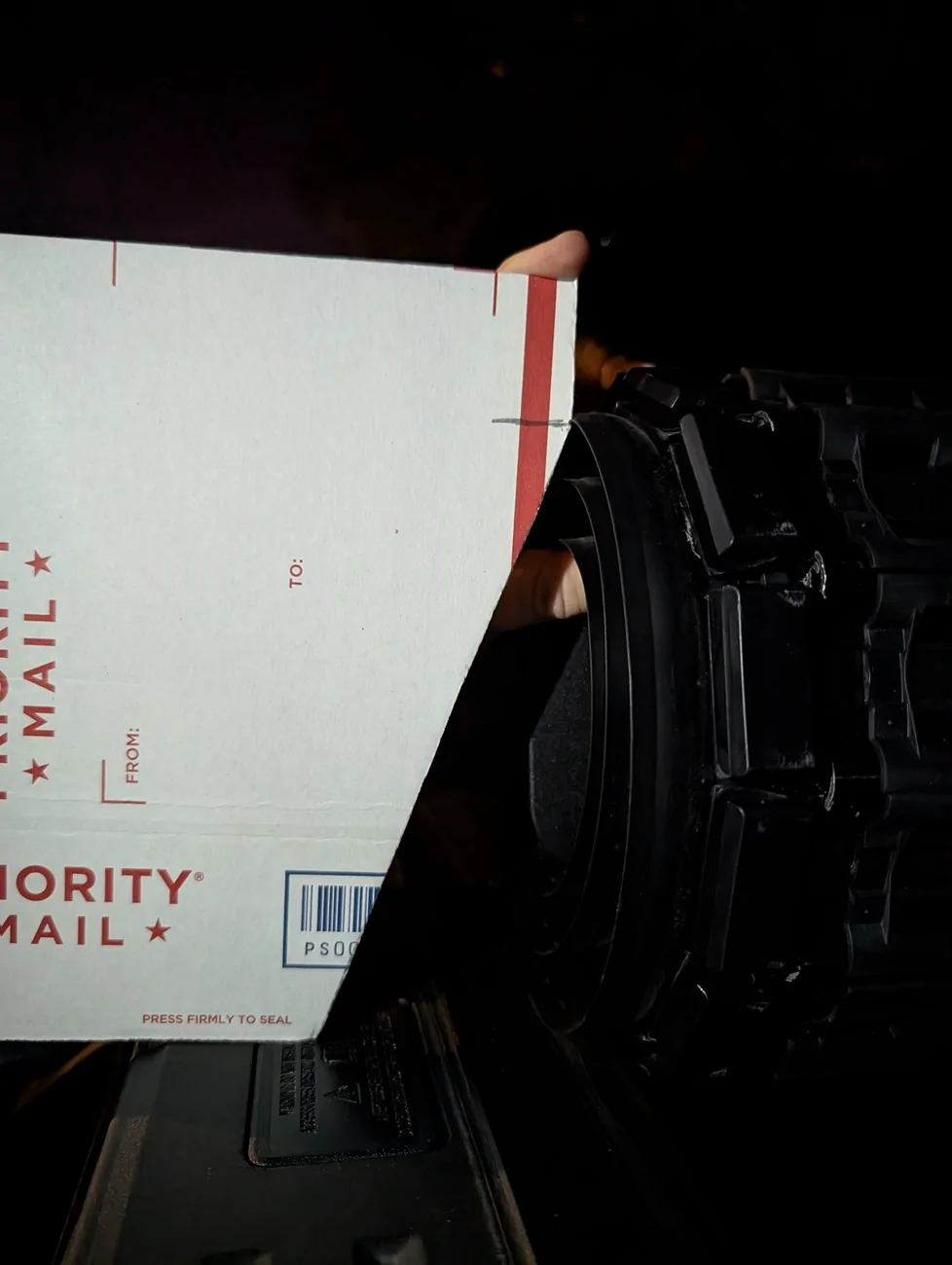

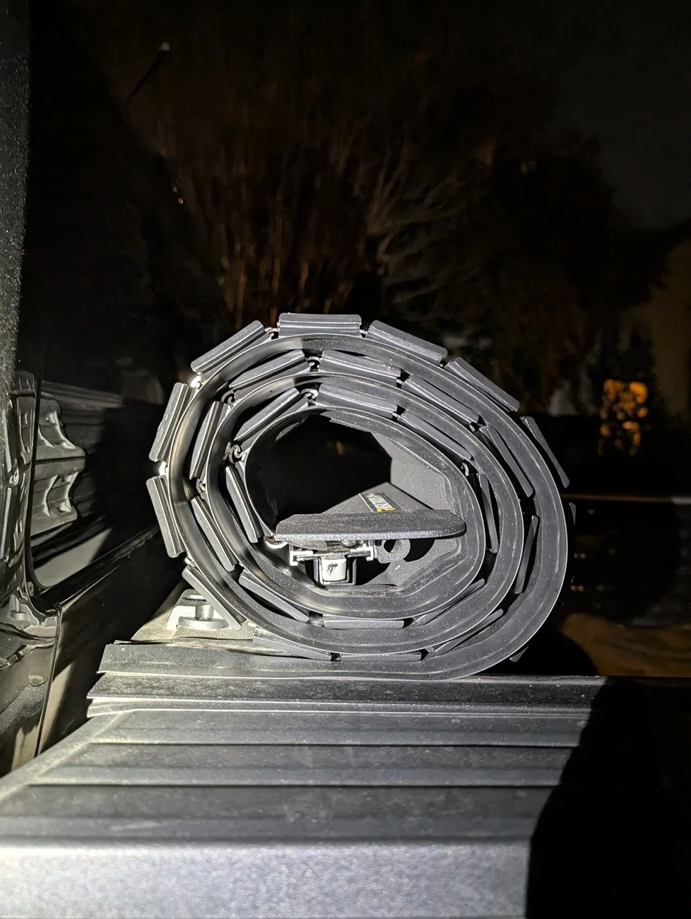

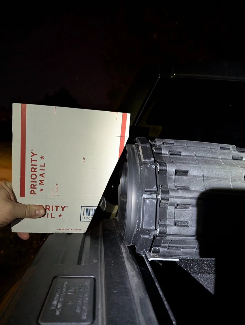

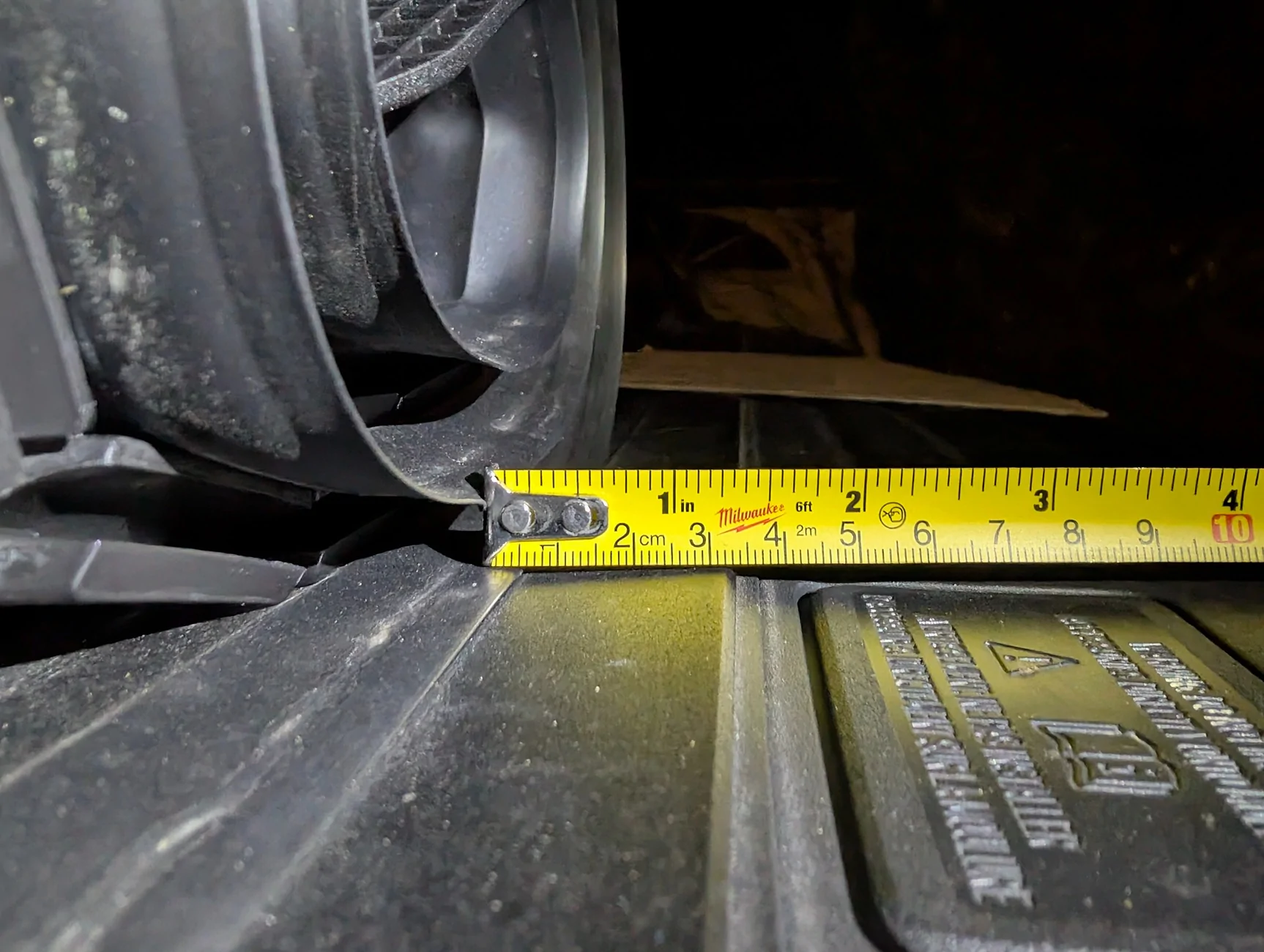

@AdventureLab
I did a cardboard mockup and it didn't seem to work.
It did not clear the rolled up cover at the bar location closest to the rear window and the angle was not steep enough to align with the mounting location and not block the rolled up cover.
Some of the contributing factors seem to be...
1) The cover does not roll up round. For the test, I rolled it up as tightly as I could and when measured at the crossbar location closest to the glass, it would have been too tall to clear underneath the bar. Also, tightly rolling it up is not easy unless it is rolled from inside the bed.
2) Even though I followed Bak's instructions and both mounting rails are mounted flush to the inside of the bed, the rolled up cover is not the same distance on each side to the mounting points' removable caps. 4.3cm Driver Side and 3.5cm Passenger Side. This variance will need to be taken into account when choosing the final interior angle. Could the interior angle be close to 90 and the exterior angle remain as you have it now?
If this would be easier to explain on the phone, feel free to shoot me a DM and I can send you my number.

@AdventureLab
That's absolutely perfect! That's a huge help. I think I can run with it from here.
To your question, could the interior angle be more vertical, yes, absolutely. I don't like going too thin with these verticals, though. We may be able to move the verticals outboard some as well.
Thanks again!!!

Glad I could help. I have plenty of cardboard to make some more templates to check again if needed this afternoon. 🤗
