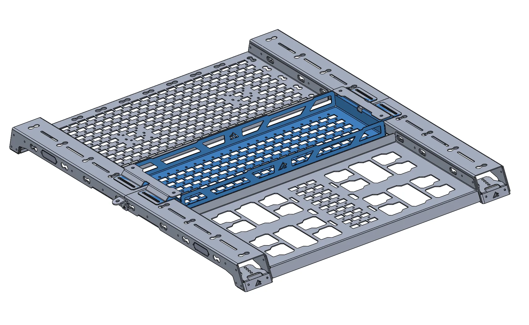

We already make a tray that spans the distance (lengthwise), but it was designed to fit between the two outer panels (shown below in blue). We could definitely make a larger one. That would be a cool setup. Unfortunately, to do it without joining flanges (if it were two different pieces bolted together), it will be a large box to ship.
https://americanadventurelab.com/product/tool-tray-for-ranger-rail-system/
How thick are the bars and how wide is the tray you had highlighted in blue?
