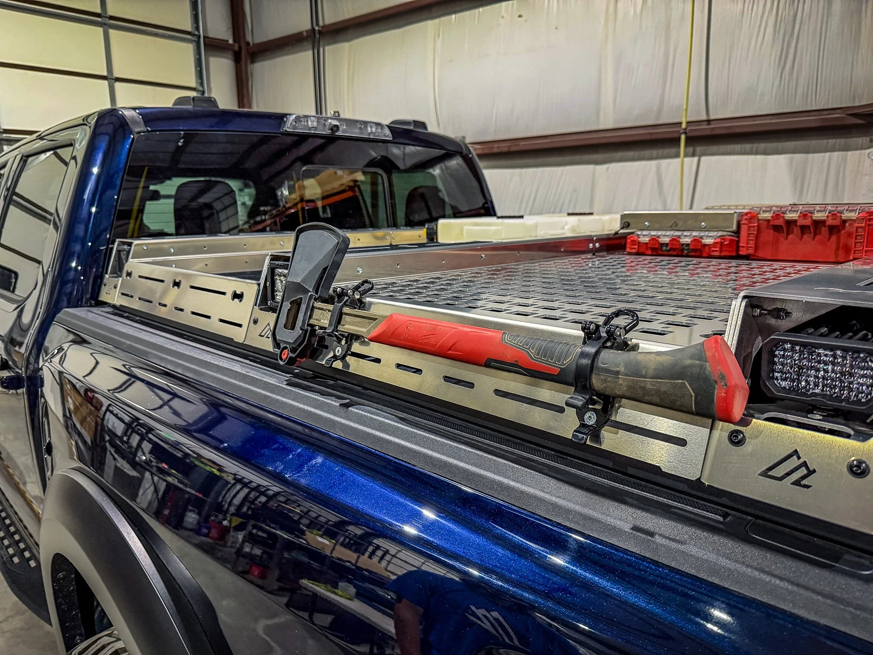

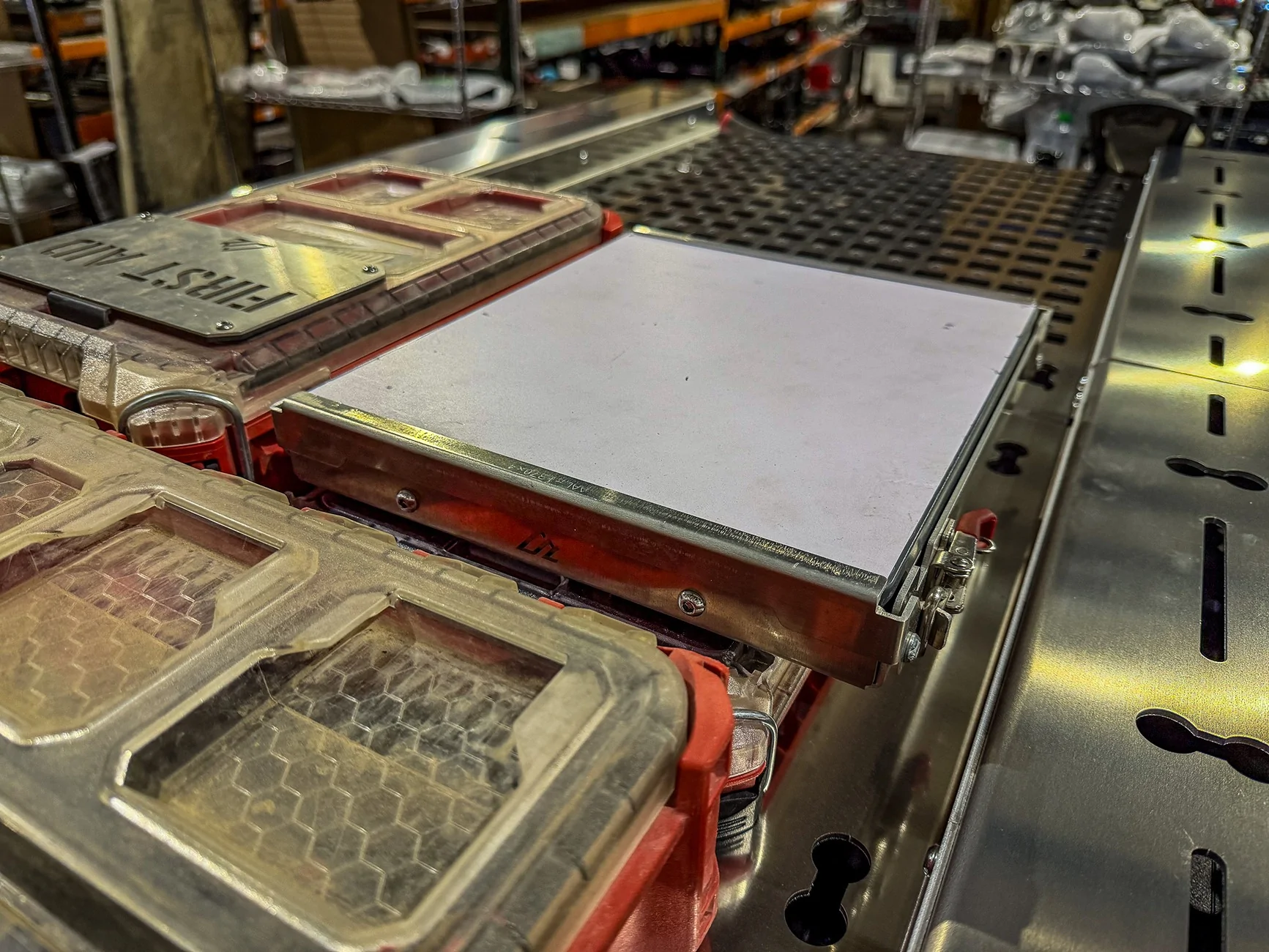

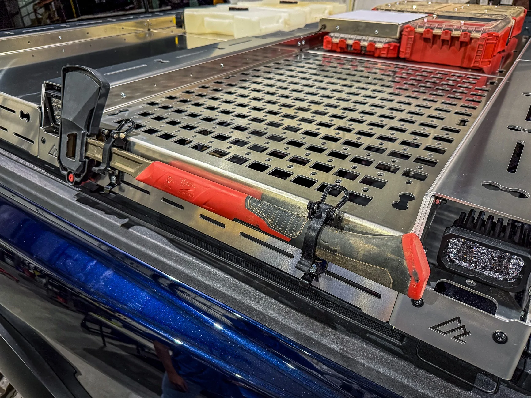

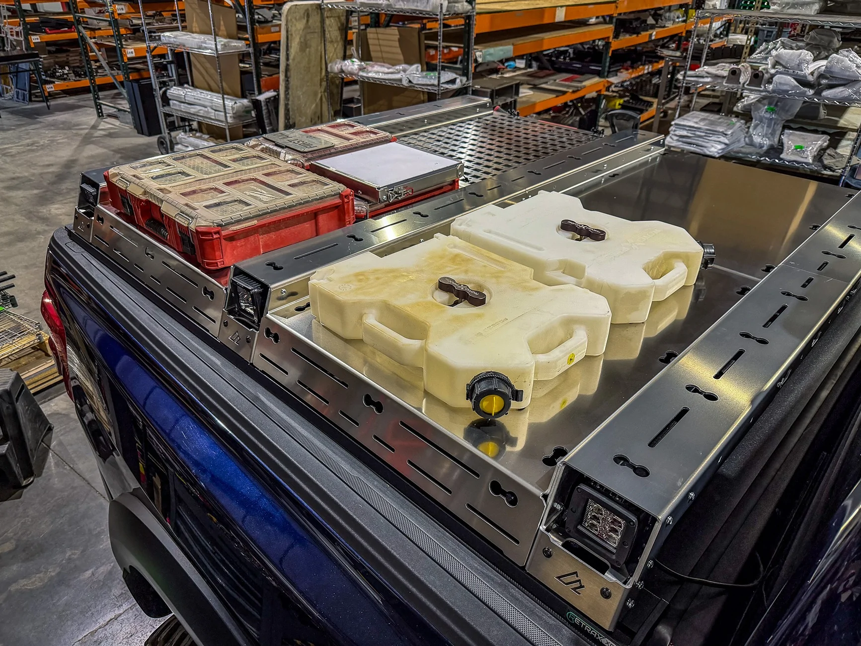

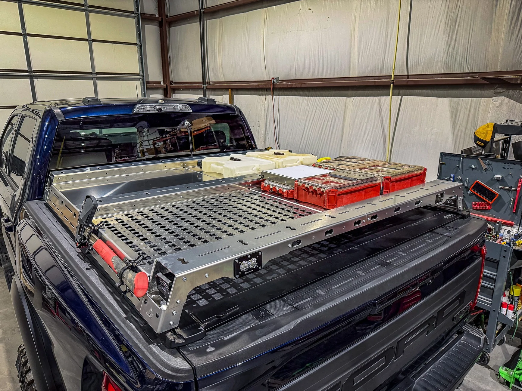

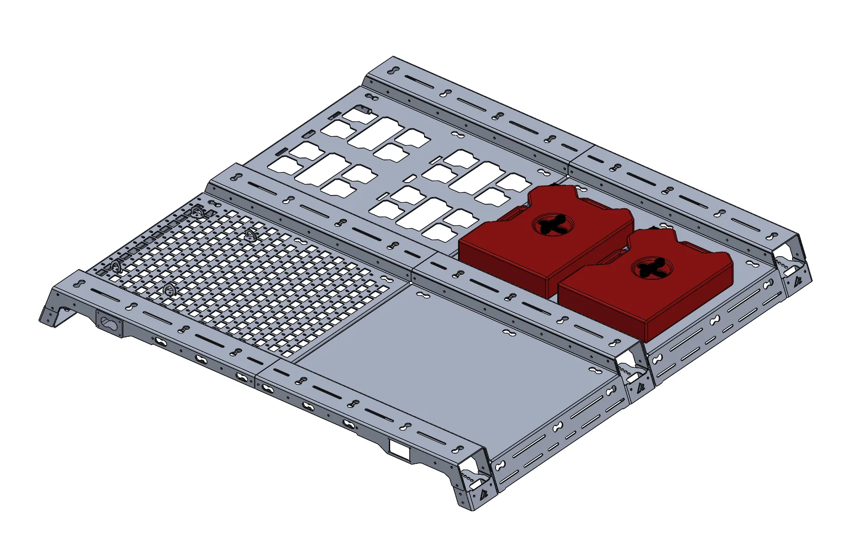

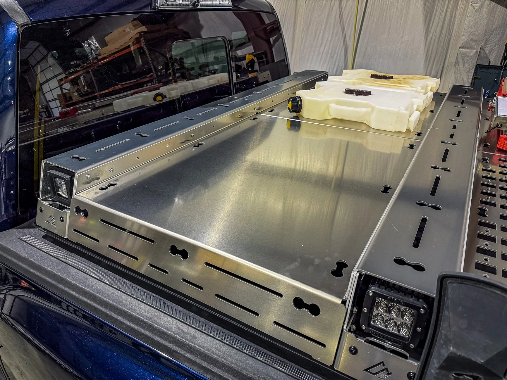

About to cut the trays for the Raptor R! I'm excited about these. Lots of flexibility.
Four different options:
  1. Blank (mount your own things)
  2. Full MOLLE
  3. Packout
  4. Rotopax
