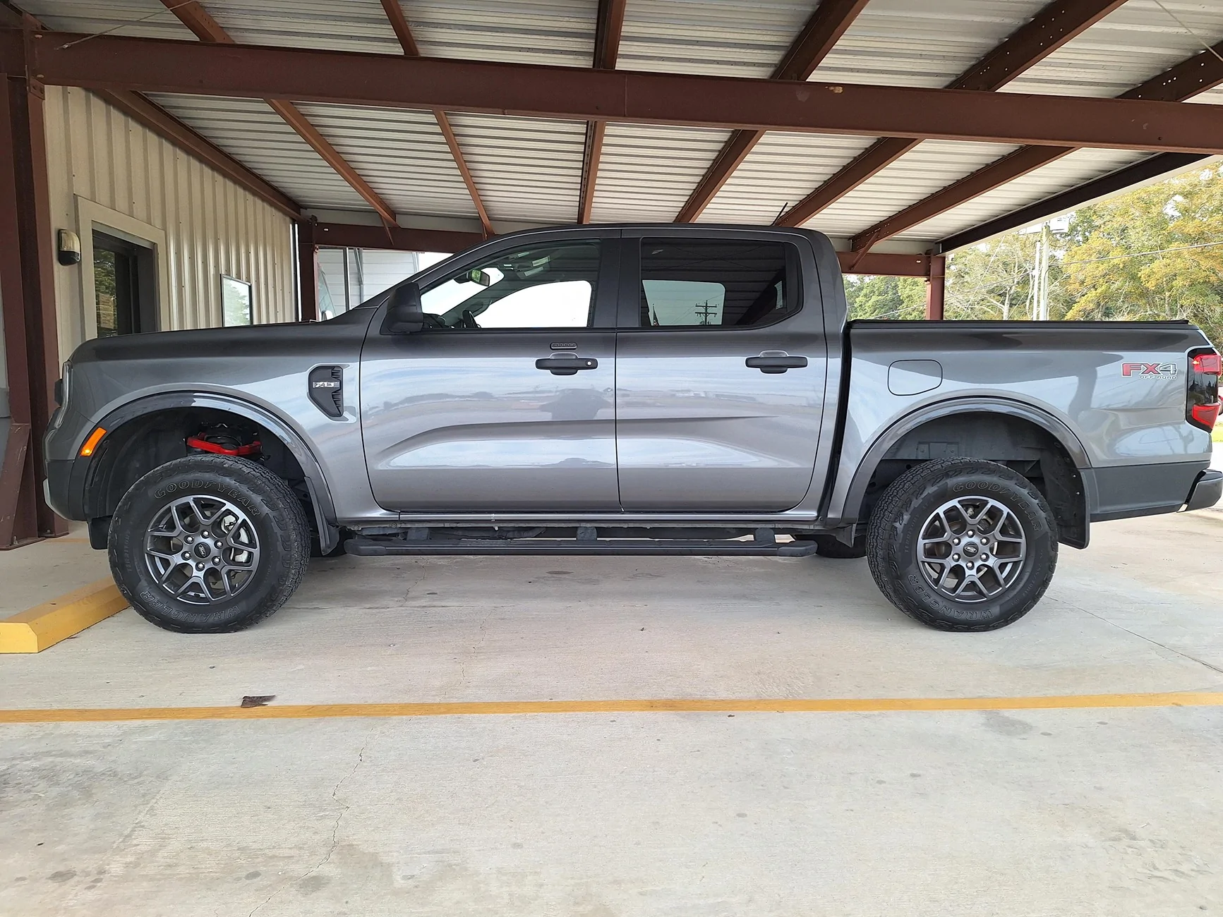

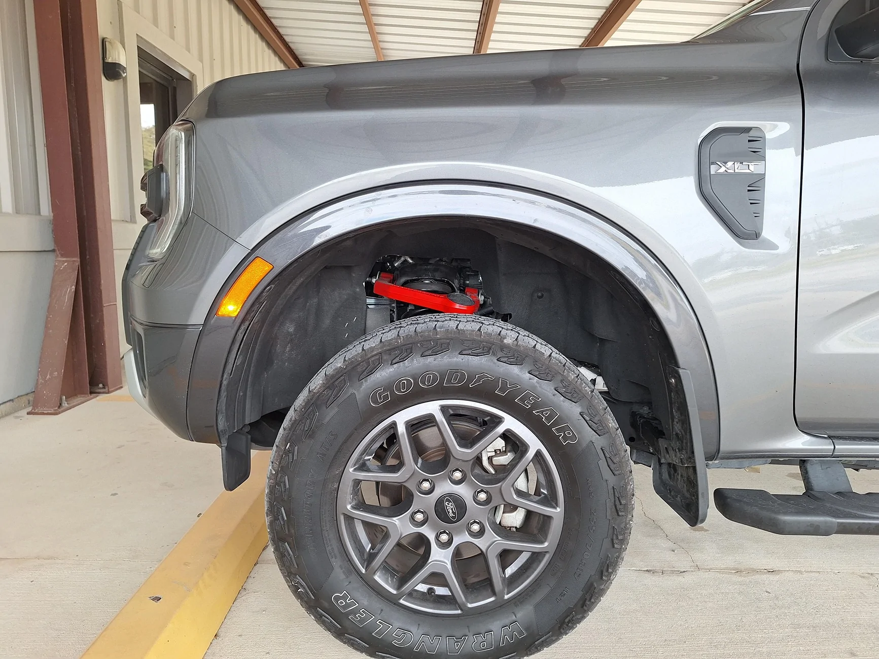

You don't need new UCA unless you go 3" or more on lift.
If you don't go over, OEM UCAs are fine, but if you want to change them, as I did, stick with OEM spec. Other UCAs made for 3" or more lift will have the upper ball joint out of whack.
I installed Rough Country OEM with a 2 1/2" level, just because I wanted red. They also have them for 3 1/2" lift, in red or aluminum finish.
Also note, that a spacer that says 2 1/2" rise, will be closer to 2". I used MotoFab 2 1/2" from Amazon.

That red UCA looks great and less stress on the upper ball joint as well.
