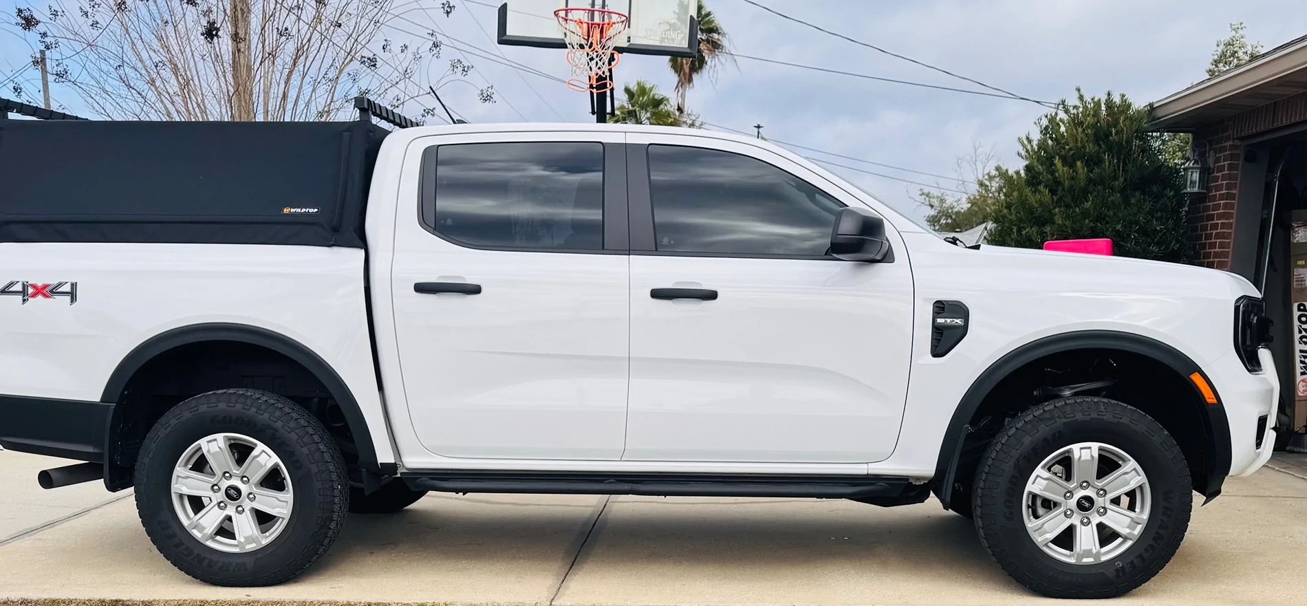

My STX was only 2” lower in the front. I did a 1.5” level and it looks perfect to me. Technically there’s 1/2” rake but I can’t see it. I would measure the difference now at the center of the wheels and go with 1/2” lower than exact level unless you want a lean to the back look.

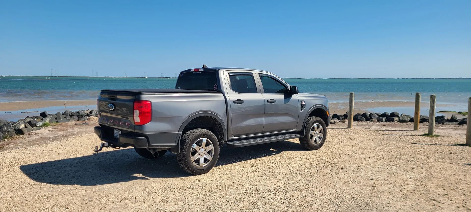

I used photo shop to see what Mine will look like with stock wheels and a leveling kit.
Ford Ranger 2" or 2.5" - Front end lift to level? CGM leveled
I even photo shopped off the FX4 decal just to see how it would look.

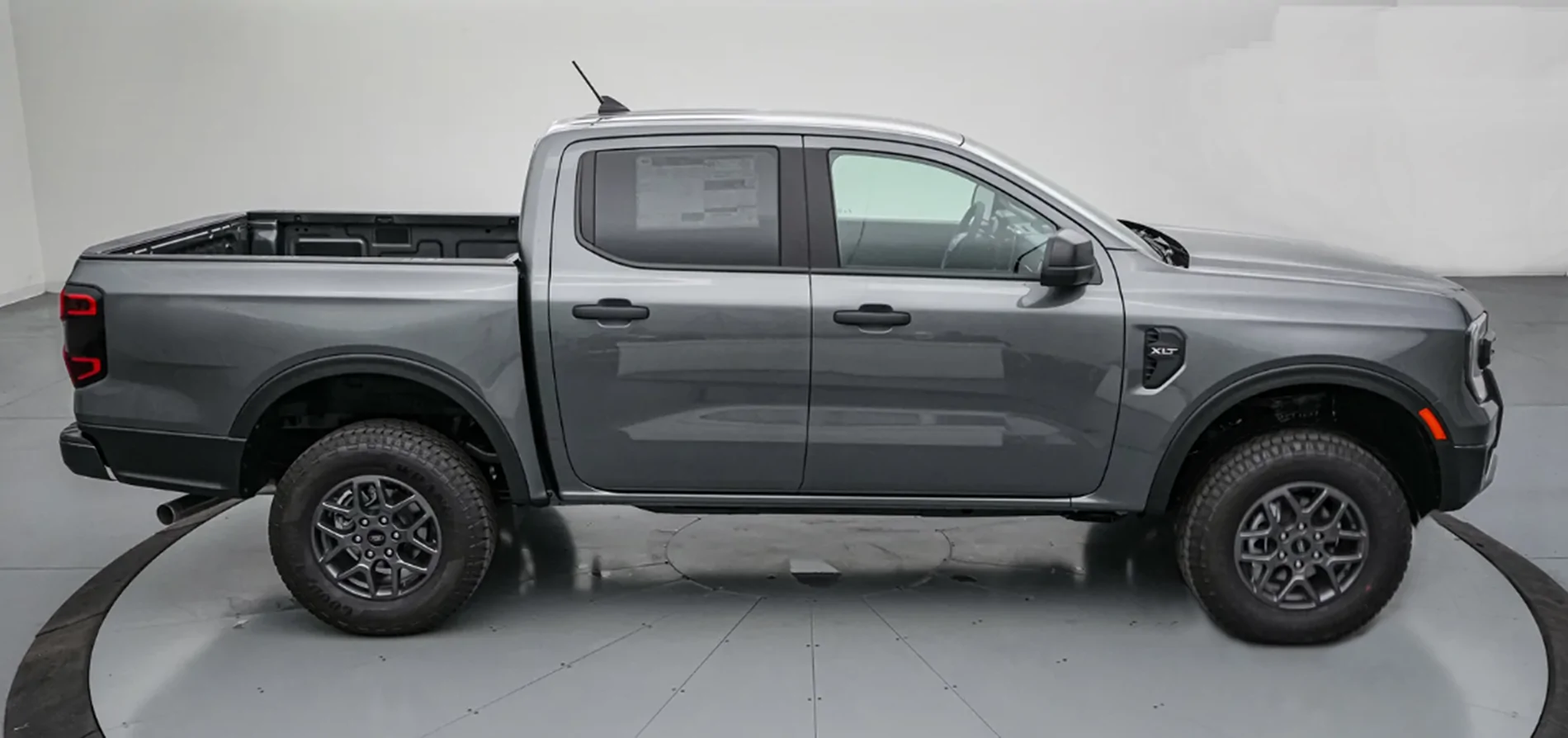

Here's another modified pic:
Leveled with stock wheels

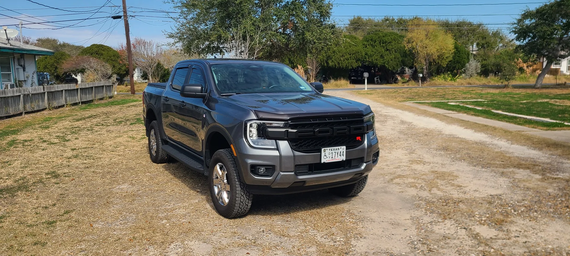

This is what it looks like in real life
