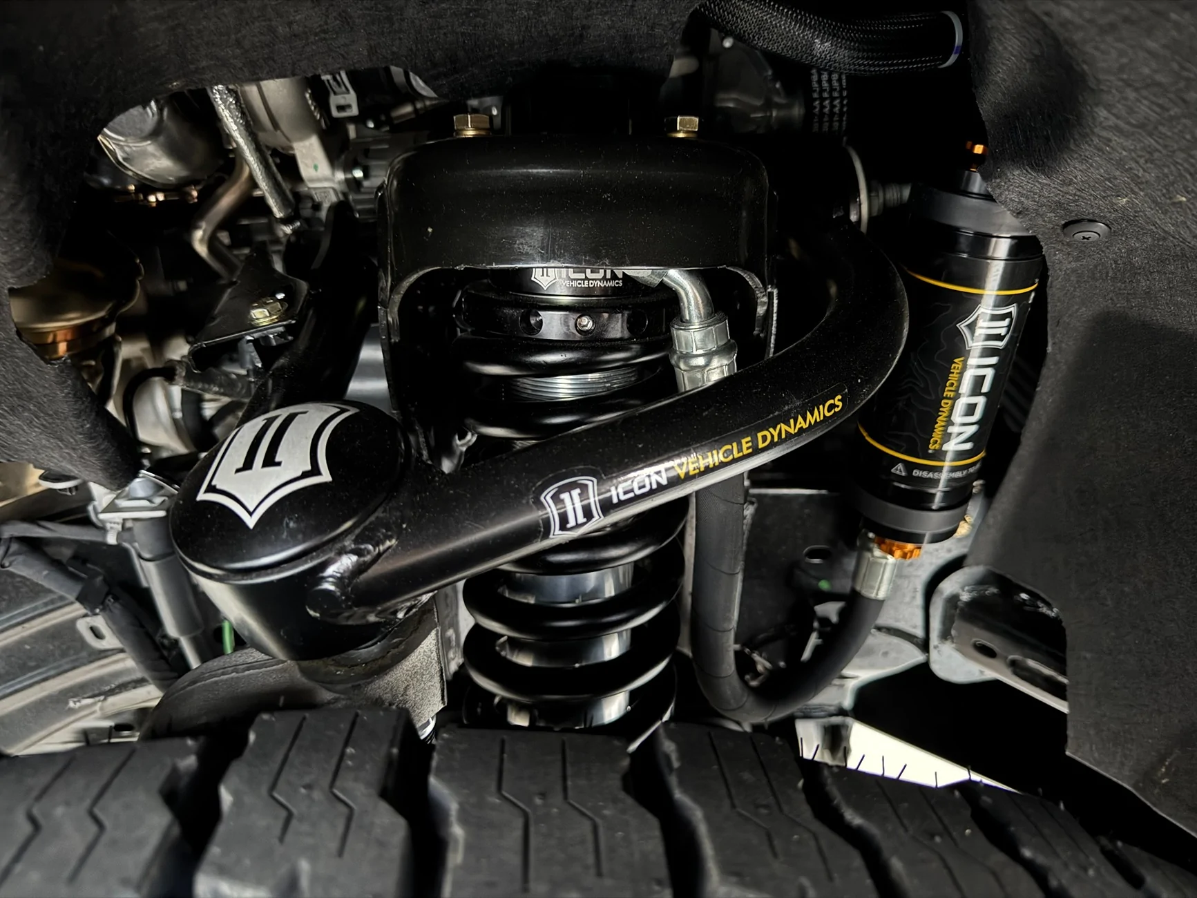

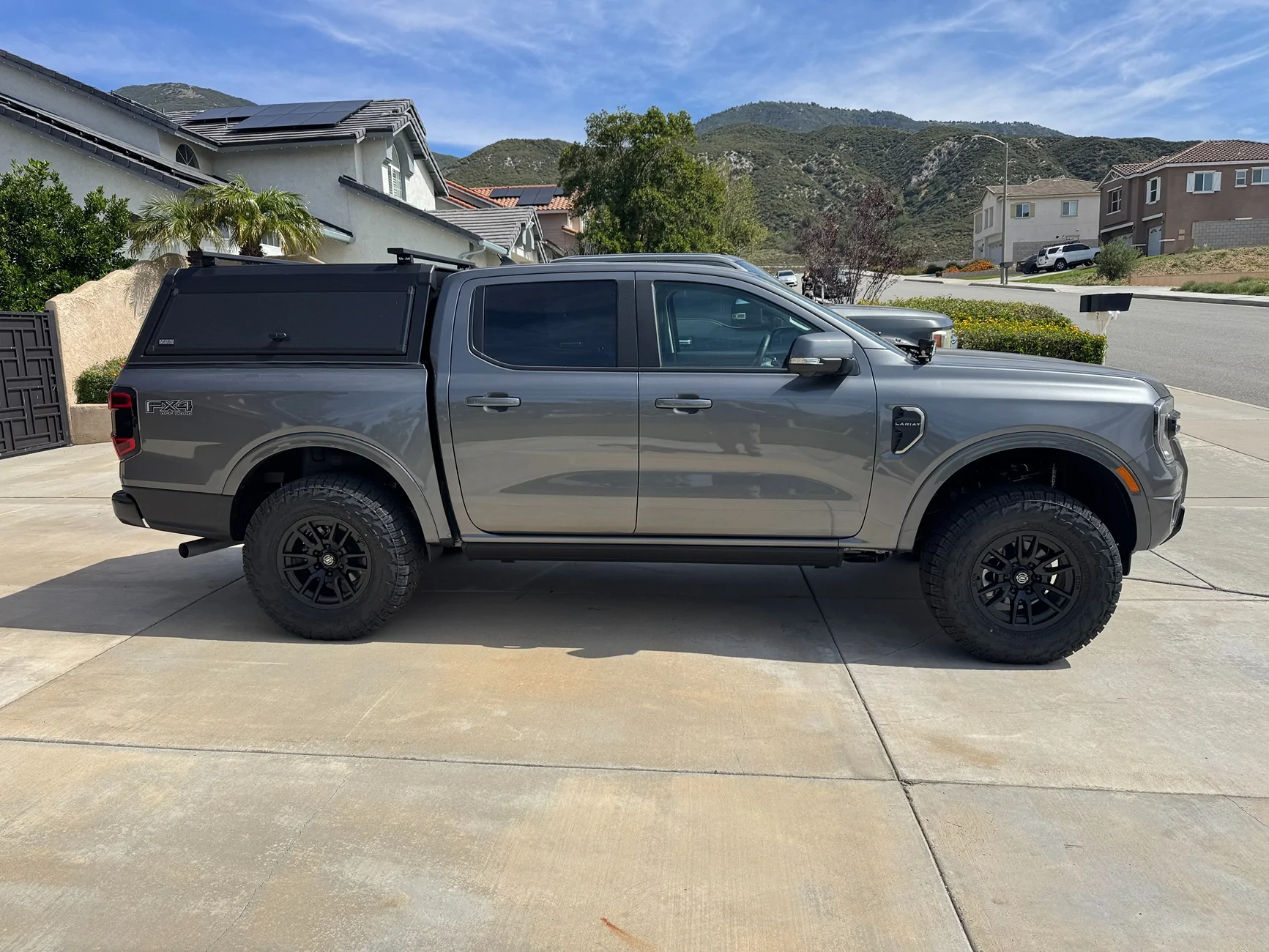

I just had mine leveled out this week at ICON Vehicle Dynamics. New adjustable Coilovers front and adjustable rears. At the same time we swapped out the factory wheel and tires with 285/70R17 Falken WildPeak A/T 4W tires on ICON Vector 6 Wheels with 25mm offset. They also did an overload spring on the rear.
I love the way it turned out. They were awesome to work with and did a great job. I have a similar setup on my 2017 Super Duty so I wanted to go with ICON again on the Ranger.
This was their R&D for the 2025+ and should be available soon.

VERY nice! 😍
That right there is about perfect for these trucks. Good to see Icon getting into the Ranger game (and not just the Raptor). A plug-and-play option from them will be awesome!

That looks like the front end is VERY light.
Forsch
Joshua
Feb 8, 2026
San Bernardino, CA
2025 Ford Ranger Lariat 2.7L short bed
It’s not. I still had the stock tires and wheels and the new spare in the back when I took the photo. I realized it after.
