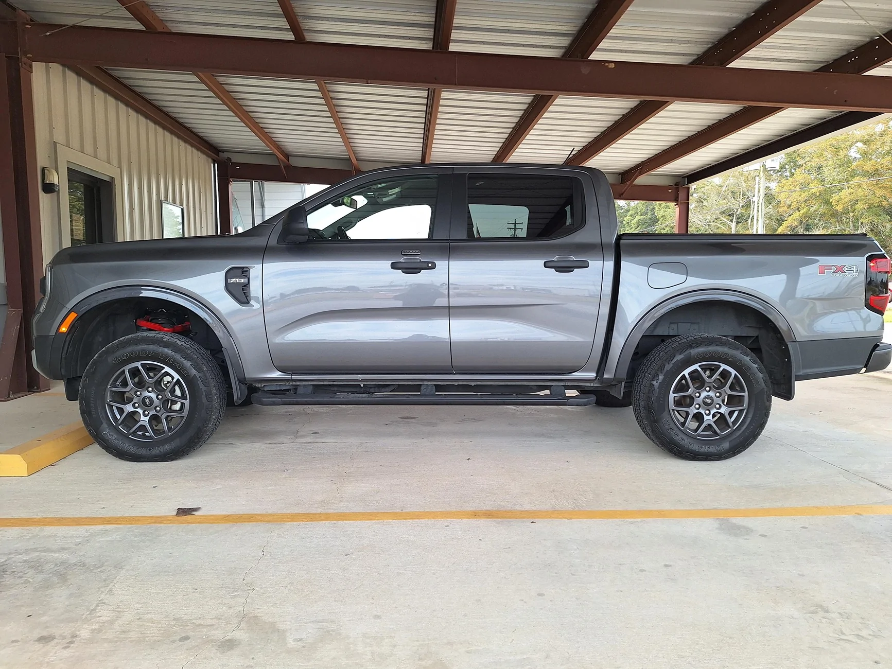

As I don't see anyone else mentioning that they did a 2" lift, I have a 2024 FX4 2.3L with a 2" front lift. I l am happy with the decision, I didn't want a perfectly level height front and rear, I wanted to maintain some rake so when I tow or load the bed its not squatting in the rear too much. I also was worried about limiting down travel of the suspension when off roading so that was another factor. With some time messing around on the alignment rack I was able to get the front wheels to a 0 degree camber but if I had gone with a 2.5" front level I would still have a bit of positive camber left over without doing aftermarket control arms.

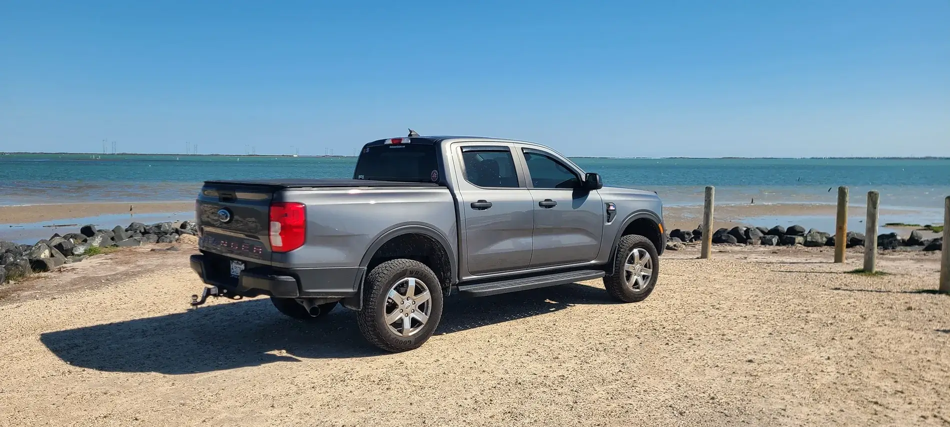

I just received the Eibach Pro truck sport shock, I’m trying to decide if I’m going to set the snap ring @ .9” or the 1.8” setting, I haul some stuff for work on occasion and tow my small boat twice a year for seasonal in/out.
Currently I measured the height at the rear it’s 38” front is 35” ( ground to wheel moulding )nothing in the bed and a nearly empty tank (about 3 gal’s) .
I changed the tires from the stock 255/70/17”s to 265/70/17 I had on my ‘24 Ranger they have a lot of tread so I reused them, there’s 6” of gap between the top edge of tire and the same mouldings, not sure I want to increase that by 2” as the tires would have a bigger look gap, so it’s balancing act.
My second goal with these shocks is to improve the rebound and mushy feel hope that’s the case.
Any thoughts on if my meaursement/ calculations are off.

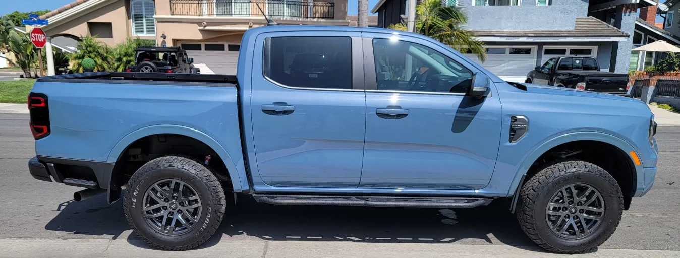

I just had mine leveled out this week at ICON Vehicle Dynamics. New adjustable Coilovers front and adjustable rears. At the same time we swapped out the factory wheel and tires with 285/70R17 Falken WildPeak A/T 4W tires on ICON Vector 6 Wheels with 25mm offset. They also did an overload spring on the rear.
I love the way it turned out. They were awesome to work with and did a great job. I have a similar setup on my 2017 Super Duty so I wanted to go with ICON again on the Ranger.
This was their R&D for the 2025+ and should be available soon.
no idea but if you have 3", i guess try the 1.8 setting and see how it looks?
Yea the only thing is the whatever i choose to set the the C clips at there not changeable, unless the shock is removed again, so it's pretty much once n done.
It's the same style as the Bilstein 5100's.

That looks like the front end is VERY light.
Forsch
Joshua
Feb 8, 2026
San Bernardino, CA
2025 Ford Ranger Lariat 2.7L short bed
It’s not. I still had the stock tires and wheels and the new spare in the back when I took the photo. I realized it after.
