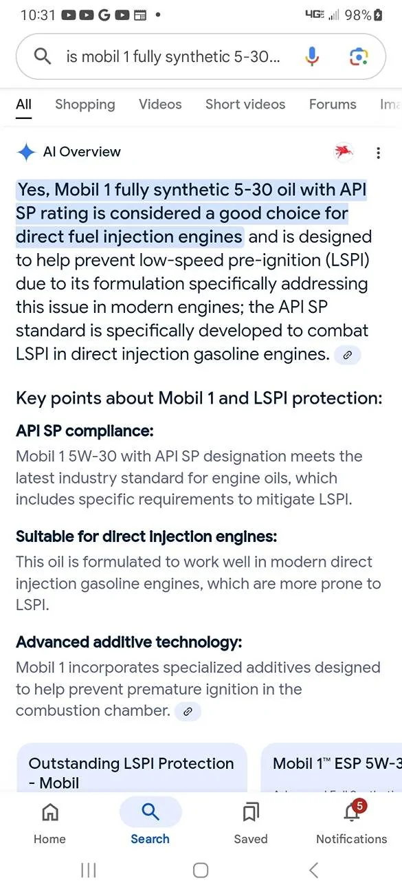

Hey Wayfaring Ranger I just watch a video of the low speed pre ignition, and the first most important factor is using a high quality oil with API SP that are designed for this purpose with direct fuel injection 2nd high quality fuel with a minimum of 88 octane, 3th is your comment about and its just important as the API SP oil LET YOUR VEHICLE WARM UP in especially cold weather until the oil can do its job ,and changing you oil frequently, I'm using 5w-30 mobil 1 advice formula with API SP!!
