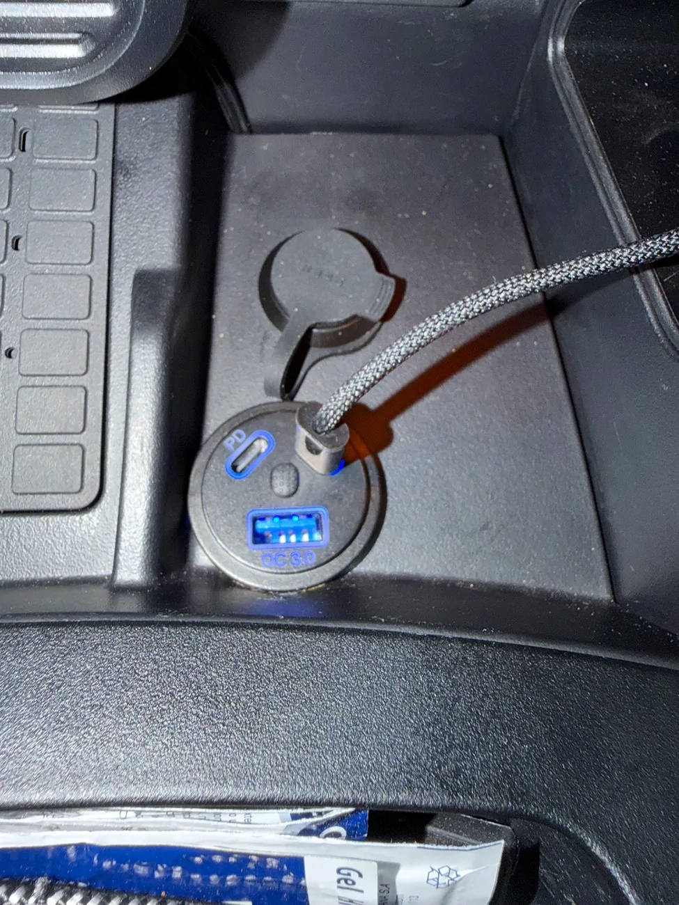

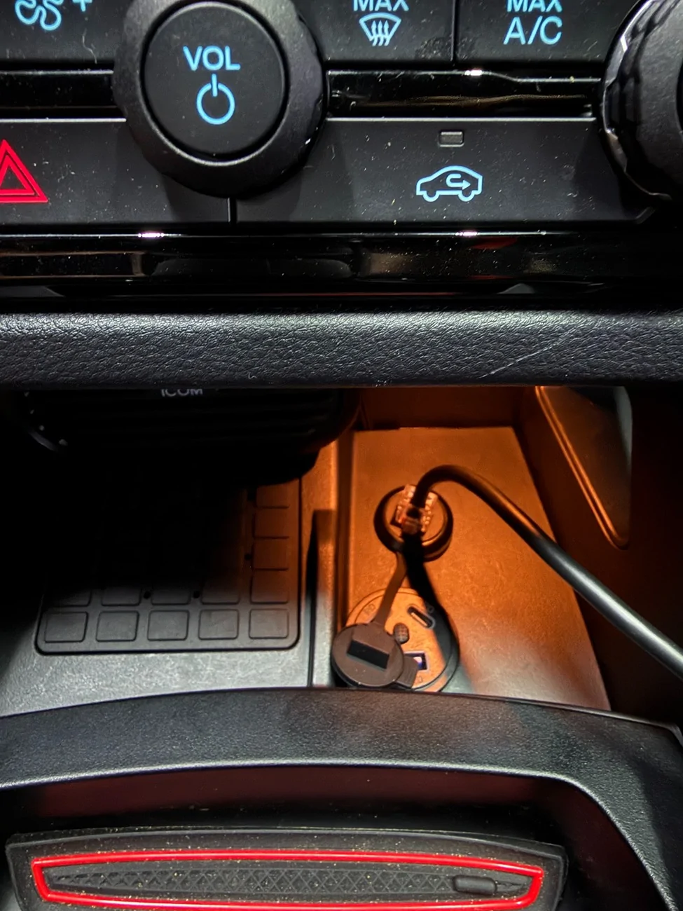

I tapped into the fuse box next to the steering wheel using an add-a-fuse. For the ground, I just used one of the factory bolts behind the wireless charger panel.
Since I already had everything apart, I also installed a dual USB-C and one USB-A power outlet. It turned out really clean. Here's a photo in case it helps anyone thinking of doing the same.
