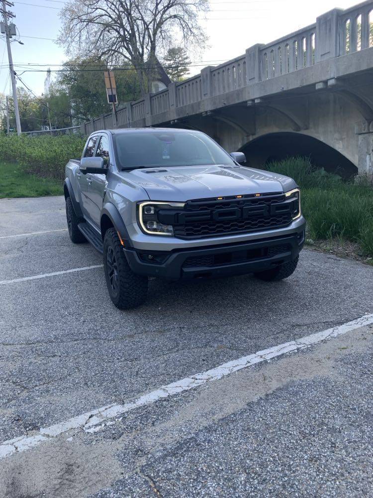

It depends what you mean by "flush". I've asked this question before and didn't get an answer. If you want the sidewall to be flush with the top of the fender, then I wouldn't go below a +30 offset.
If you are fine with a little poke of the sidewall, but the tread is flush with the top of the fender, then you are good with a +20 offset.
Here is a pic of my wheel (+20) and how it compares with the top of the fender. This to me is the perfect offset.

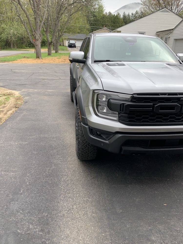

I did 1" Bora spacers which is equal to 25.4 mm.
Ford Ranger Most Aggressive Wheels Offset Without Any Mods? 436283227_433319315950125_2833800532647091189_n
Ford Ranger Most Aggressive Wheels Offset Without Any Mods? 436596668_1434140724159171_8820319165077282079_n
