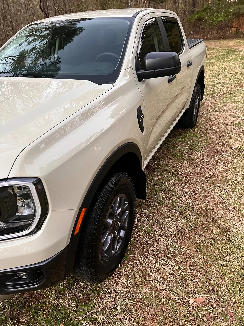

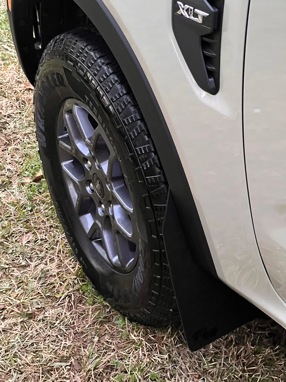

Installed front and rears. I screwed up the fronts so there an extra set of screw holes in the mud flaps but the holes are inside the fender. I initially measured but didn’t take into account the curve. Then I taped a large envelope to the fender and made a perfect template. Rears are perfect with no extra holes. Whenever they release the official ones I will buy a front set.
