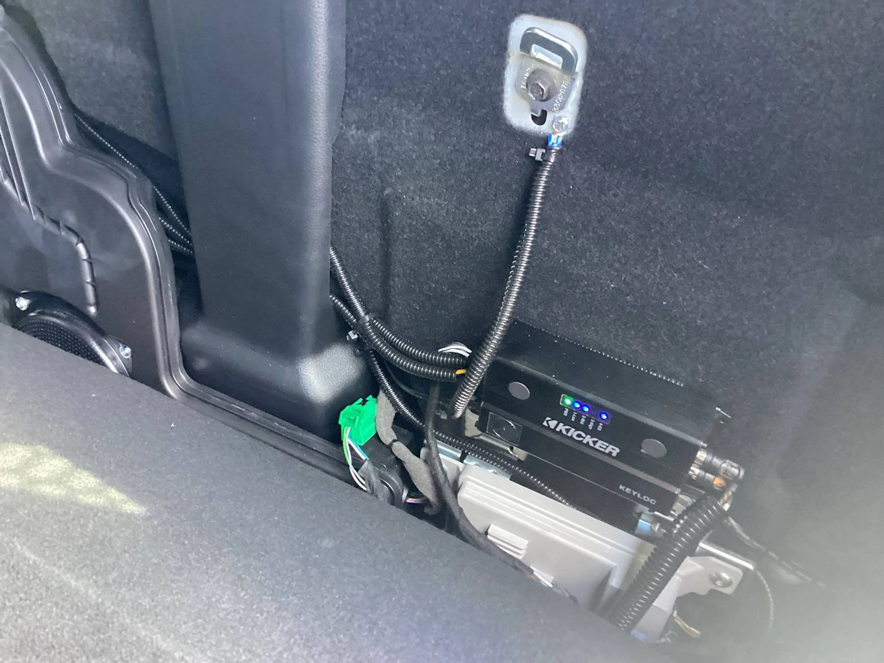

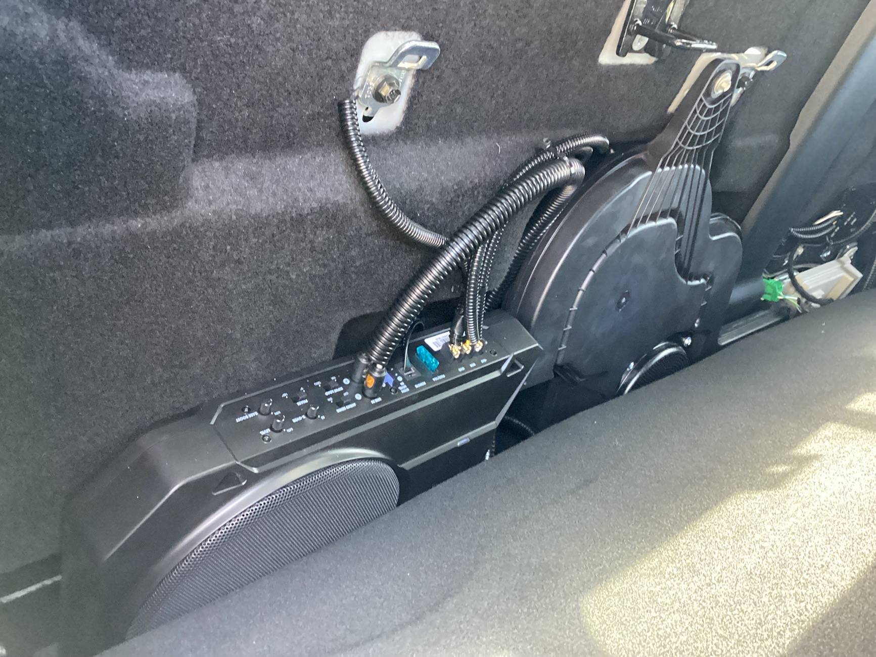

Pretty easy to make it sound better!

You mind listing the links to these? I’m assuming that’s a kicker 8 inch hideaway and kicker key lock line out converter? Anything else you used?
between this and the led lights on front I’m basically trying to emulate your truck lol
I couldn’t find the link on sounds goods website for the kicker with the harness,it is plug and play with the factory sub. The sub is the JBL bass pro 2
