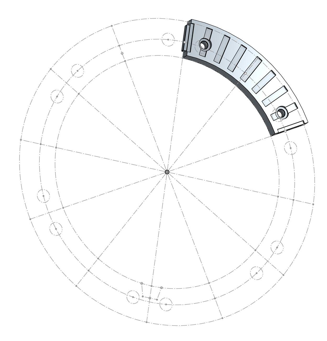

Hey brother... I'm gonna post a video about this right now... one thin I notice that isn't integrated into your 3D print is the cut out for the valve stem. that is a must have for the trail goers and really everyone that wants to add or release air in their tires. Just a thought... I mean it could be cut out with a coping saw and a file but it could possibly be changed in the design as well. just food for thought. Cheers.
Yeah I didn't forget about it. I already have it modeled. I just didn't print it yet as I had a lot of trouble getting the dimensions right. I also need to add features on the back of the trim to reduce thickness.
Will use ASA Filament, which is likely the best combination of UV, Hunidty resistance, and price. Color options can be found on these 2 links:
https://www.amazon.com/Polymaker-Fi...8-2-spons&sp_csd=d2lkZ2V0TmFtZT1zcF9hdGY&th=1
https://www.amazon.com/OVERTURE-Pri...8-1-spons&sp_csd=d2lkZ2V0TmFtZT1zcF9hdGY&th=1
ill post more once I get it dialed in, maybe another week.
You can see the valve stem cut-out at the bottom of the MCAD outline, I need to print one with it.
