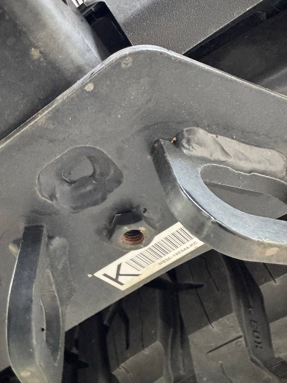

Noticed a 10mm threaded nut on the bottom of the receiver - for an anti rattle device or some unknown accessory?

Ford Ranger Noticed a 10mm threaded nut on the bottom of the receiver - for an anti rattle device or some unknown accessory? IMG_0568

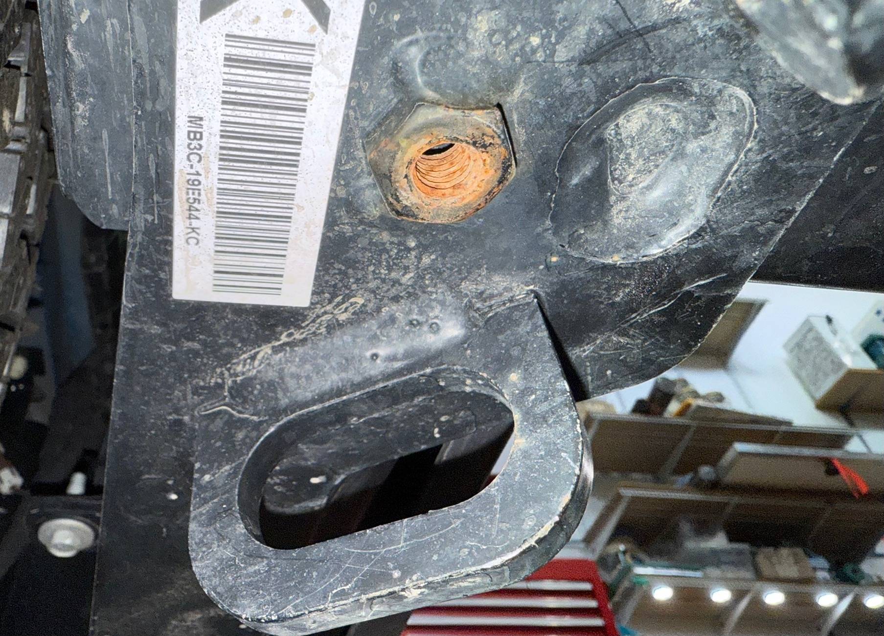

Ford Ranger Noticed a 10mm threaded nut on the bottom of the receiver - for an anti rattle device or some unknown accessory? IMG_0569

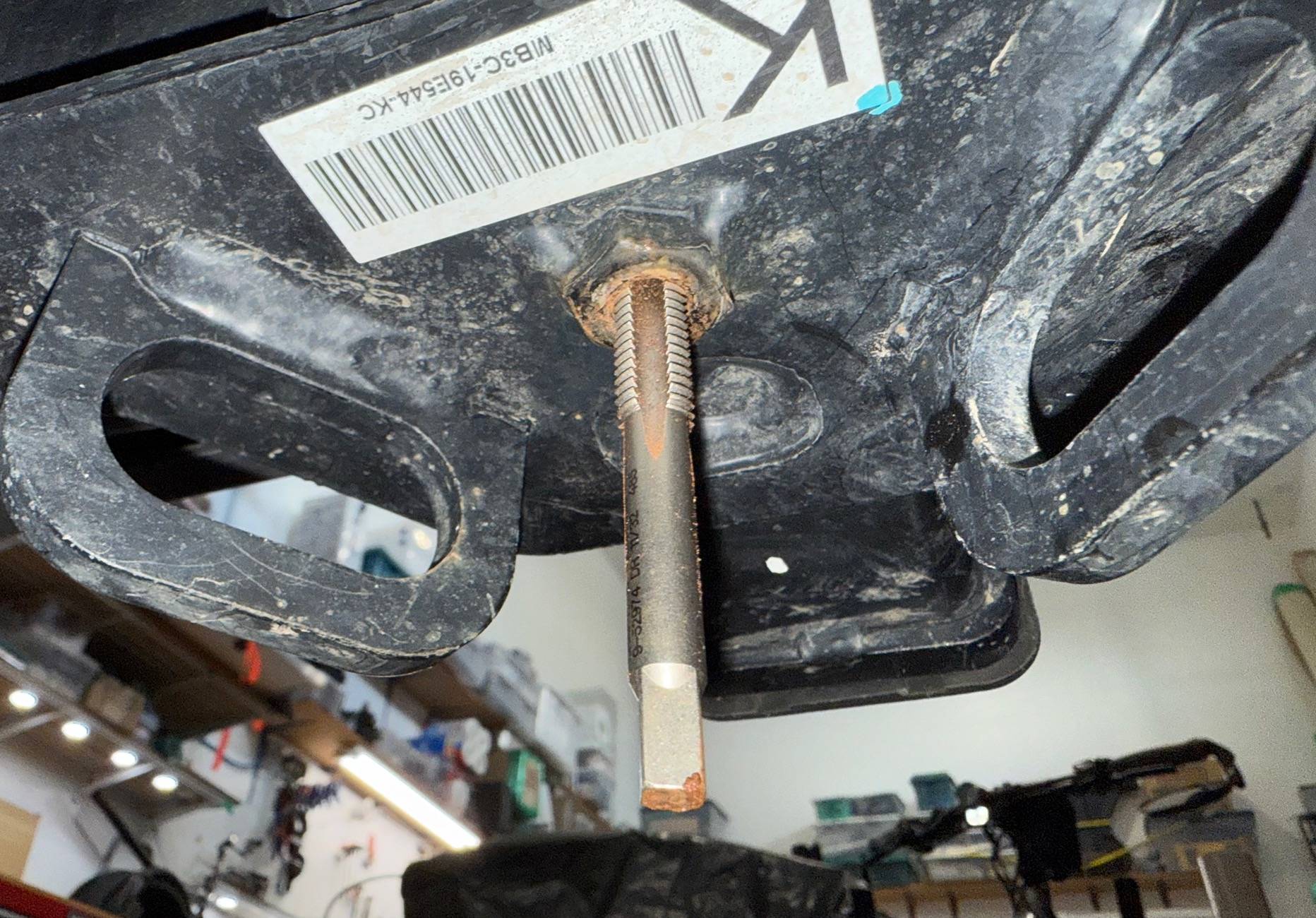

I ran a 10mxm x 1.5 tap in it and was wondering if it would be worth buying a stainless bolt and keeping it in there with antiseize compound on the threads, as an anti-rattle device…? I worry that the threads would get bashed and I would not be able to remove it later.
Or it could be used as an anti-theft device for your expensive hitch, it is not likely that a thief would know to look underneath for extra hardware. Comments?

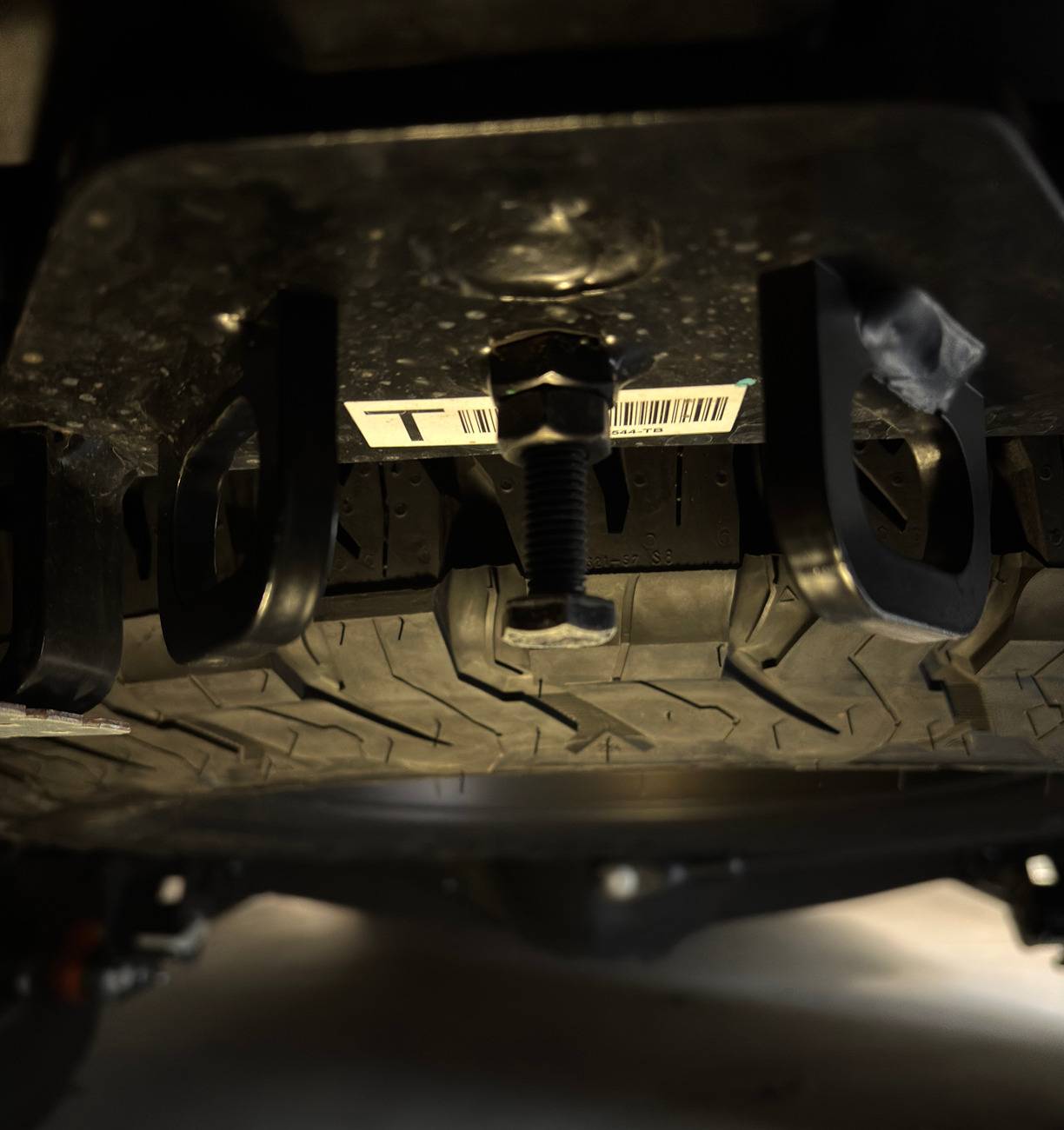

Mine has a bolt and nut in there from factory. Maybe yours was lose and fell out? Or wasn't fitted from factory?
Sorry for the dark pictures. it's early morning here and the Raptor is parked in my garage
Ford Ranger Noticed a 10mm threaded nut on the bottom of the receiver - for an anti rattle device or some unknown accessory? IMG_6089
Ford Ranger Noticed a 10mm threaded nut on the bottom of the receiver - for an anti rattle device or some unknown accessory? IMG_6086

Since the inside threads are rusty, it means they were never powder coated. I wonder if this is simply an attach point to hang the receiver correctly for final finishing? It appears to be close to the center of gravity. The bolt sticking out could hang on a hook in the powder coating booth.
