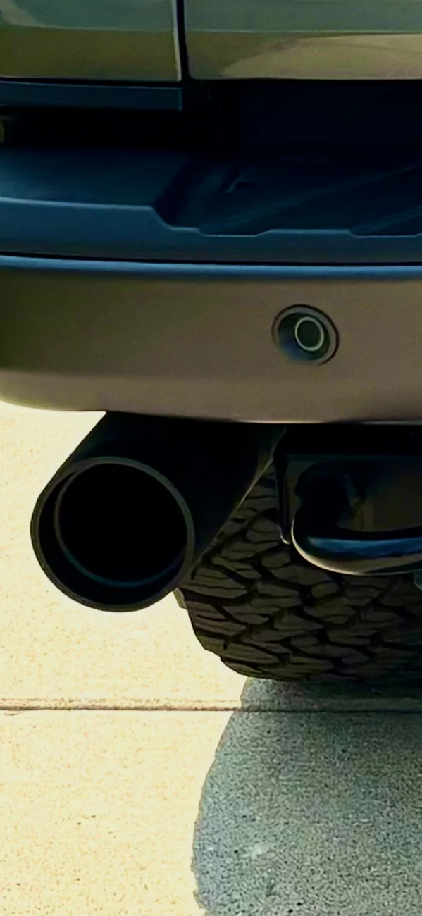

Heat resistant silicone pipe 3.5" ID off eBay.
Slide on using liquid soap detergent. These have been on for 24,000 miles, no issues.

Cut to your preferred length. I left a little overlap as it looks cleaner.

Before I installed them. Painted the outside and ends in Plastidip as I wanted a Matt black finish.

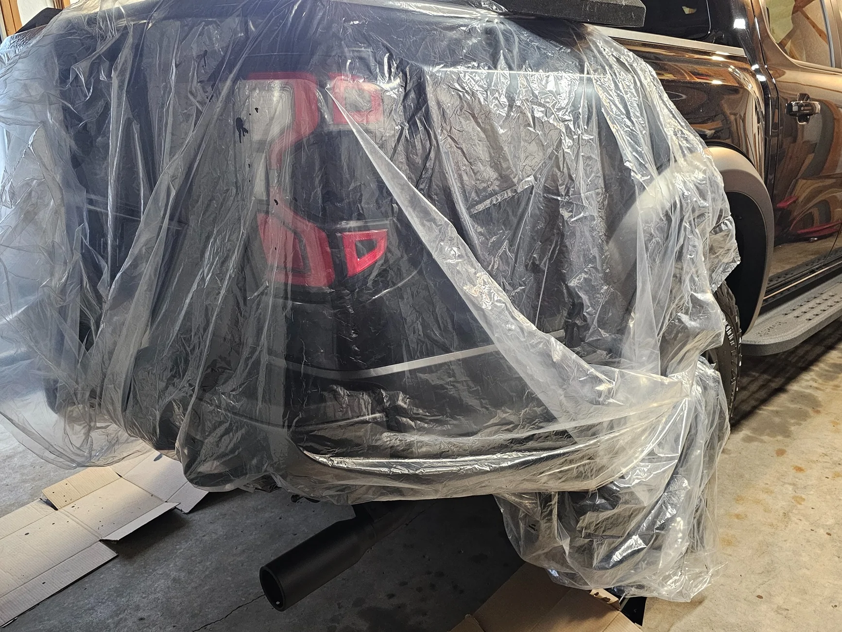

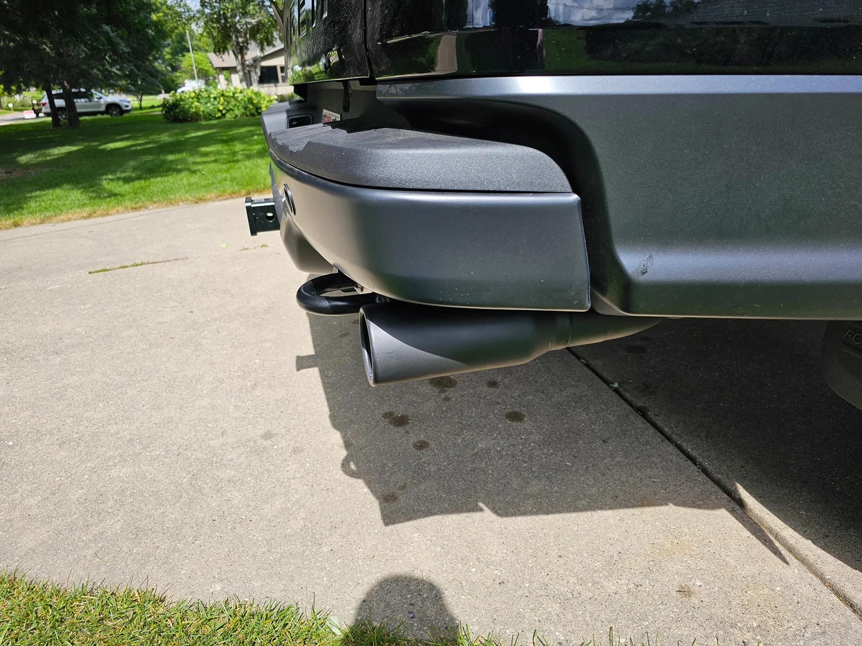

Started with a High Heat Primer (do not recall if I did any light sanding first, I may have done a 1000 grit but do not remember) then many layers of the High Heat Ceramic Coating (Flat Black) and painted pretty far up towards the rear axle (not just the tips). Sprayed as many coats as it took to empty the can (I think it was 5 coats).

Had a huge plastic bag from a queen size mattress that I wrapped the back of the truck with (including underside and tires) and had cardboard on the garage floor for drip and overspray (I am OCD and sprayed the exhaust in places that will never be seen).
