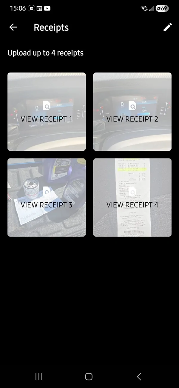

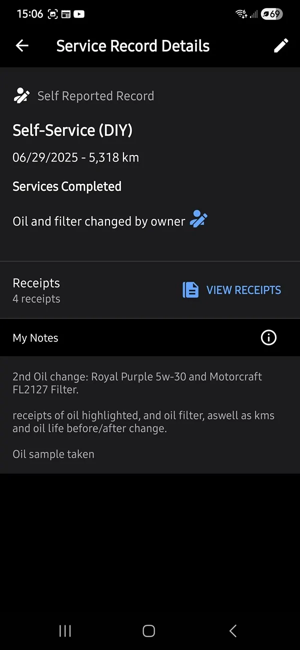

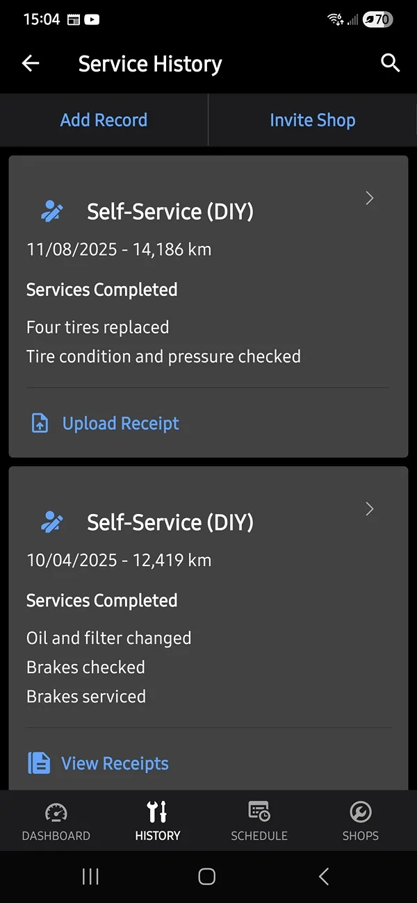

I dont have the maintenance package on my xlt. I do my own oil changes. on my 3rd one since april. my dealer told me to keep recipts for oil/filter, take pictures of the oil life remaining, with the milage before reset, and after reset, and if go to garage, that recipt. then they said once a year, or when the book calls for the service interval. get a warranty inspection done.
so for me in canada, it was 12months, or 16,000kms... I get my inspection next week. and I use the carfax care app to keep track of all my maintenance, lubing brakes, tire rotation, oil changes, etc. and you can upload "4 recipts" so I upload the oil filter from the dealer(so that is attached to my vin) the picture of the oil recipt, and then the before and after oil life rest with the kilometres in the shot aswell.
the book called foe 12months, or 16,000kms before first oil change..... break in change at 1500kms, then oil changed at 5600kms(took an oil sample) then again at 12,400kms. In march/april now when I do my 4th change or roughly 6k kms/12months, ill take my second oil sample and send both in for analysis.

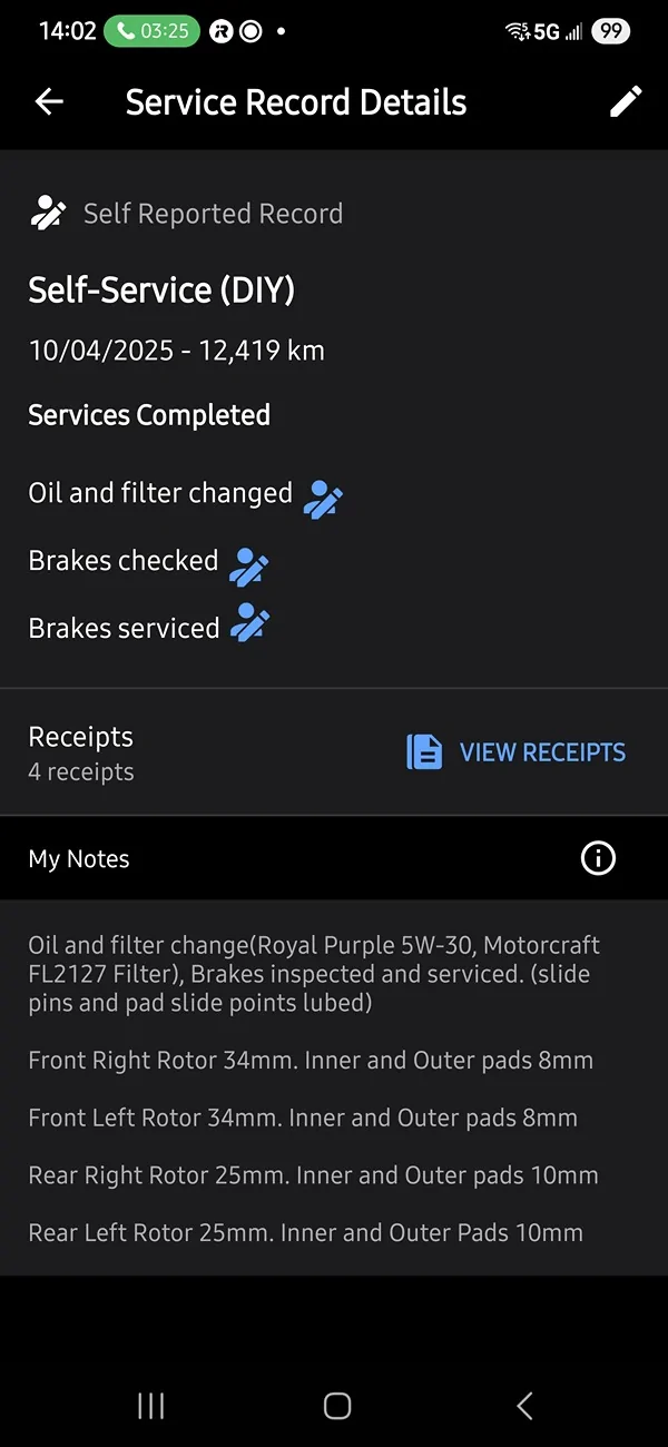

I dont know if you can do it on truck and send, when I first got the truck in april. ford pass allowed you to record your maintance, and upload recipts. 3 days later, there was an app update that removed it for me in canada. ffs. lol. but this is all I do. picture of the filter recipt, filter of the oil recipt. picture of the oil life remaining(this was my first oil change at 5200kms after my break in oil change at 1600kms, after that I streatched out my change interval)then picture of oil life reset, as per the warranty dept manager.
