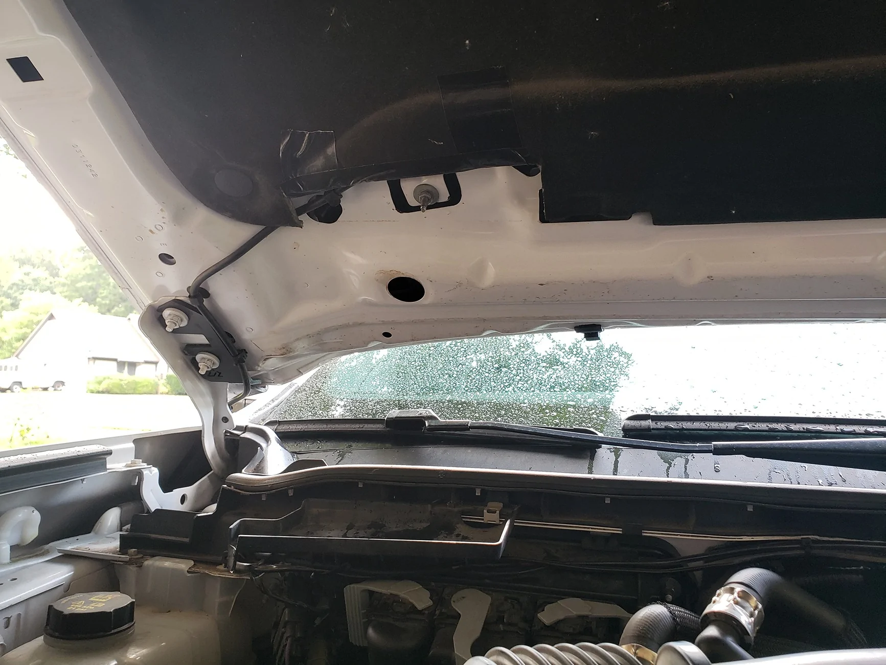

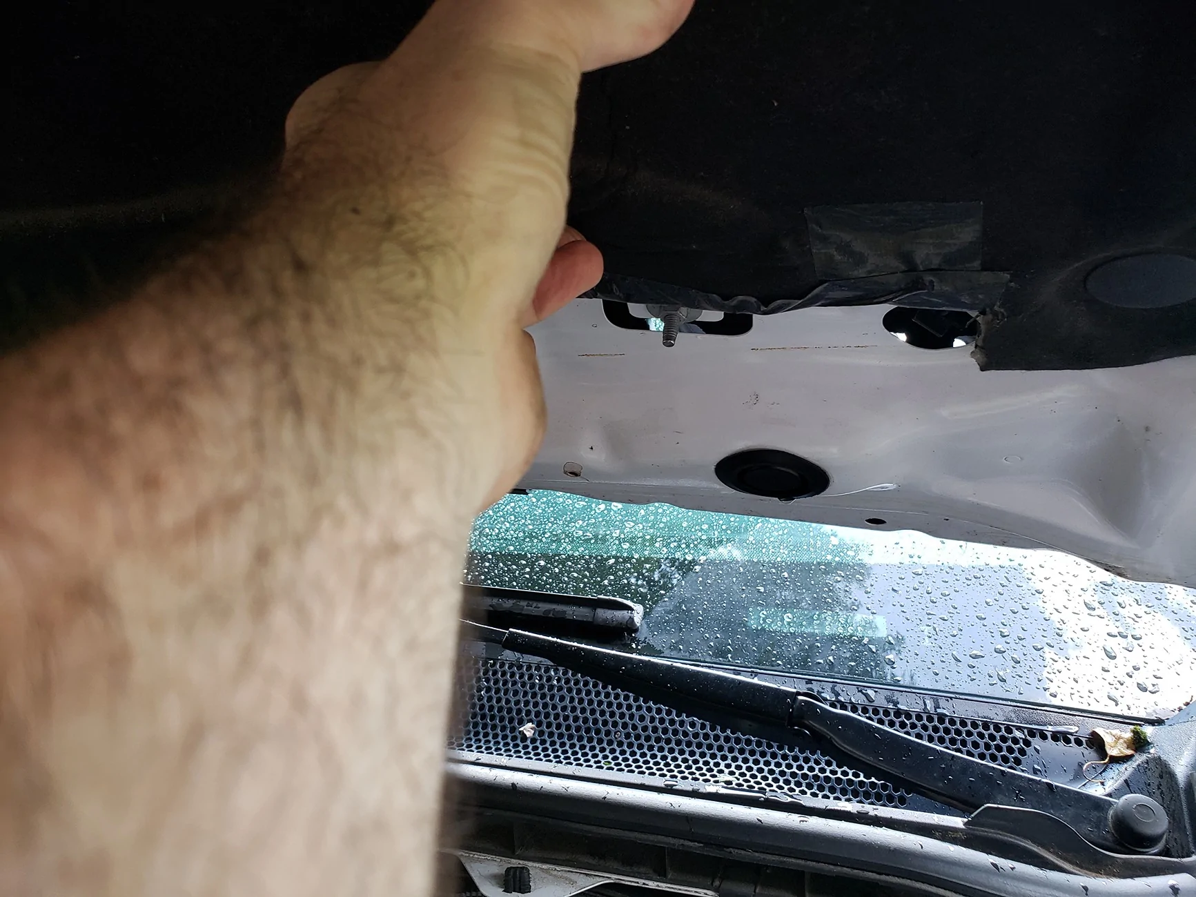

The extractors are down and rearward facing, and they open up to a low section in the hood meant to channel water to the passenger side where the tray, bolted to the cowl, is located. You'll see that the rubber plug on the driver's side (above the brake reservoir) is missing on the passenger side above the tray. That's where the water drains from the hood to the ground.
I didn't cut any plastic yet, but I plan to do a little strategic cutting on the extractors like @DirtDerrick did, as well as some trimming of the hood liner. I've already found one hole clogged with debris, and then another two covered completely with the foam liner instead of open to the channel below.
I believe the heat mainly escapes via the water drain hole and through the body clips on the corners that hold the extractor in place. Not a ton of improvements to be made without additional cutting, but every little bit can help.

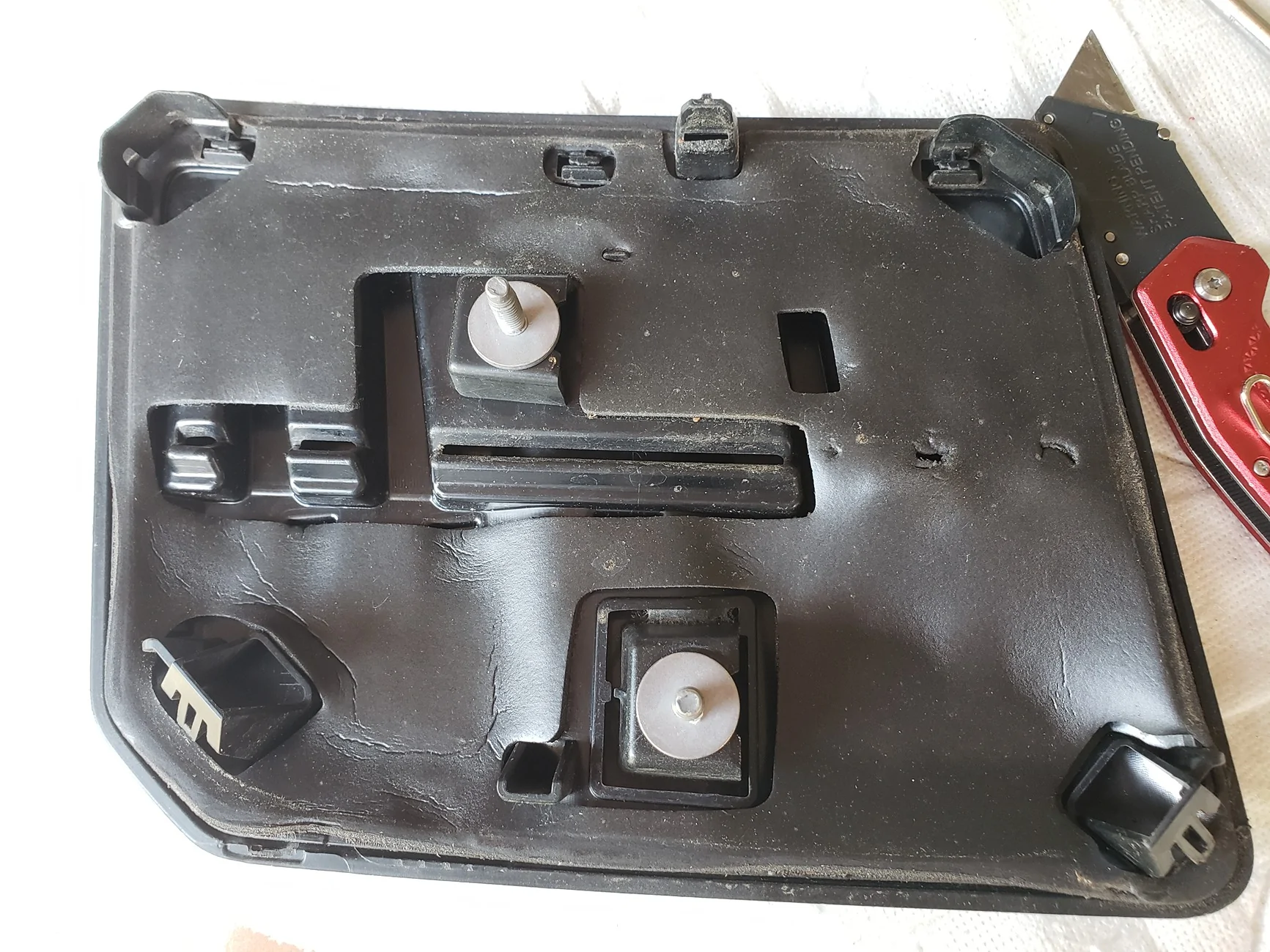

Below is my DS extractor right after removal. I think everyone should pull theirs to at least make sure the slots are all uncovered. Mine weren't, as you can see by the little holes where my blade pushed though.

That same foam piece on mine covered the entire piece. And it was like they pushed down over the screws and it tore around them. The hood liner and then that piece, i guess some heat gets out enough to call it an extractor. Kinda like grass growing through concrete, it finds a way.

Here is the rest of the job. I cut a small section, roughly 2x6", from the hood liner for better draw out of the engine bay. You can sort of see where I hacked off the lower lip of the extractor housing and the additional light that now comes through the openings.
