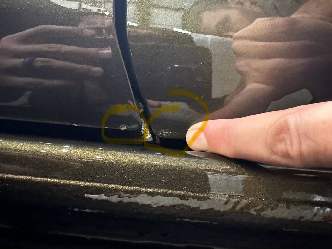

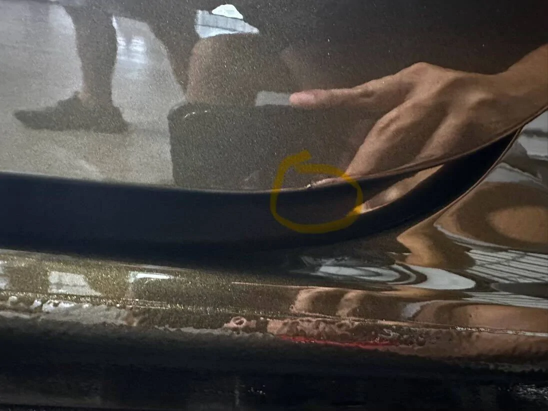

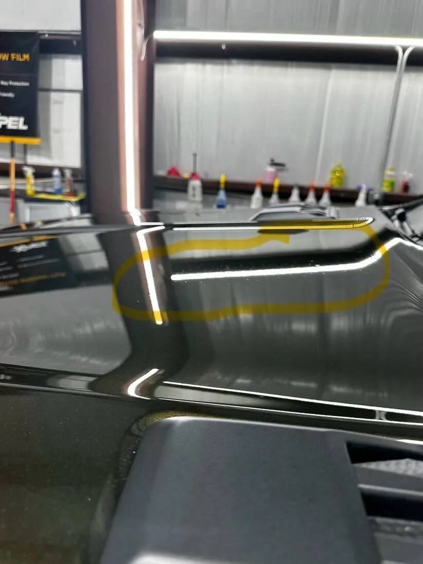

Had my Ranger Raptor a little over a week now, drove it home from the dealer and parked it in my garage, waiting for an appointment for PPF + Ceramic +Tint as I didn't want to risk anything stupid happening in the interim. Drove up to my appointment today and unfortunately, my detailer was going over the truck and pointed out some serious defects in the factory paint.
Truck has just over 100 miles on it now, pretty bummed. Both driver side doors have paint drips on the bottom edges, rear door has it on the front and back of the door.
The hood has some kind of contaminant under the clear coat that can't be polished out, clay bar won't touch it, etc.
The hood is pretty hard to see I guess except under the right light, there were some buffer swirls on the front edge of the hood that I noticed on delivery but I didn't make an issue out of it as I felt my detailer could fix it no problem, so not sure if that was an attempt to remove them at the dealer. Hard to see under direct sunlight.
The door drips I did not see which is on me I guess, I've never seen such a thing and would not think it would be able to leave the factory like that.
I've contacted my salesman and he says the Service Manager will be contacting me; not super thrilled to be looking at not-so-minor paint work on a brand new truck. Drove ~two hours to grab this thing at MSRP and am in disbelief.

A paint depth meter would probably tell a lot. Looks like it was possibly rework post manufacturing.

That's pretty bad man, I really feel for you, I don't get it honestly.
Got a reply back that they are going to "take care of it", but I'm not sure what that means at this point. I'm not too keen on having 1/3 of my brand new truck repainted.

I just went over mine three times last weekend with a clay bar, then with Meguiar's polish to prep for the final step of ceramic coat. In all that detail process, I can honestly say I never thought to check the bottom of the doors for paint runs. It's your truck, and you can obviously do what you want, but I would not be sending mine back to have the doors painted by the local Ford dealer body shop unless I had seen multiple examples of their work blending and finishing dark, metallic paint. Those runs at the bottom of the door may be the least of your worries if they decide to respray both doors and the paint doesn't match.
Now the trash under the clearcoat on the hood is a different story. I would definitely want that redone, and while you still run the same risks of it not blending properly with the rest of the truck, that's an obvious flaw in the factory paint that is much more noticeable and distracting than the runs at the bottom of the doors.

The hood would be the only thing id probably look at. You are gonna do you, but ive owned plenty of cars with thin paint, and you just end up living with it. At the end of the day, the artist (or owner in this case) knows every flaw because its yours, anyone else will never ever see it or notice it.

I really appreciate the feedback fellas.
Spoke to the owner of the detail shop this morning and he told me he'd be able to get the spots out of the hood and fenders with some wet-sanding, they are still working on it but he seemed very confident they'd get them all out; their test spots came out well according to him, so I'm rolling with that for now and can get the PPF slapped on the front at least.
As for the doors, he told me it's probably going to be better to live with it as it'll likely end up worse with anything the dealer wants to do - echoing what you guys are saying. He also told me that since the pandemic, many of the cars he sees have some kind of defect like this, especially Fords, :headbang:
There are few quality bodyshops in the area that I might just stop by and see what they think, but it's probably going to be tilting at windmills.
Still waiting to hear back from the dealer to see what their suggested resolution might be.

Dont be fooled, every brand has issues with paint, its not new to covid pre/after. Look at any car forum and youll see. Fix the hood, have a few beers and enjoy the truck. Once you inevitably get that first door ding this will all seem a no big deal. The shopping carts will find you, they always do!

Finally got the truck back yesterday from the detailer. They put a hell of a lot of work into it and it looks a lot better; there were also spots on the roof.
But those spots caused etching in the clear, so whatever got on it was extremely nasty. They wet sanded the spots on the doors and with the PPF it's much harder to see unless you zero in on it.
Haven't decided if I'm still going to pursue some kind of body shop repair with the dealer, guess I need to spend more time driving it to see if I can see the hood pits from the drivers seat under more varied lighting conditions and let the PPF bake in the sun for a couple days.
