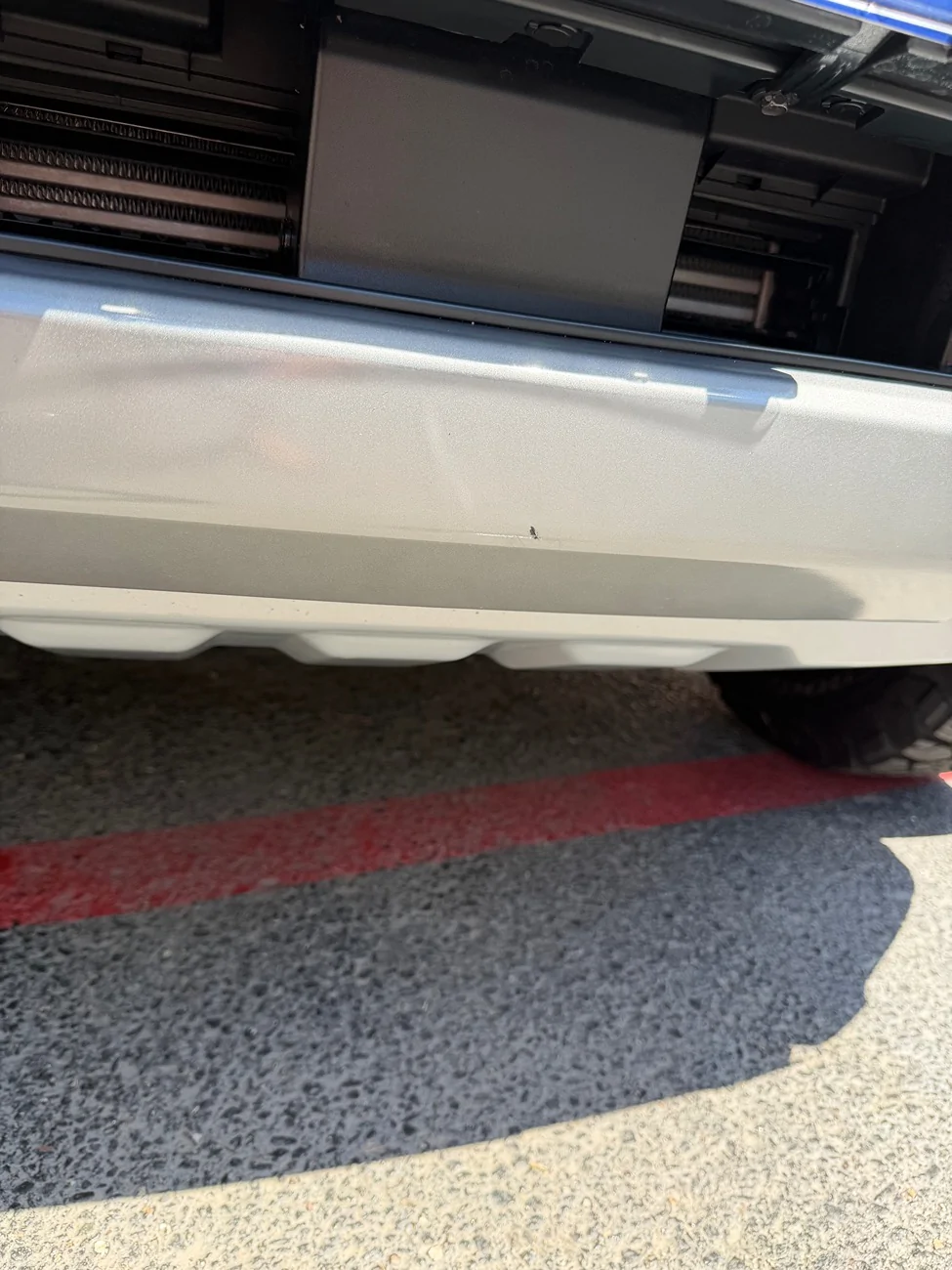

Anyone find a good paint match for the lower bumper in silver?

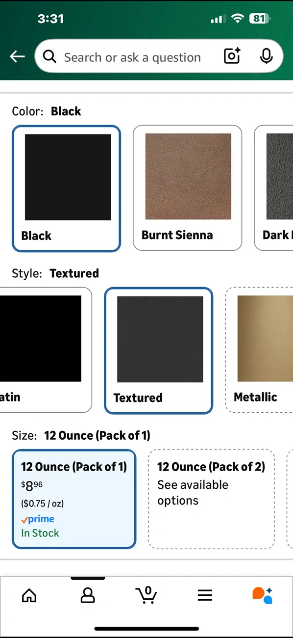

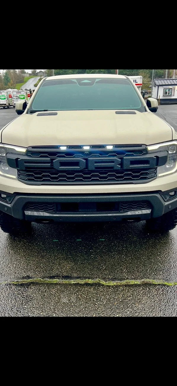

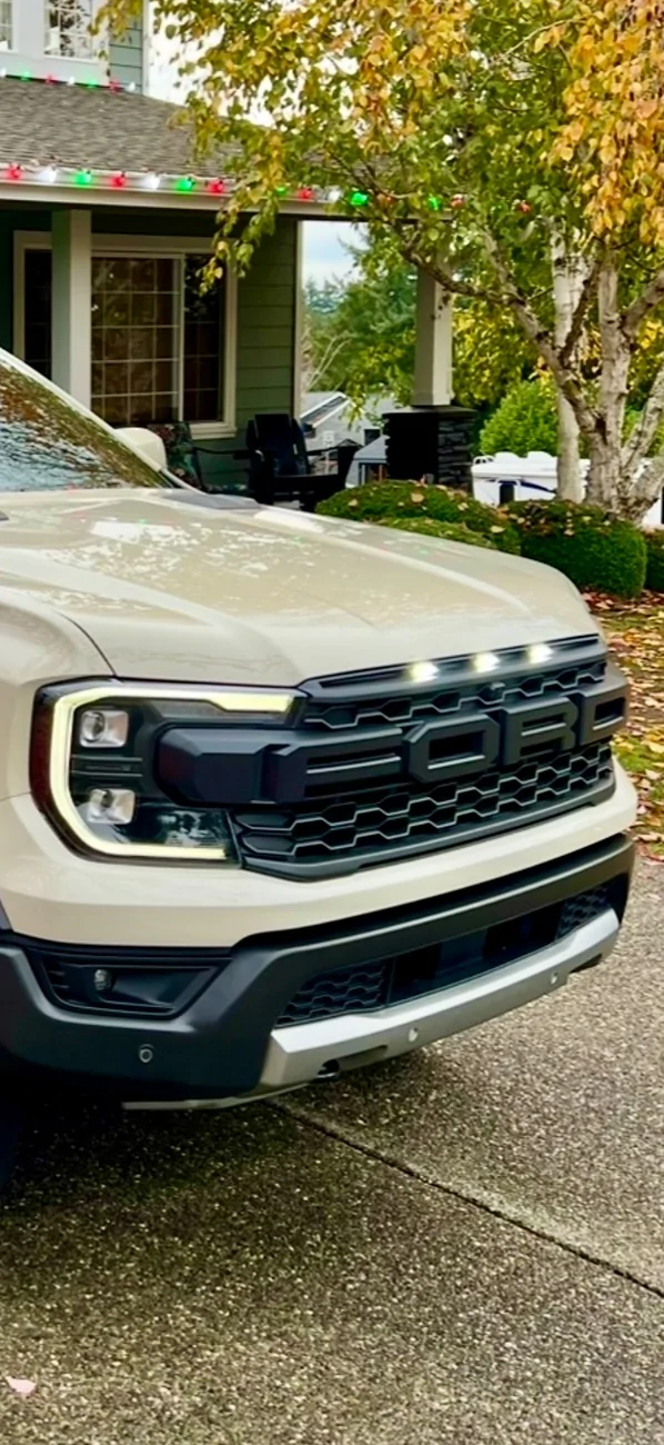

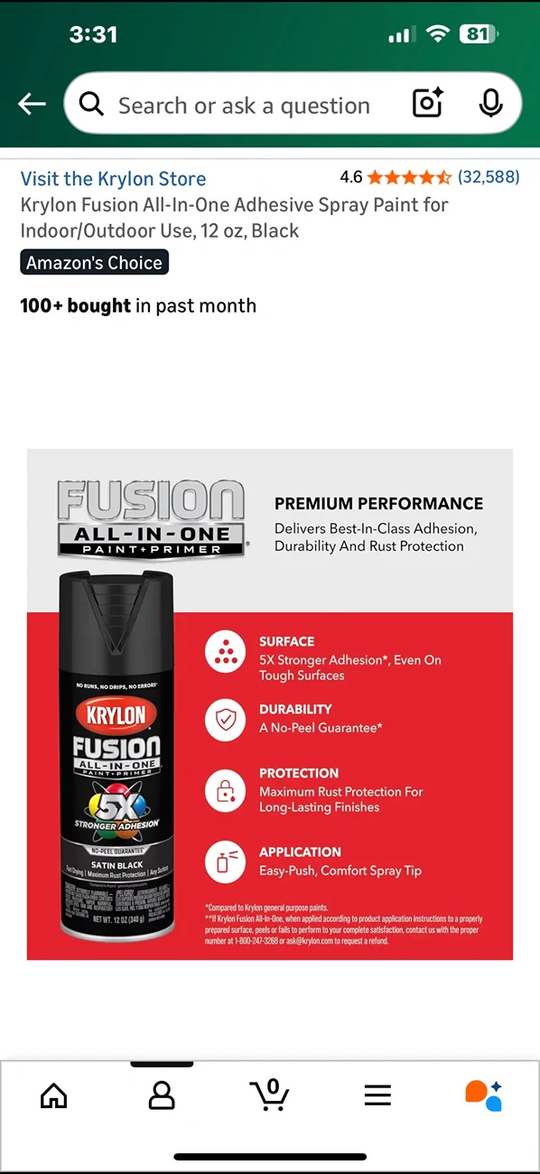

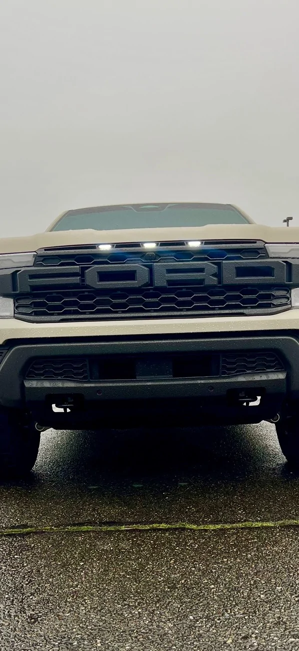

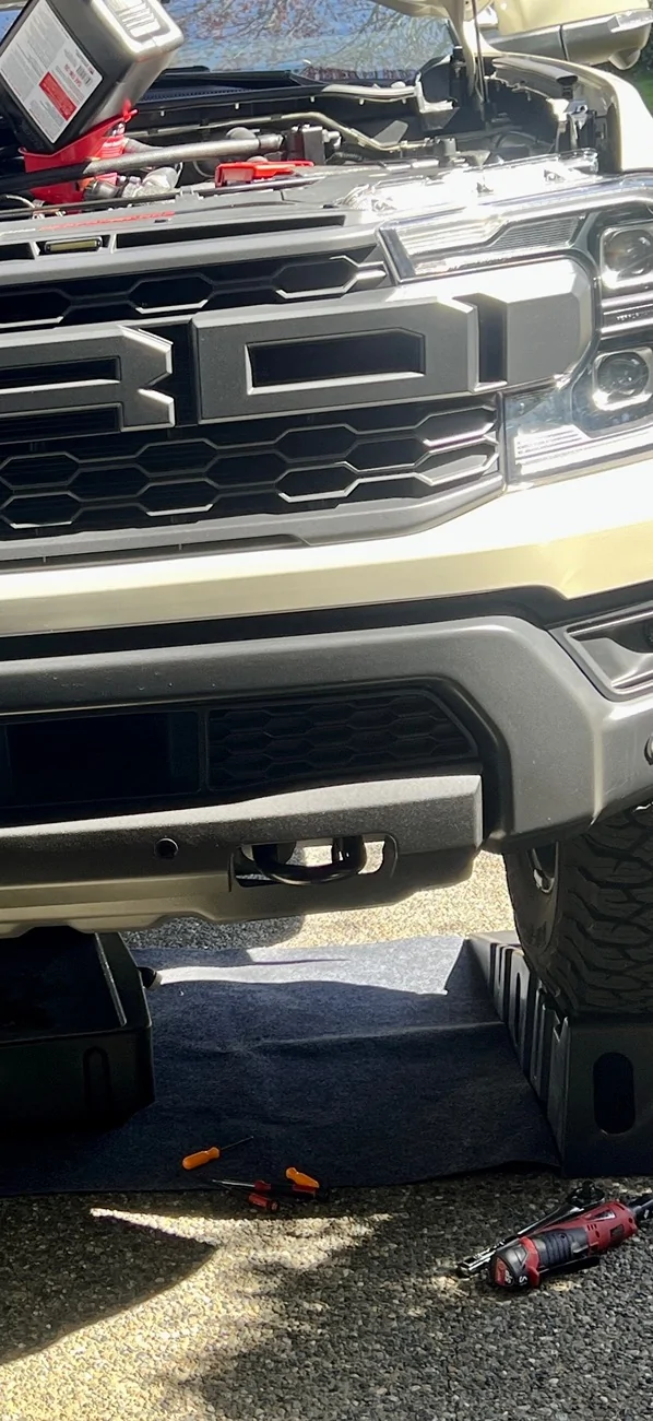

This is what I used. To me it’s a nearly PERFECT match to the gray bumper & trim. Yes the can says black but it’s in the way that the textured variety lays. And the textured isn’t much. You feel it more than you see it. I also did the skid plate in this as well. 6 months later and still looks great.
Scuffed both pieces (off the truck) with scotch brite, degreased, 2 coats adhesion promoter, and 2 coats of the Krylon.
Hope this helps.

I just want to touch it up. Not paint the whole thing.

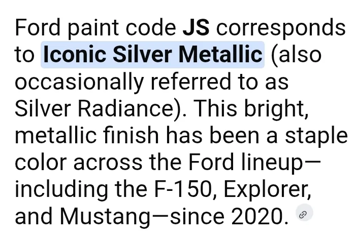

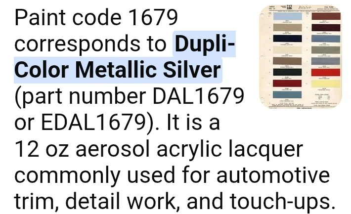

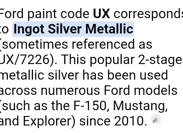

I've got another recent thread on this, and I'll attach the 2 findings I came up with, as well as one more that another owner was told. My dealers body guy, who ran his own shop for a few decades, used a comparison chart and came up with the UX. He had some on hand and have me a few ounces in a touch up bottle. I'll post after I get a chance to use it. Not in a big hurry since it's just a few small scratches around an impact area from a rock, plus I'll be happy even if the match is not perfect.
