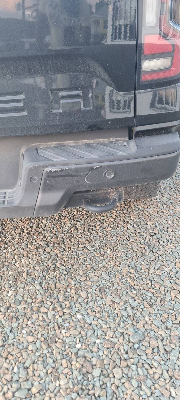

I had a little incident a few days ago which result in the metal bumper piece getting scratched . Rather than replacing it (350usd) what is the paint colour for thus (see attached)

The paint code for your truck is located in the bottom left corner of your door sticker. For instance mine is M7 for the carbonized grey.

Most good paint shops could scan that color on the bumper and get it probably 99% accurate. Also, I’m pretty sure the bumper is the same color as the wheels and I think they are called Dyno Gray

Code JNV
Bolder Gray
Code J7
Magnetic Gray Metallic is very close
Thanks! I could not find JNV anywhere in the states in a can, so I just ordered J7. Cheers!

I was told jnv is only for non US and US is j7. Whether they are the same or not - I don’t know.

Did you ever decide on a color code and did it match?
