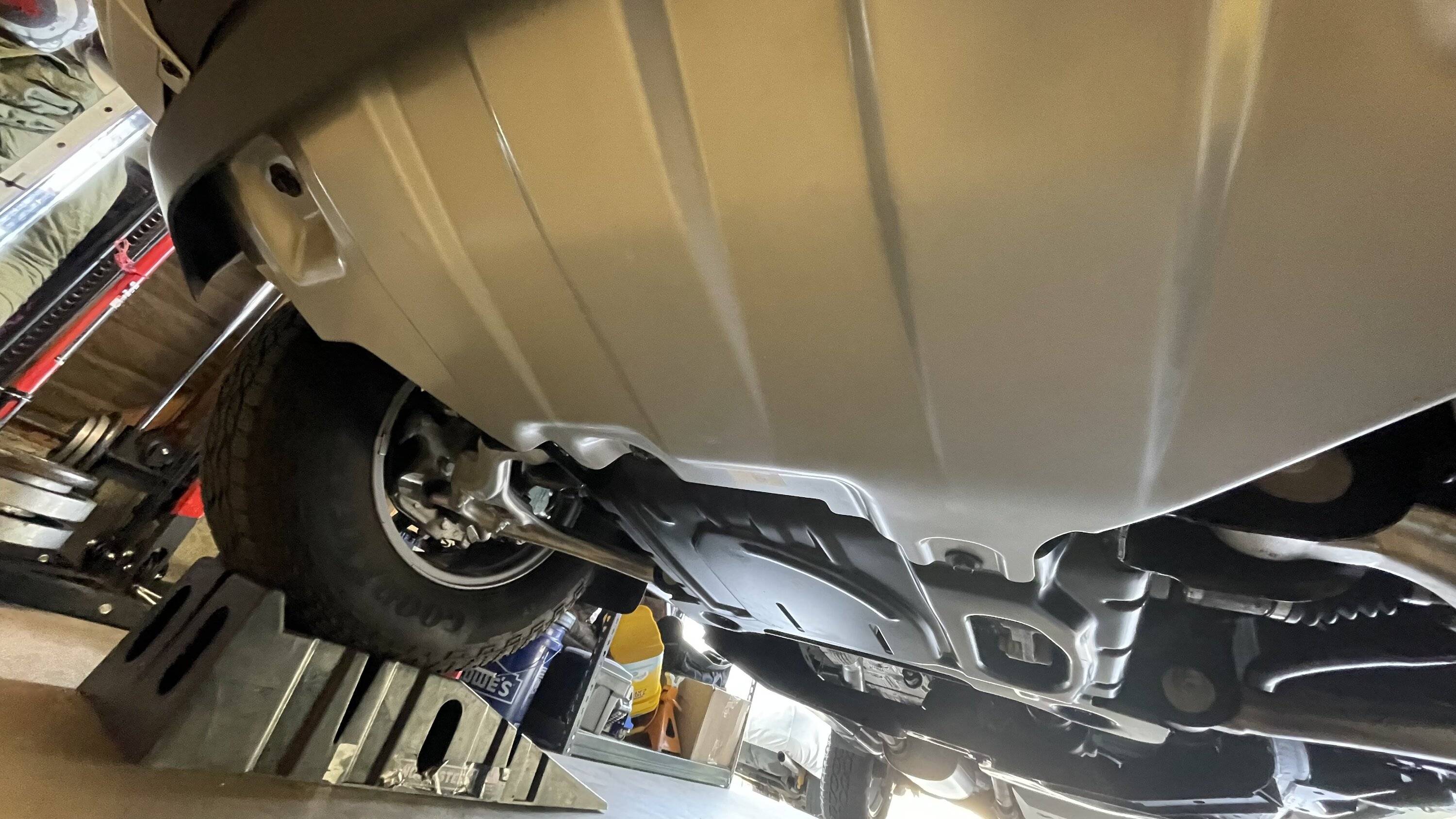

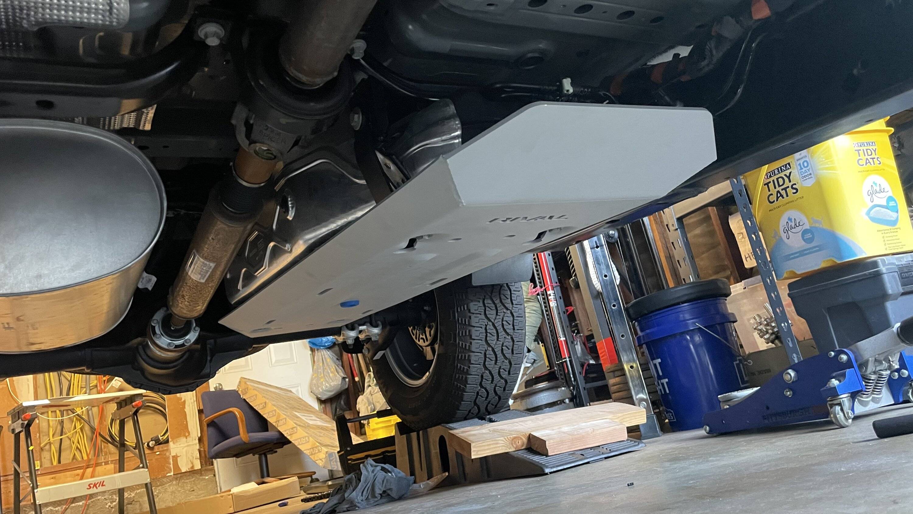

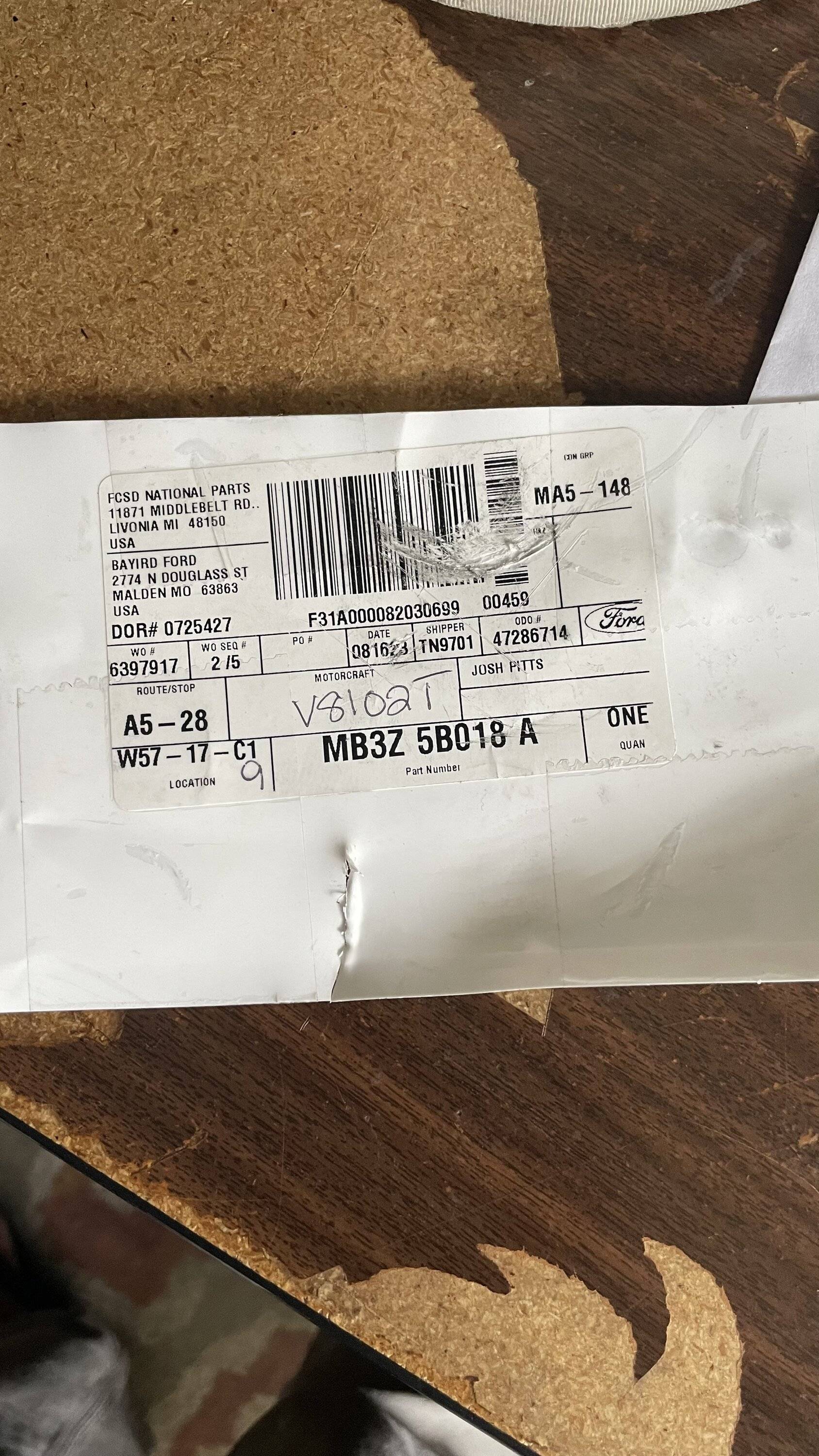

My 4x4 had The plastic package! So, had to do something about it. Installed a Transfer case plate someone here recommended, from the Bronco- Perfect fit. The Front Skid plate is findable on the Ford parts sites, and is a bit pricey, but Ok, It's a must have~ Done.
The Gas Tank is like the Elephant in the room, Ford acts like if you just don't look at it, it won't be a problem. Giant Butter soft whale belly tank hanging low- But hey- Here's a 2nd butter soft plastic layer- slice right through those pesky jagged rocks! So @RIVAL 4x4 fixed that.
2nd to last stop was the Engine plate, pretty cheap, but could not find the Ranger number after much looking, decided the go with the Bronco one, and Yep- Fits like a Glove.
Going to probably get a E-Bay one for the Trans, that Plastic pan is just waiting for a branch.

I'm getting the whole Rival set when they're available. Did you take the stock gas tank cover off ? And if you did, do you have to take it off ?
RangerDangerStranger
Chris
Mar 14, 2020
474
469
SF Bay Area
2024 XLT 4x4 in GreyBlue.
Cool Dude
From Rival you do not need to remove it. I did before it was clarified, doesn't matter though, usless piece
