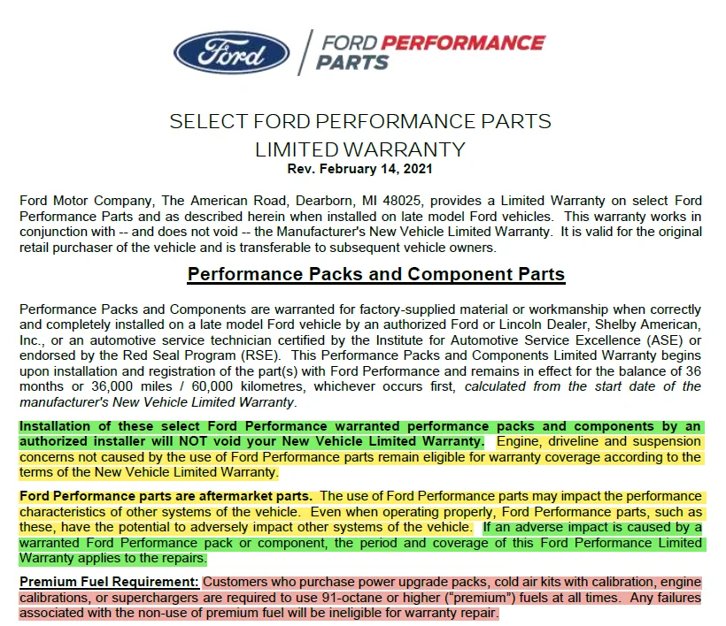

You do know that the warranty info explicitly states if you run fuel below 91 RON with the Pro Cal you void your warranty, right? There's a reason for that!
Factory cal, sure, 87 is fine, it will just lose a lot of power / torque but it's not going to damage anything. Pro Cal, you're giving up low octane period. Sure, you could try to drive it conservatively on 87 to get to a station to re-fill, but all it takes if for you to forget one time and do a pull on a Pro Cal tuned RR running on 87....
Octane boosters with 87 are less sketchy than straight 87, but I still wouldn't risk it and if you can only find 87 in a lot of areas you drive I'd just keep it stock. For me, I've yet to run across a station that doesn't at least have 91 in the states I've driven and just in case my Pro Cal is in the upper glove box so I could flash back to stock if needed.

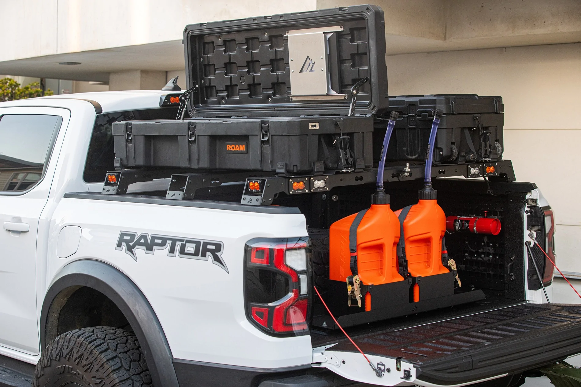

I'd imagine route planning can also go a LONG way! Garmin GPS, google maps etc. Heck, you could carry 3-4 five-gallon fuel cans if you're going very remote. It all depends. The Ranger Raptor Race truck used a 35-gallon tank, so three five-gallon jugs plus the 20 gallons in the tank and you'll get about 600 miles.

To the ranters - all I can say is that I went straight to Ford Performance. The document above is from 2021 and we spoke to them in 2025 due to fuel concerns in a pinch. We carry 10 gallons of extra fuel and still run out of gas many days. We also carry Octane Boost but will sometimes share it and so yes, we occassionally run out of it as well and had legitimate concerns.
FP Engineers are well aware of both my build and driving habits that are far beyond what most people will ever do (including a current upgrade to long-travel rear and mid-travel front). Their feedback was that there is "paper" advice and then "practical" advice and don't sweat it if it happens once in awhile (unlike when an "aquaintance" stupidly put 85 in his rig in Utah and the engine flat-out quit). So yes, this was a detailed discussion.
