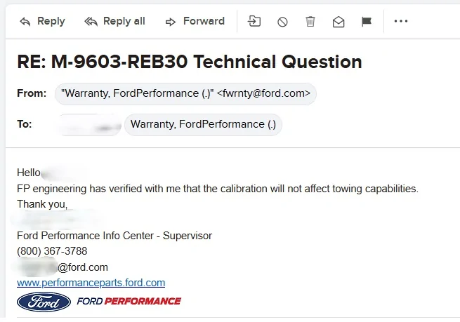

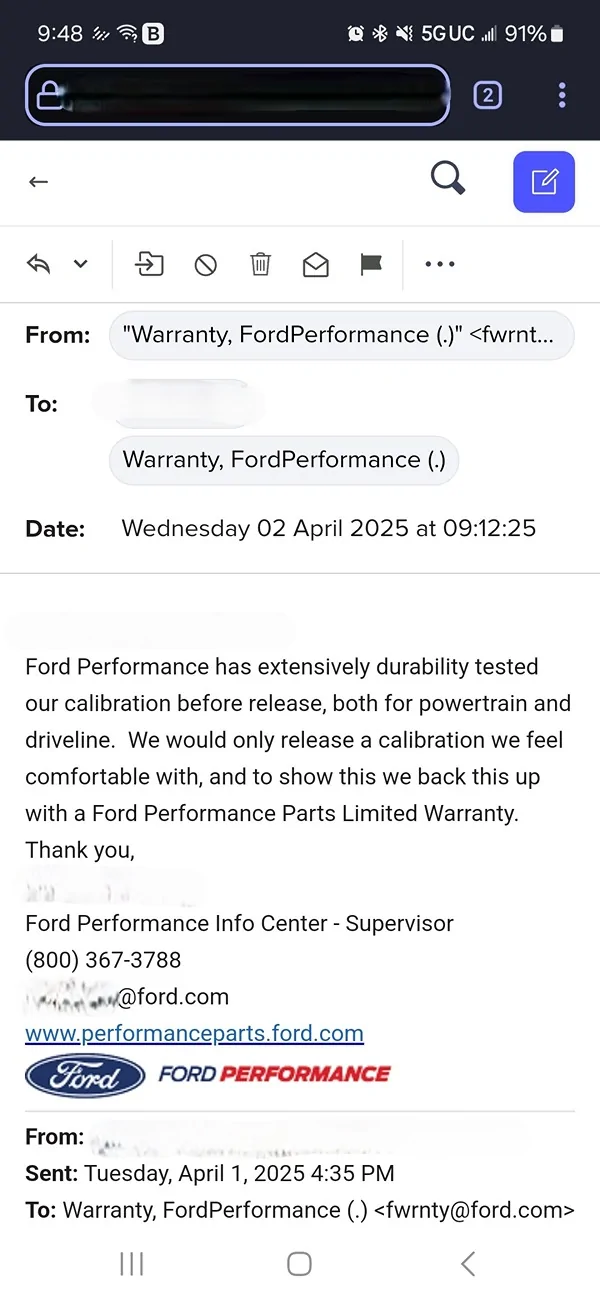

Note that with the Pro Cal you MUST run 91 or higher octane, if you run anything below 91 you risk damage since the timing profiles ASSUME minimum of 91 RON rating. You WILL void your warranty if you run the Pro Cal tuned raptor on anything below 91. Higher is ok, so 92~93 octane is even better, especially in hot weather, altitude, hot lapping and towing.
And yes, you still have FULL 5,510 lbs tow rating with the Pro Cal, it does not affect the trucks towing ability which I have directly confirmed with Ford Performance and posted on other threads.
Ford Ranger Post procal tune tips M-9603-REB30_Towing_Capability
Ford Ranger Post procal tune tips Screenshot_20250402_094807_Startpag
