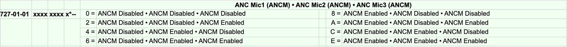

Can anyone confirm whether or not the faux exhaust noise exists in non Raptor Rangers (XLT)? About to install a subwoofer and hoping this doesn't open another can of worms.
This will probably work
Would you mind translating this for someone who is a first time Forscan user? I think ANC means noise cancelling, is that the same as the enhanced engine noise or can you leave the ANC on with enhanced engine noise off?
Setting 0 (zero) where the * is will disable all 3 mics for the Active Noise Control.
Other threads said it was the digit before the * for enhanced engine noise. Could it be the * is a digit for noise cancelling and the digit before is for enhanced engine noise? Wish there was a definitive answer here before I homebrew a mess.
