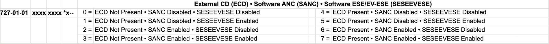

First, always backup / save your current / factory settings then compare with the spreadsheet (screenshot below) and reduce by one the * digit to disable.
eg.
My as built ACM, 727-01-01 was A8FF D4FE 10B9 meaning software ESE was enabled
I changed this to A8FF D4FE 00B9 to disable it.
Ford Ranger Ranger Raptor - Exhaust noise through speakers? Screenshot 2025-05-22 at 09.16.22

I'm a bit late to this thread, but I can confirm that my Aus-specced 2022 3l V6 Raptor shipped with exhaust enhancement enabled, i.e. fake engine noise piped through the speakers, despite what you might have read elsewhere.
How do I know? Aftermarket speaker and amp audio system upgrade. Select Baja exhaust mode and the noise was (subjectively) more than twice as loud as before, obnoxiously so.
I used an OBD2 USB connector with Forscan, altered the appropriate code, test drove, and the noise reverted to slightly quieter than stock.
If you're looking to do the same, what worked for me was:
ACM As built
727-01-01
Stock: ****-****-1***
Change to: ****-****-0***
