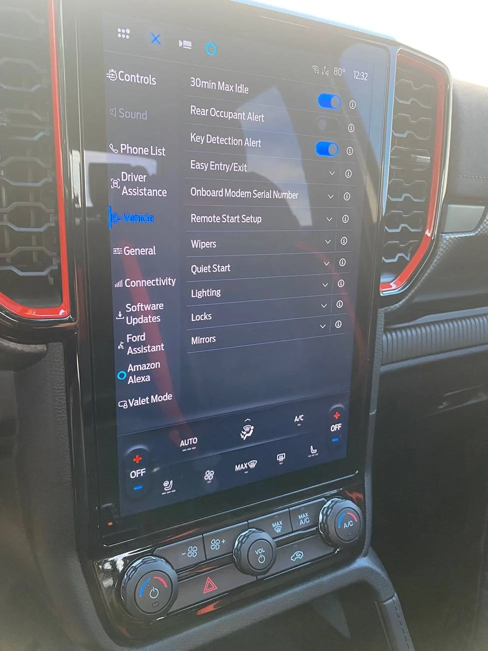

I don’t have anything in “Lighting” or in Zone lighting to enable it??‍♂
When you expand the lighting section what do you have as options? I'm not by my truck to check at the moment.

It might also be under the General Tab. I know that's where some of the interior lighting settings are.

I attached another photo of the Lighting options.

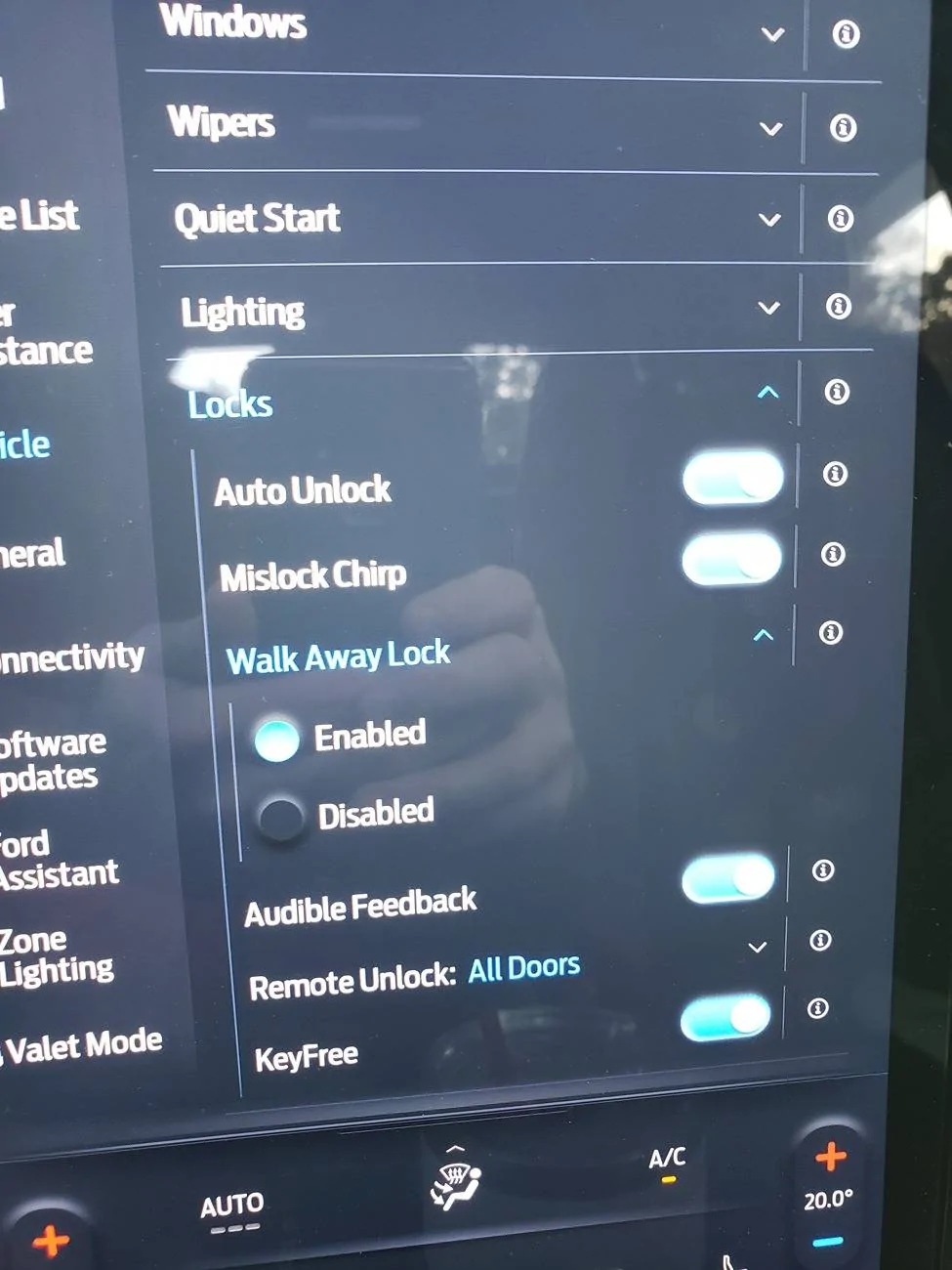

Hey boys! Look what I got here.
Hey, where the Walk Away Lock at?!??
Ford Ranger Ranger RAPTOR V6 FORScan spreadsheet? 20240910_170910
I have no idea what I changed to turn this on, but it doesn't work yet (automatically disables itself). Since I conveniently disabled my steering wheel controls farting around in FORscan, I'm going to reset the truck back to factory and figure out how I turned this on as well as whatever the mysterious "A-seat" button I turned on under the heated seats menu is and does (it too automatically shuts off).
Edit: reset SCCM module and that fixed the steering wheel buttons. Still can't figure out walk away locks, but somehow managed to disable Audible Feedback. I'm stopping for now so I don't break anything.
Oh, seatbelt warning light (little red icon) was turned back on with setting Row 1 Col 1 and R1C5 to Fixed with Belt Minder. I can't remember what positions/settings are used for the back seats. Chimes and okay box are still disabled, which is nice.
