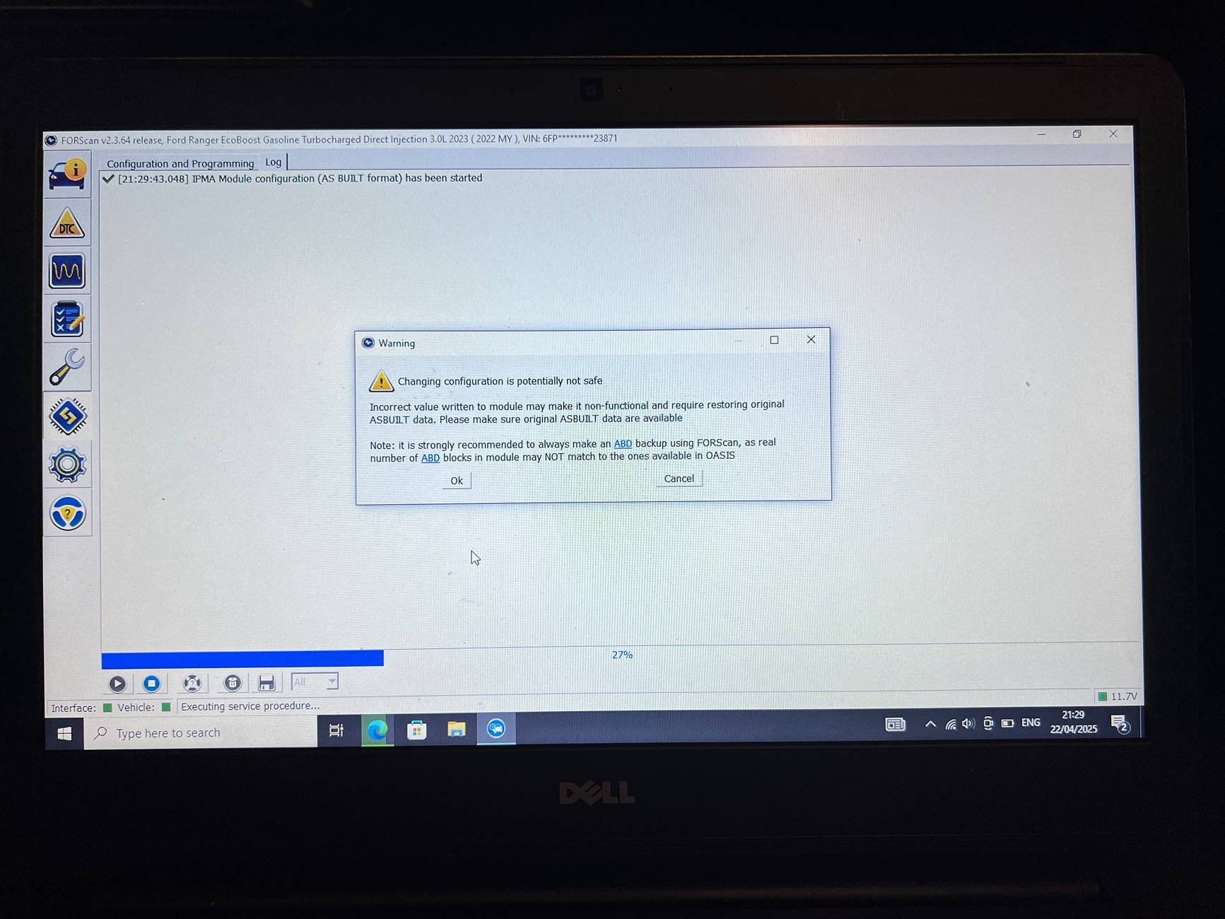

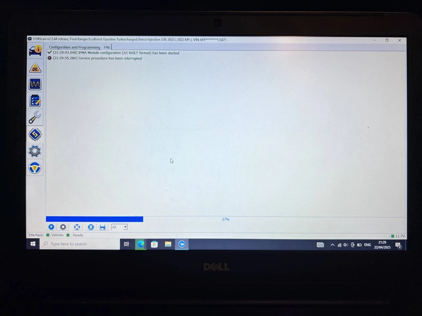

Having some issues with getting into the As Built on the IPMA Module, so I can stop the Lane Keep Assist activating everytime I turn it on!
However, I’ve tried 2 versions of Forscan in 2 different laptops and once it reads to 27%, it pops up with the “make copy of the settings bla bla bla”, but then says service procedure was interrupted???
any ideas? Could be the OBD lead? Thoughts?
I am currently in FORScan and was able to successfully initiate the programming for IPMA using AS-Built. I didn't change anything but it did let me know get to the hex values. I am running the latest FORScan version v2.3.65 on a 2025 RR (North America). FORScan does recommend removing your vehicle profile after upgrading versions if you haven't done that. I didn't know this until recently.
https://forscan.org/forum/viewtopic.php?f=5&t=9196
Hope this helps.
Hope this helps.
thanks, I’ll give that a try later - wondering if I should get a new OBD lead as well as mine is pretty old now? Any recommendations?
