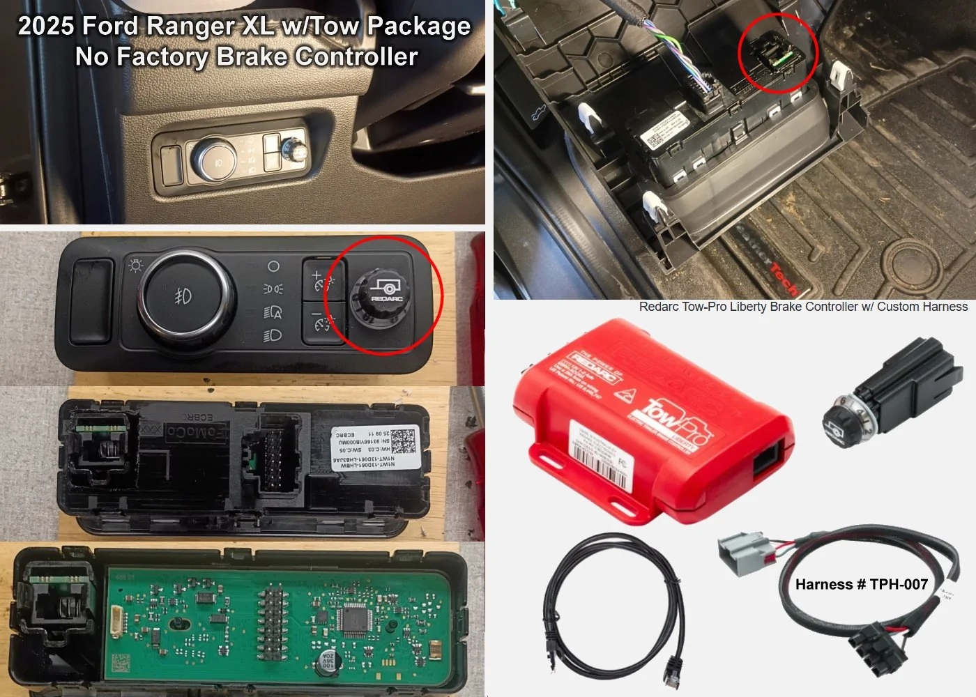

Installed the Redarc "Liberty" brake controller today in my '25 XL with the tow package (no factory brake controller).
Found a good spot for the control dial. It fits right in the right side of the housing for the lighting controls. You have to cut the excess plastic out of that area to access the front and cut a piece out of the back for the control to stick out. Still I think it looks better that just drilling and sticking it in the panel somewhere.

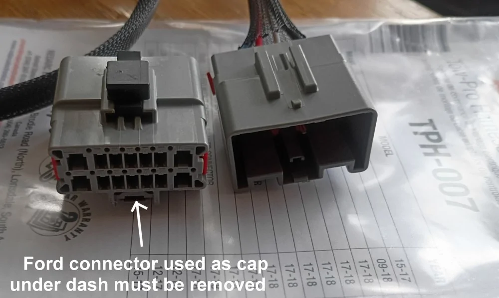

Remember there might be an empty connector stuck in the factory harness under the dash that has to be removed for the Redarc harness to fit.
