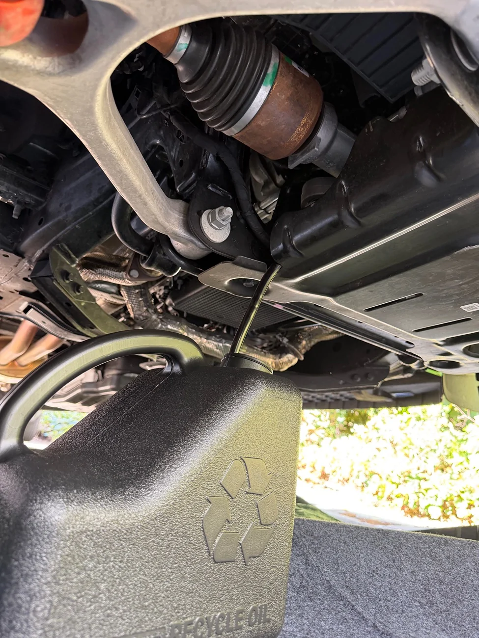

Yup loved my Fumotos but obviously they won't work on these plastic oil pans. That is what made me like the UPR.
As @josephp732 said, I think I should just wait until I get the truck and can crawl around under it and see which will be best. I'll eventually report back come Aug!
lib
Dec 14, 2025
CA
Remove the skid plate on your first oil change and install a Ronin drain plug. After that you can thread a hose onto the drain without removing the skid plate.
Ford Ranger Removing splash guard for oil changes IMG_5492
