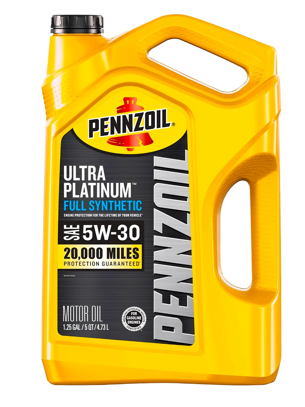

My preference is Pennzoil Ultra Platinum. It uses a very robust additives package and it's natural gas derived base oil provides really good shear stability and resistance to fuel dilution, both of which are critical for protecting the engine’s wet belt. Highly boosted, direct-injectioned engines like the 2.7 EcoBoost naturally suffer from raw fuel washing into the crankcase. Because of this it's a good idea to use an oil that's formulated to resist thinning and maintain it's viscosity when exposed to small amounts of raw fuel over time. This helps prevent the rubber belt from breaking down prematurely. It also meets Ford's WSS-M2C961-A1 specification.
That being said, there are a lot of good oils out there and while some synthetic oils are better formulated than others, as long as the oil meets Ford's WSS-M2C961-A1 specification the bigger factor at play is your mileage / time interval in between oil changes rather than the oil itself.

Pennzoil Ultra Platinum 5W-30 in the 2.7. Pennzoil Platinum Euro 5W-40 in the 5.0. I've used this oil for many years with excellent results.
I recently stocked up on Mobil 1 ESP 0W-30. This is also a very good oil with an ester base stock and a robust additive package.

Another vote for Penzoil Ultra full synthetic, I've seen two tests where it came out at the top of the pile, one by the Oil Geek and another by an independent tester.

This is good information! What isn’t mentioned are Group III bases, perhaps because they’re technically not synthetic like PAO or Ester bases, but can be refined to the point of being called “synthetic” (at least here in the US, where synthetic has largely been reduced to a marketing term). Group III are cheaper, have additive compatibility similar to the PAO’s, but lack the chemical stability of true synthetics. A very popular Group III oil is Pennzoil “synthetic”.
