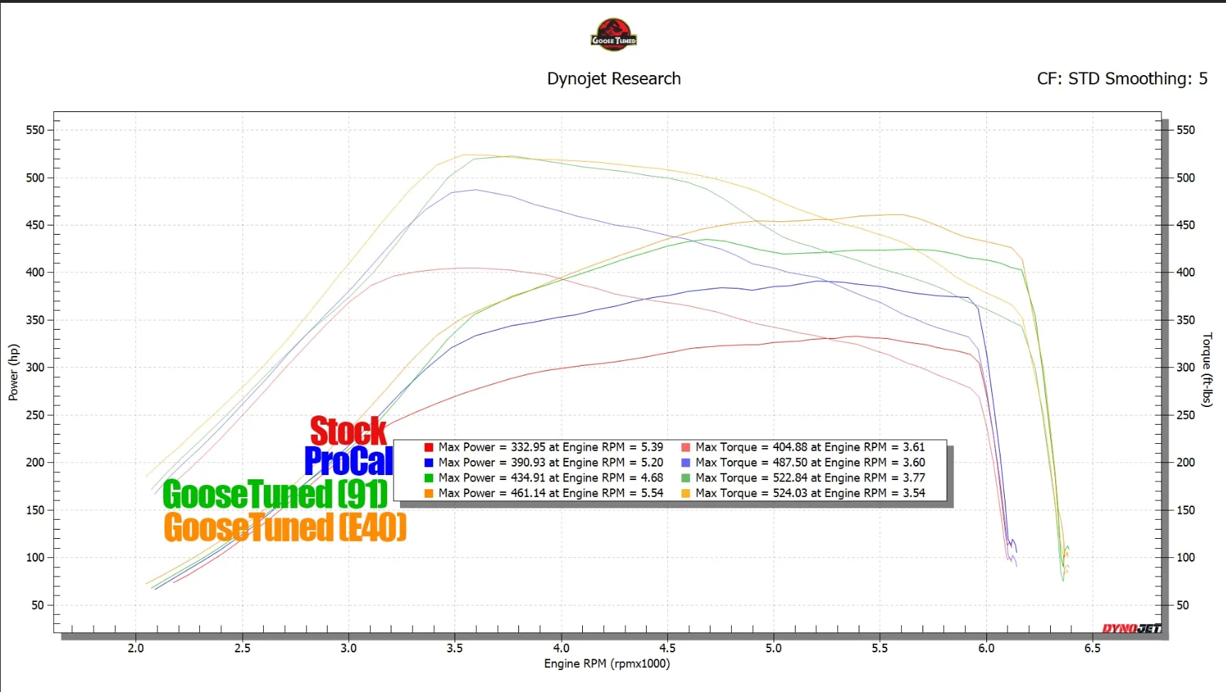

Was just curious what people have set the shift point and buzzer to when using the manual shift? I did notice a slight lag so would 5,900 be a good spot?

I suppose if you were racing... but I have mine set quite a bit lower. I think 4,800?

My recommendation based on the the dyno charts I've seen, would be to shift at 5500rpm where peak power is made.
Unless you need to run out RPM for a 1/4mi pass or something like that, 5500rpm is your best bet
Winfield from GooseTuned, knows his stuff.

awesome that's exactly what I wanted to know
