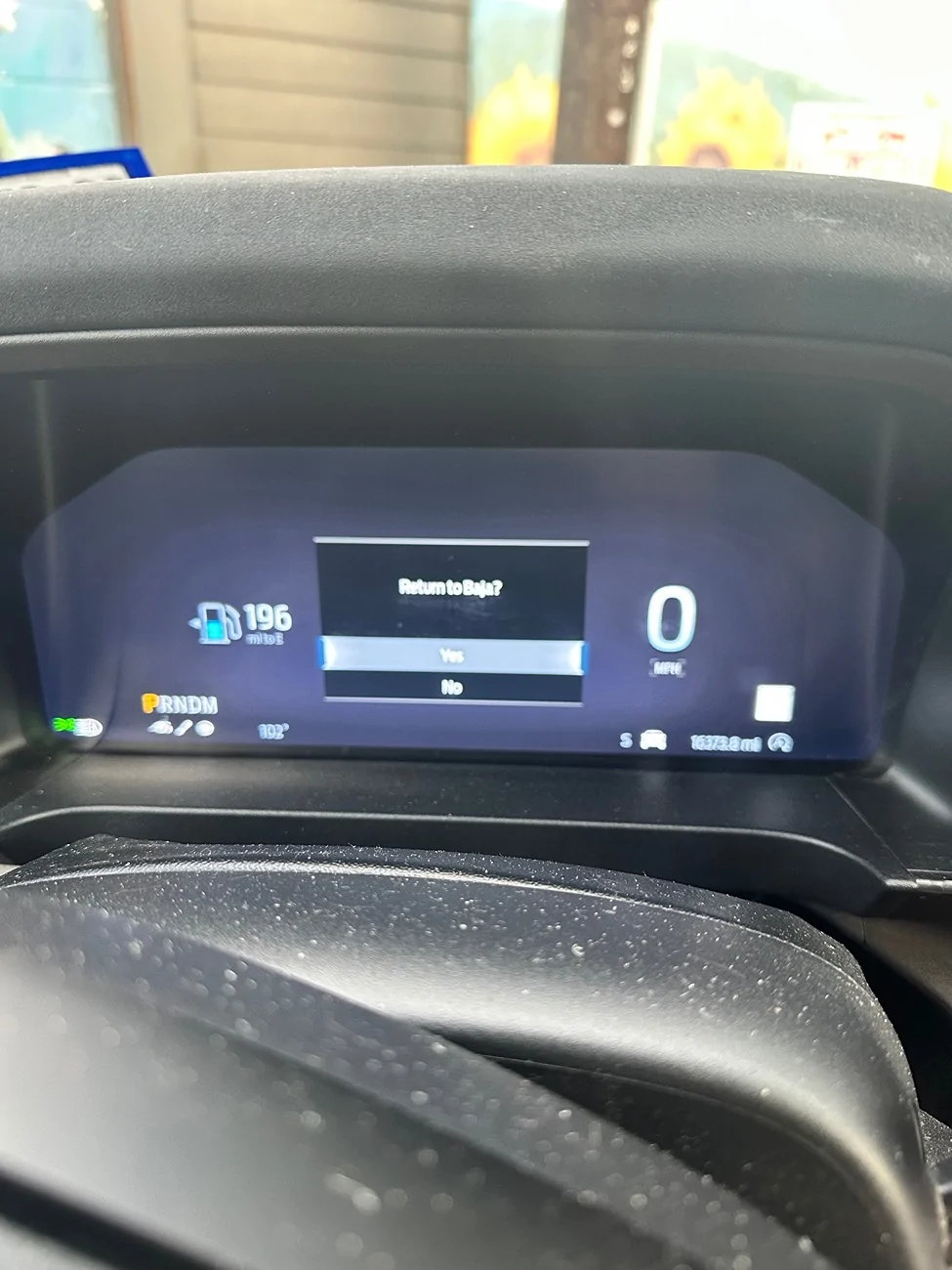

Randomly switches into Baja mode and into 4WD
stock RR
I always run in Raptor mode where the saved drive mode is Normal
several times, randomly, and typically when I slow down to turn or start off and turn….the truck suddenly, on it’s own, switches into Baja mode and from 2WD into 4WD
it did it yesterday when I took off at a light and took a left turn and I accelerated hard on a 4 lane highway to get around a gravel truck
suddenly I hear the truck rev up and look at the dashboard and it’s in 4WD Baja mode
I have to pull over, it won’t go into 2H.
Ultimately, I have to turn the truck off and back on for it switch to 2H
later, after eating dinner and all city driving, I turn the truck on and immediately see this on the dashboard
it asks me if I want to stay in Baja mode
we were in drive mode Normal when we stopped for dinner
anyone have a similar experience ?

This happened several times on my Ranger Lariat FX4. They traced it back to the ATCM module. They had to replace it. Haven't had any issues since.

My 24 Lariat FX4 did it all the time. First time to dealer they couldn’t find a problem and said they had never heard of a problem. The second time just before I ran out of warranty I took it in again (recall) and told them I thought it was the mode selector. They checked it again and said that was the problem. They replaced it and it was worse. Took it back again and they got with Ford and they hadn’t installed the updated switch. They installed the updated selector and everything worked perfectly. Drove it about a 1000 miles and traded it in for a RR.
