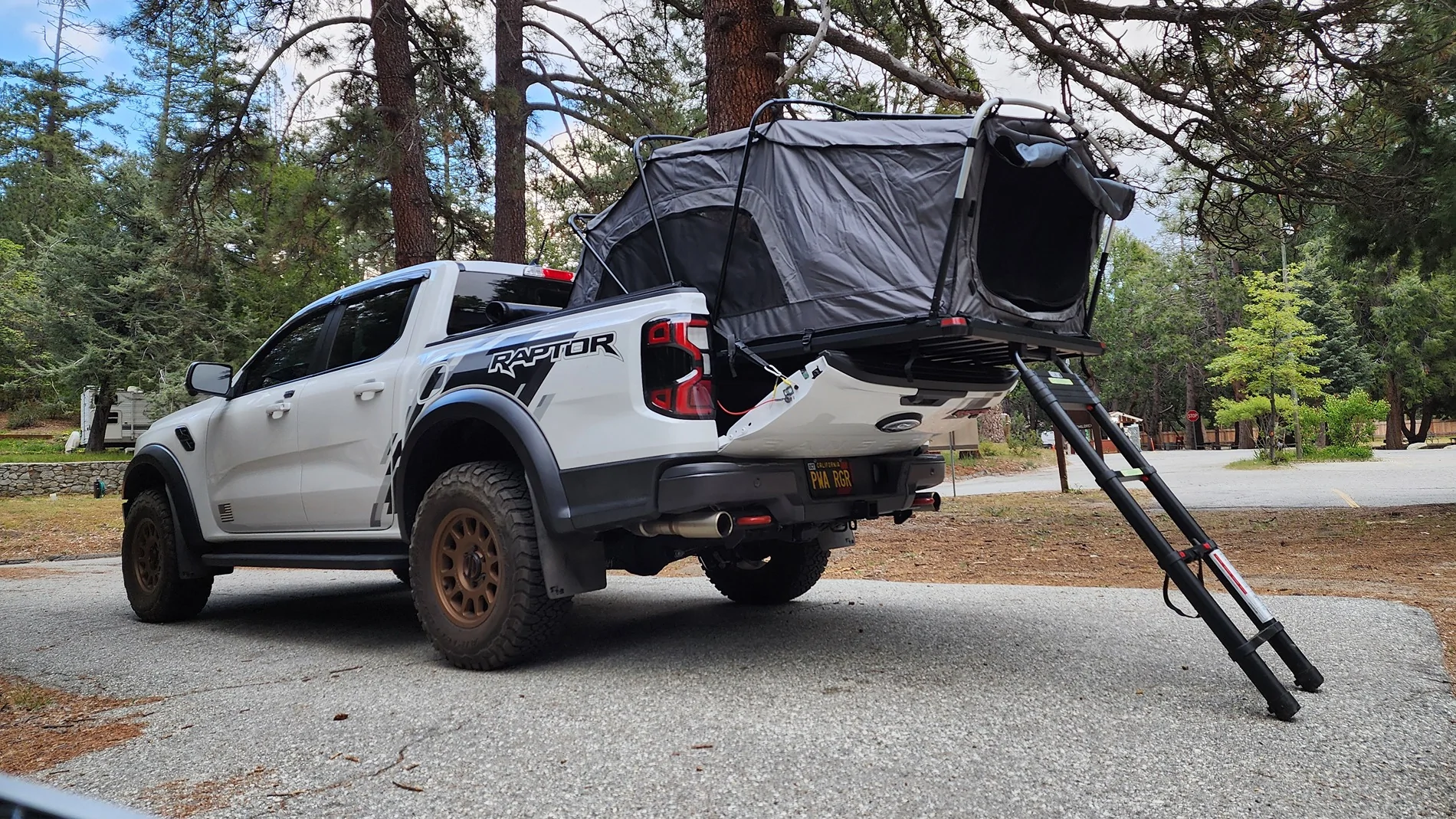

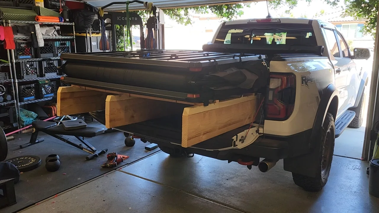

Hey guys wanted to share my Stealth Camper setup:
Just saw this clean maverick running a similar RTT setup, and it got me thinking about the benefits of keeping things low and smart. Instead of building a skyscraper on the truck with a go-fast camper, I keep mine folded flat in the bed under a tonneau cover. Don’t get me wrong, it looks cool… but I’m really happy I went a different route with my iLander tent.
Big advantages:
  • Stock height = way better aerodynamics and fuel economy
  • Lower center of gravity for confident handling, especially off-road
  • Fits in my garage without drama
  • Tent stays clean, dry under the tonneau, and secure when not in use
  • No wind noise or swaying at highway speeds
  • 5 minute setup but zero daily visibility
The truck still looks factory and mean, but I don’t have to live with the compromises of a permanent rooftop castle.

Neat idea!
I think I would make it so the wood supports would slide out like drawer slides and support the weight over the tail gate.
vice using webbing to support a half closed tail gate.

There's more than enough room for all the gear, my wife, our 70 lb dog, and me.
There are some compromises, but if I cared about carrying more "stuff," I'd get a full-size truck.

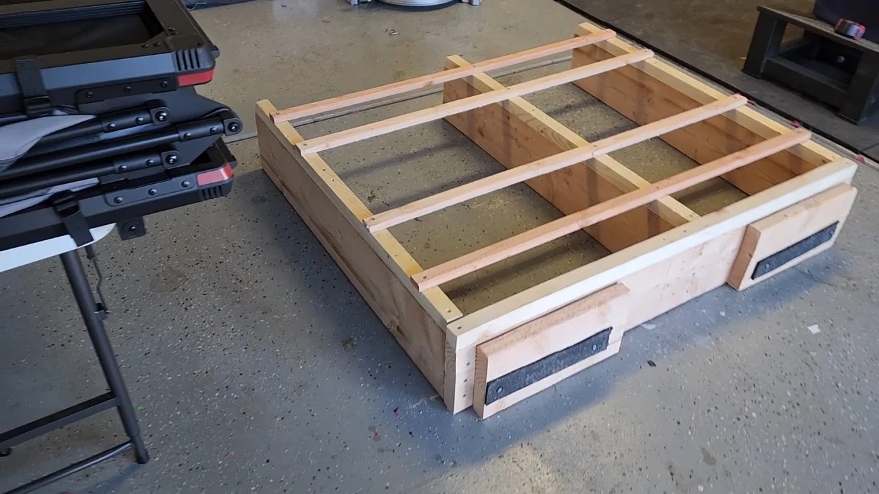

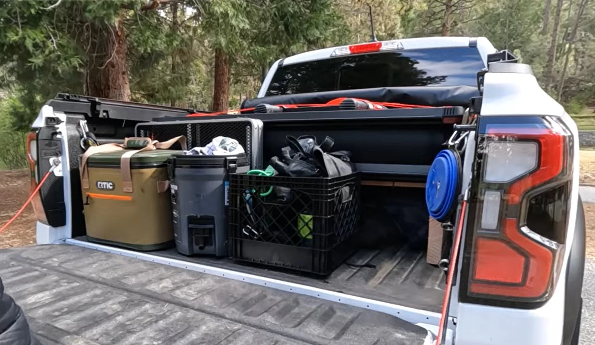

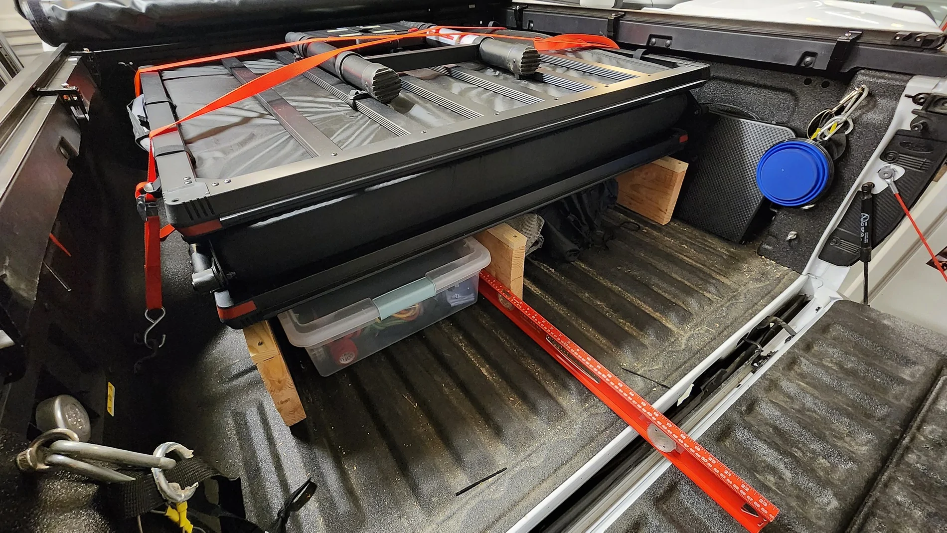

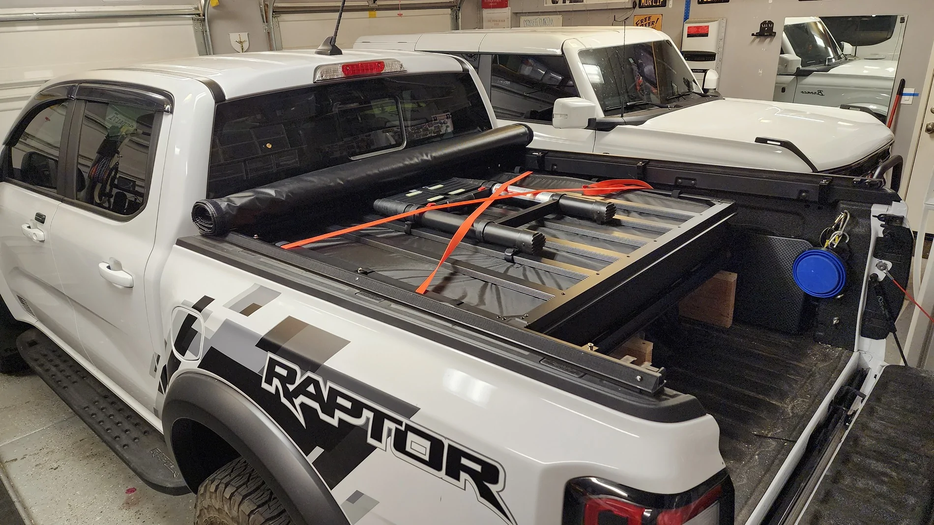

Here are some images of the build. There is also a decent amount of information in the video I linked. The platform under the tent measures 43" x 48" x 9.5". I use a simple soft roll-up tonneau cover from Mostplus. Under the tent, I have a large storage tote that measures 40" x 20" x 7", along with two chairs, a table, and a fire pit. In front of the tent, there is approximately 60" x 16" x 20" of additional storage space.

This is awesome, and it looks like there's additional space towards the tailgate for a cooler and some bigger boxy items. Love it
There's quite a bit of room; you can store enough supplies for a few days out in the sticks
