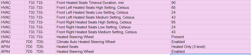

I found temp settings for heated seats, but the only thing I found for the steering wheel is below. Maybe there is a "hidden" asbuilt setting, but I could not find one in the drop down menu settings. I suspect the heater in the wheel is a simple relay and not intelligently controlled.
There is a temp setting for the steering wheel somewhere as well. Btw, has anyone adjusted the seat temps? I'd like 3 a bit cooler and 1 a bit warmer, but it's not cold enough here yet to test it.

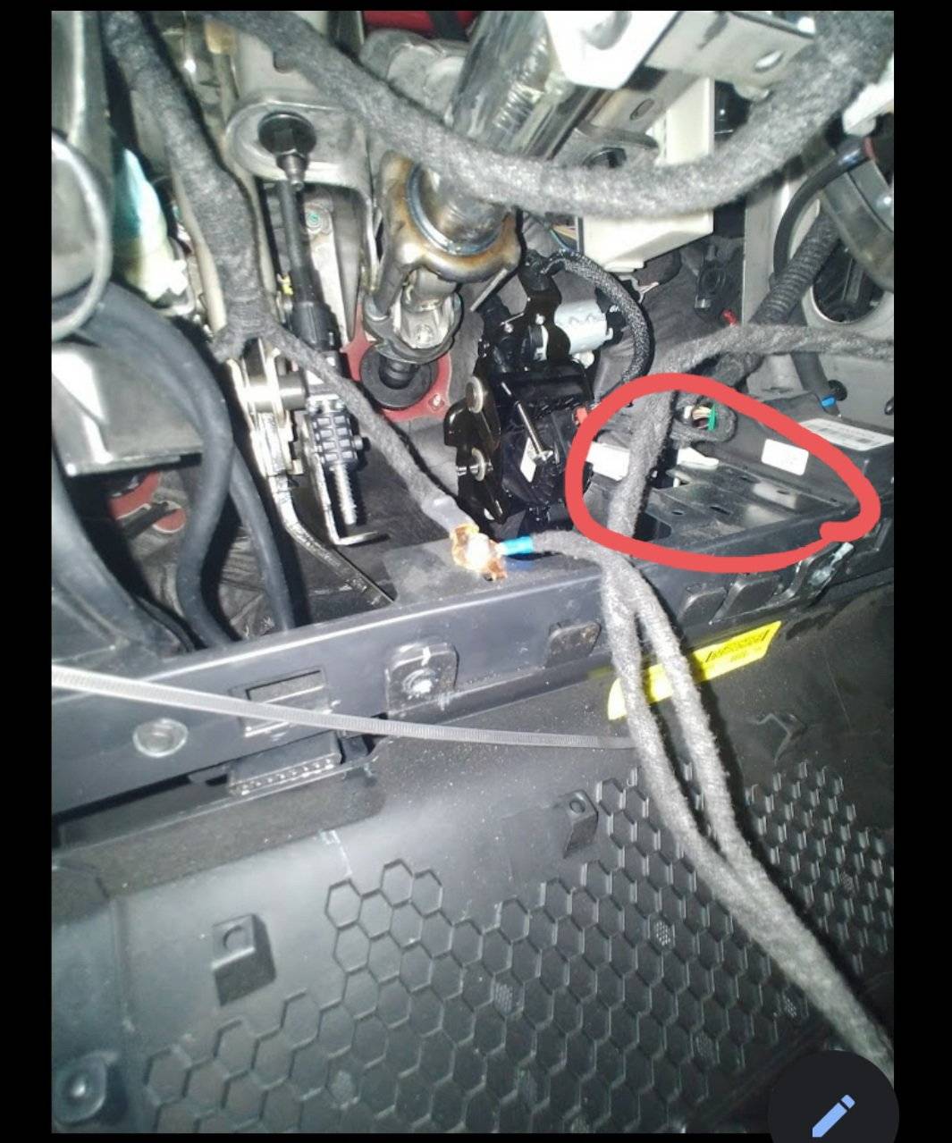

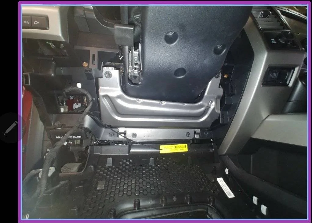

Apparently the heated steering wheel module is not in the wheel itself (in a F-150), but here:
The module is located behind the knee panel on the driver side behind the metal plate.
Ford Ranger Steering Wheel Heat Power? 0049_docs_db1e8f5ab0d86529755d73666ed09ad3ebf6cf13
Ford Ranger Steering Wheel Heat Power? 13_125933_b0f944847e45be1381069498dd3f1bd17ee2ba77
The hswm is located in the area with the red circle is. The module in the picture is the spotlight module but the heated steering wheel module is located right next to it.

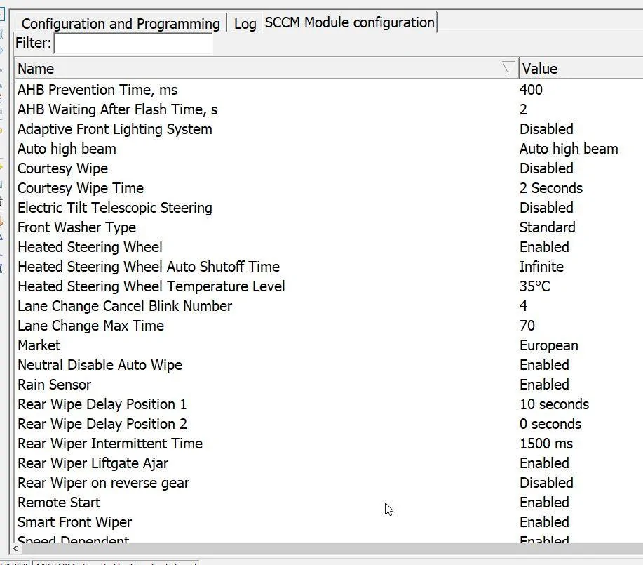

Oh no! I thought that I posted this last night but never hit submit!!
Well shoot, I guess when i first started recording the ForScan settings, I never checked SCCM Module! Here it is!

I can confirm this works, maximum temperature is 39°C and works much better at that temp. Thank you for your assistance.
